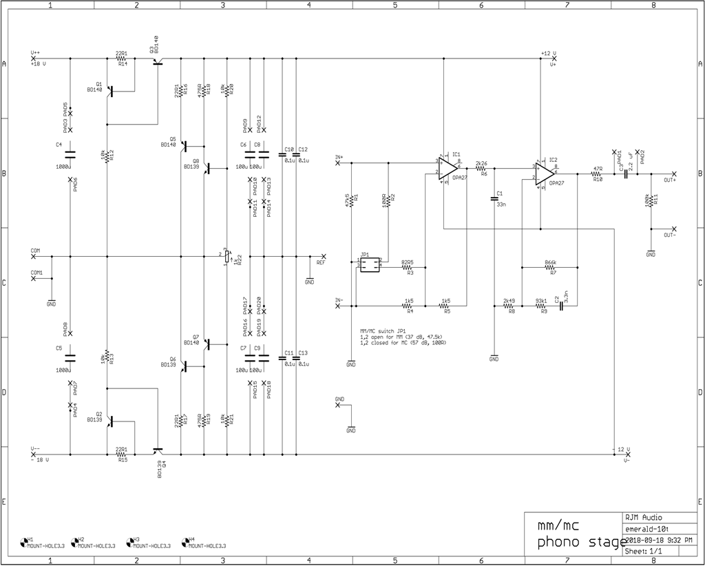

Tempted to try powering the Emerald phono stage off the Iron Pre shunt reg rather than with it's own trafo, as designed. The trafo is only 18V, 25VAC.

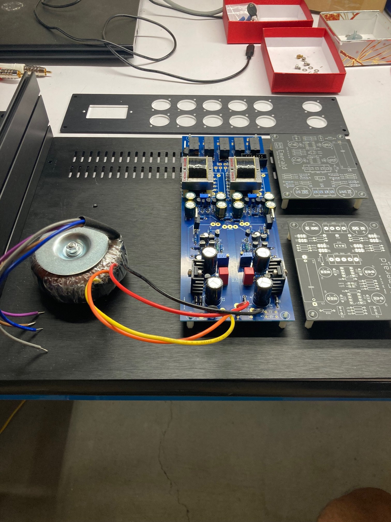

Thanks to @Gianluca for drilling the bottom panel like I wanted. The holes are perfect. 👌

The Emerald is dual rail and while I don't know it's current draw, the Emerald's design has it's own onboard regulator and calls for it's own 25VAC to 35VAC trafo. Per the second hole in the baseplate 😉
what's dual rail and you're speaking about one secondary voltage?

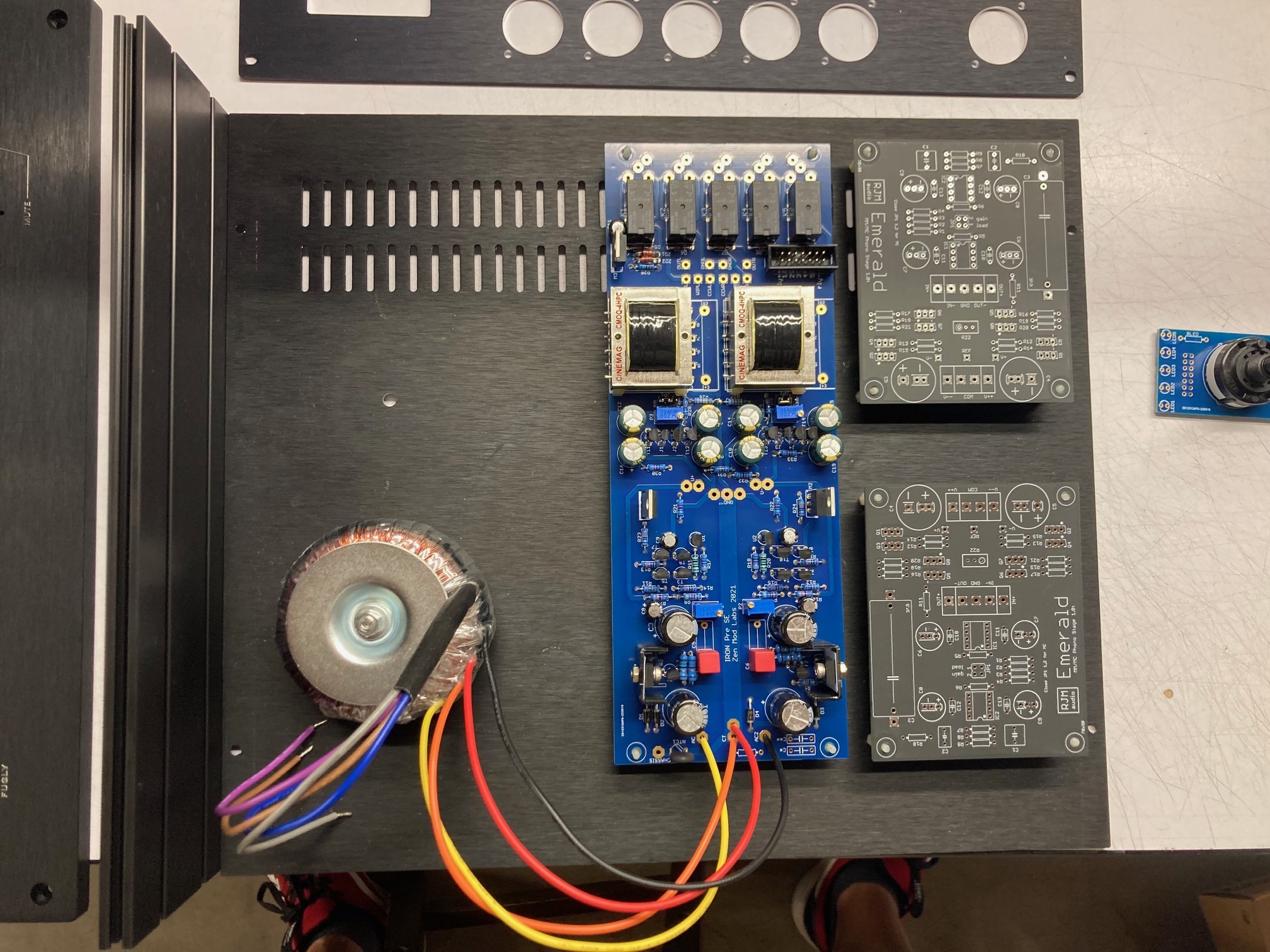

Ah, yes, typo in #1330. +/- 18V. Not only second trafo, now thinking I need fancy cans for them both. The one shown was only $20 & shipping amortized over some other stuff, anyway.
if VA of your xformer for Iron Pre is allowing, connect Emerald to it too
do your math
if you're unsure ( as I am in things I know squat about), give me current number for Emerald and VA for Donut you already put in
damn, you have entire corner empty there, you should move that Donut all the way to front plate and left, if you already can

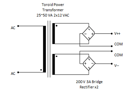

The input power for the Emerald boards is for rectified 2 x 12VAC per the diagram below. I couldn't find a current draw spec from either the literature that came with it or in RJM's thread on same here, last I looked for it a few weeks back. But the input to the Emerald shunt reg is shown as +/- 18V rectified, unfiltered and unsmoothed DC. Hence I thought if it didn't draw too much current (vague and imprecise I know), maybe the Emerald could draw very smoothed +/- 18V DC from the Iron Pre's shunt reg, into it's own shunt reg.
The trafo I have in hand today is a Triad Magnetics VPT36-690: 115VAC to 2 x 18VAC, 25VA. I spec'd it to power the Iron Pre on it's own, not both the Iron Pre and the Emerald. I'm fine to do this with two trafos, but, there'd likely be less magnetic interference with one trafo up in the front corner, as you noted.

shunt regs
programmed per rail as 0V65/22R1=1pprox. 30mA
means roughly taking 1,1W from 36Vct xformer
per channel, as I see it, so 2.2W
you're good taking juice from saidf xformer to both Iron Pre and Emerald
Iron Pre is having regs programmed for 0V65/(15R//18R)=80mA
so, stereo Iron Pre sucking under 3W
