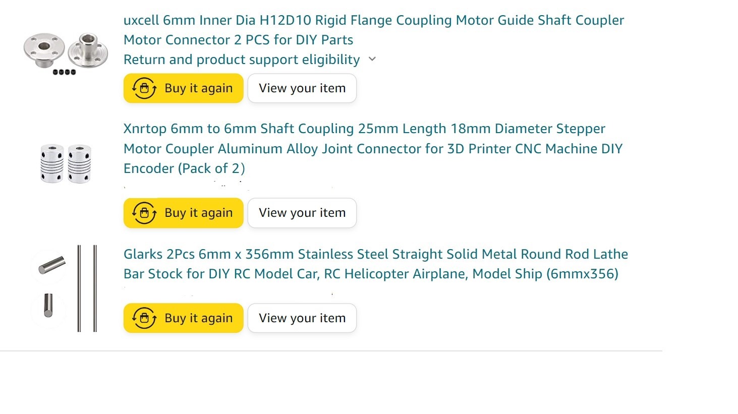

find extending rod, move that Alps all the way back
as 6mm rod guide for front use front side of old pot - just dismantle it and screw to front plate
rod-pot connecting sleeve (name??) - if there is no handy one, everywhere selling for CNC builds, you can use short pieces of gasoline hoses with 5mm ID, clamped with zipties

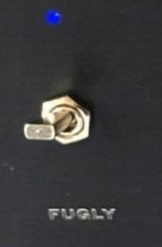

It's Alive...
Is it the front toggle switching the transformer primary? Would it be safer to switch secondaries instead? Or use a plastic switch?
I will probably omit the front switch. TBD
These parts provide a more fancy soluion. Available on Amazon, but you can find these parts elsewhere too...
no
case is on safety gnd, and switches as that are used for eons for smaller gadgets mains, without problems
