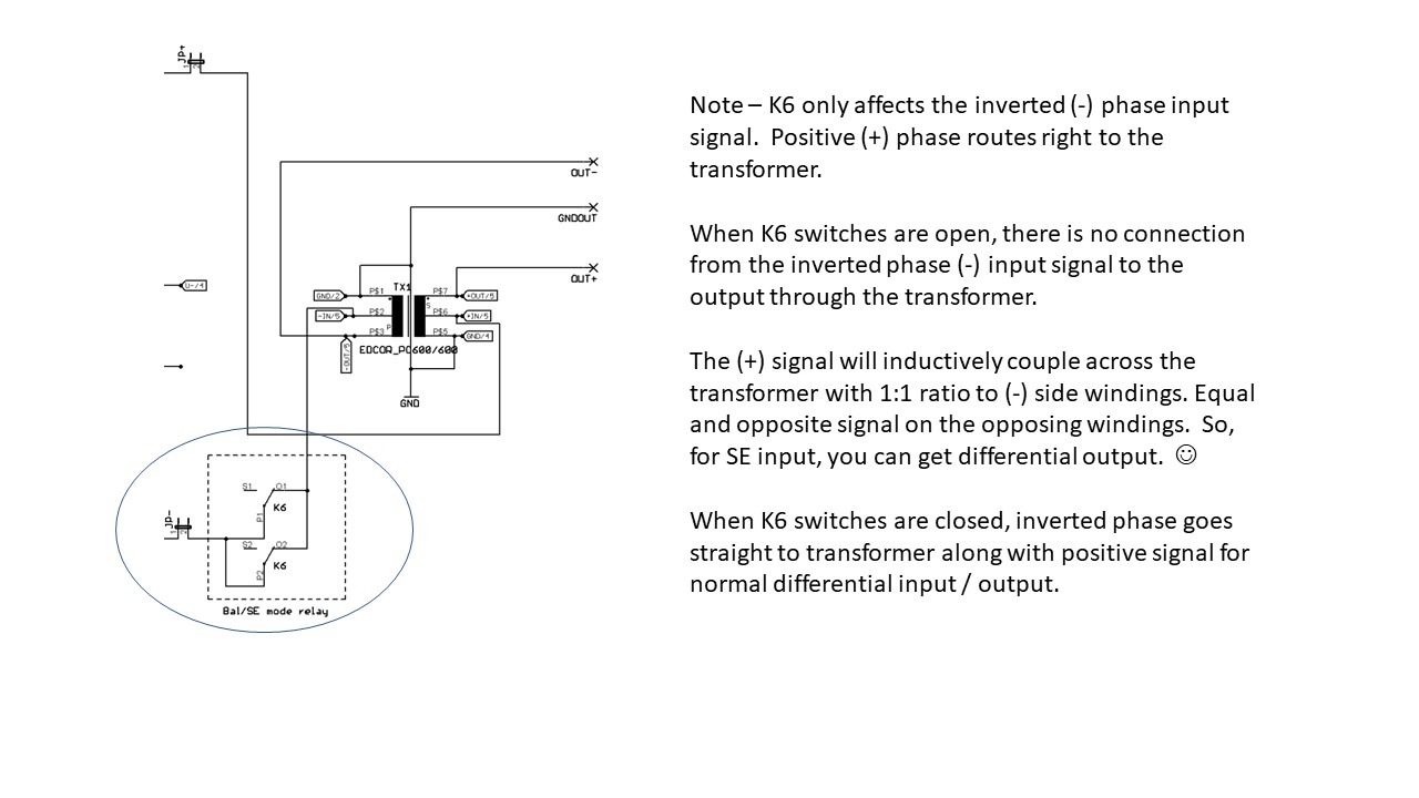

Yesterday evening I tried to figure out what prevents the negative phase buffer to get any input (when K6 is in "SE mode" = preventing output to get to the output transformer). I need to try again. But to find out the schematic to look at is the "input relay" schematic (which shows K1 - K5)?

for SE input, neg buffer's input is by default grounded ( short between input pads 1 and 3) and K6 is energized, so cutting connection between neg buffer output and neg phase coil of autoformer
K6 coil is together with all input relays schm
K6 contacts are together with input buffers schm

Here's an updated pic re: K6.
ZM - Noted with thanks as always. Most folks have never seen the previous schematics / boards. I ooked. Same things, but I didn't want to cause any more confusion than I normally do.
