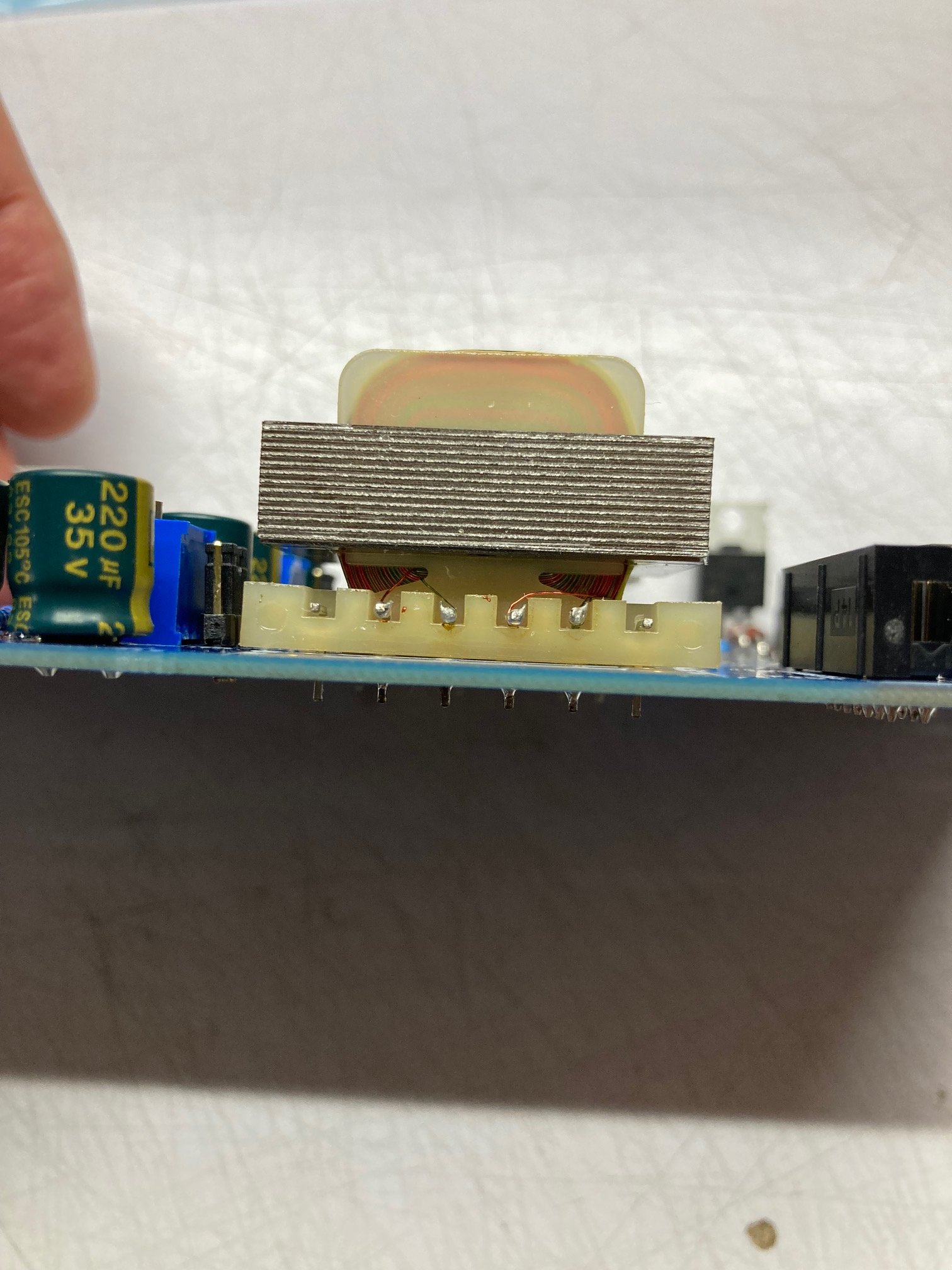

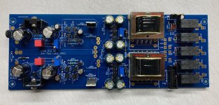

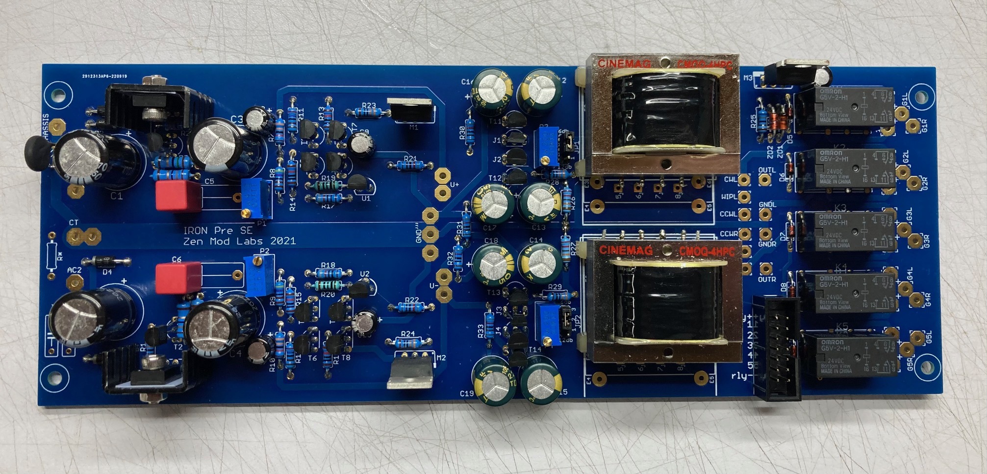

More progress. I like the Chrismas windings on the Cinemags, it shows the interleaving. I didn't have to do much trimming to get the Cinemag to fit over the edge of that one resistor, just clipped the corner with an x-acto. Now waiting for my chassis, and then to place a completion parts order once I see where everything fits.

^ Dang you're fast. I deleted the pic / post because with the updated boards... the overall function is the same, but the switching is just a weeeeeee bit different. I'll post a pic with better wording in a sec.
