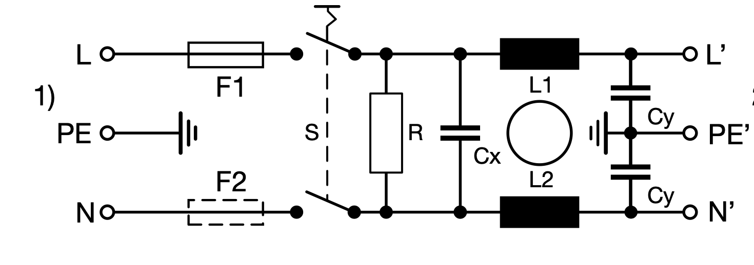

Attached is the schematic for the circuit within the Schurter DD12.9111.111 Power Entry Module. Is this filter suitable or desirable for audio equipment? I was about to buy one but figured it would be good to know what's in the "guts" before ordering. Data sheet attached as well.
Switch w: filter.png
"Attached is the schematic for the circuit within the Schurter DD12.9111.111 Power Entry Module. Is this filter suitable (for audio equipment?)
Yes
or desirable for audio equipment?"
Depends on your mains quality and the desire to to filter it along with the PSRR of the circuit and any other filtering present. Overall, I'd say unequivocally ... it depends. 🙂 I've never known them to cause ill effects, but some folks may know otherwise. Also, for peace of mind... this (or a similar) unit is included with the WHAMMY kits.
Note, this particular part number is rated for 10A. One could easily pick a less robust unit from that series of parts for this project. Me, I like to have them all rated for big honkin' power since I swap things between projects a lot. Note the dimensions and how they might impact your chassis layout. In addition, for our friends that require both their live and neutral fused, please be sure to also check the spec sheets and choose the appropriate unit.
Hope that helps.

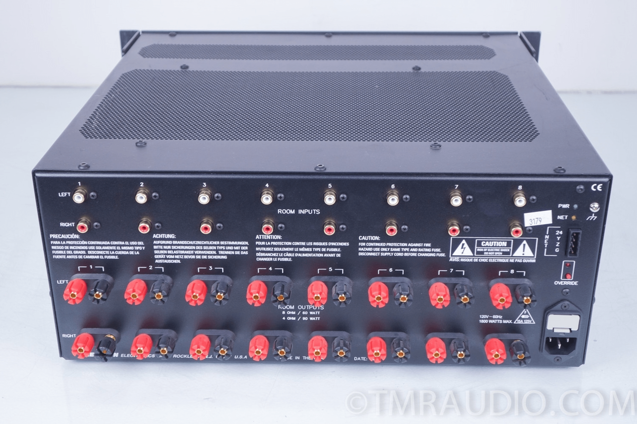

Crestron stuff is being pulled out of corporate offices. Their 12 and 16 (!) channel amps are great sounding in their own right (ATI, can be bridged for 200+ watts/ch, fire up that 16 channel home theater!), but for maybe $350 delivered, you get 80 pounds worth of chassis, heatsinks and tons of output and input connectors and some hum-dinger toroids. Trouble is, it hurts to break something that works apart for pieces.

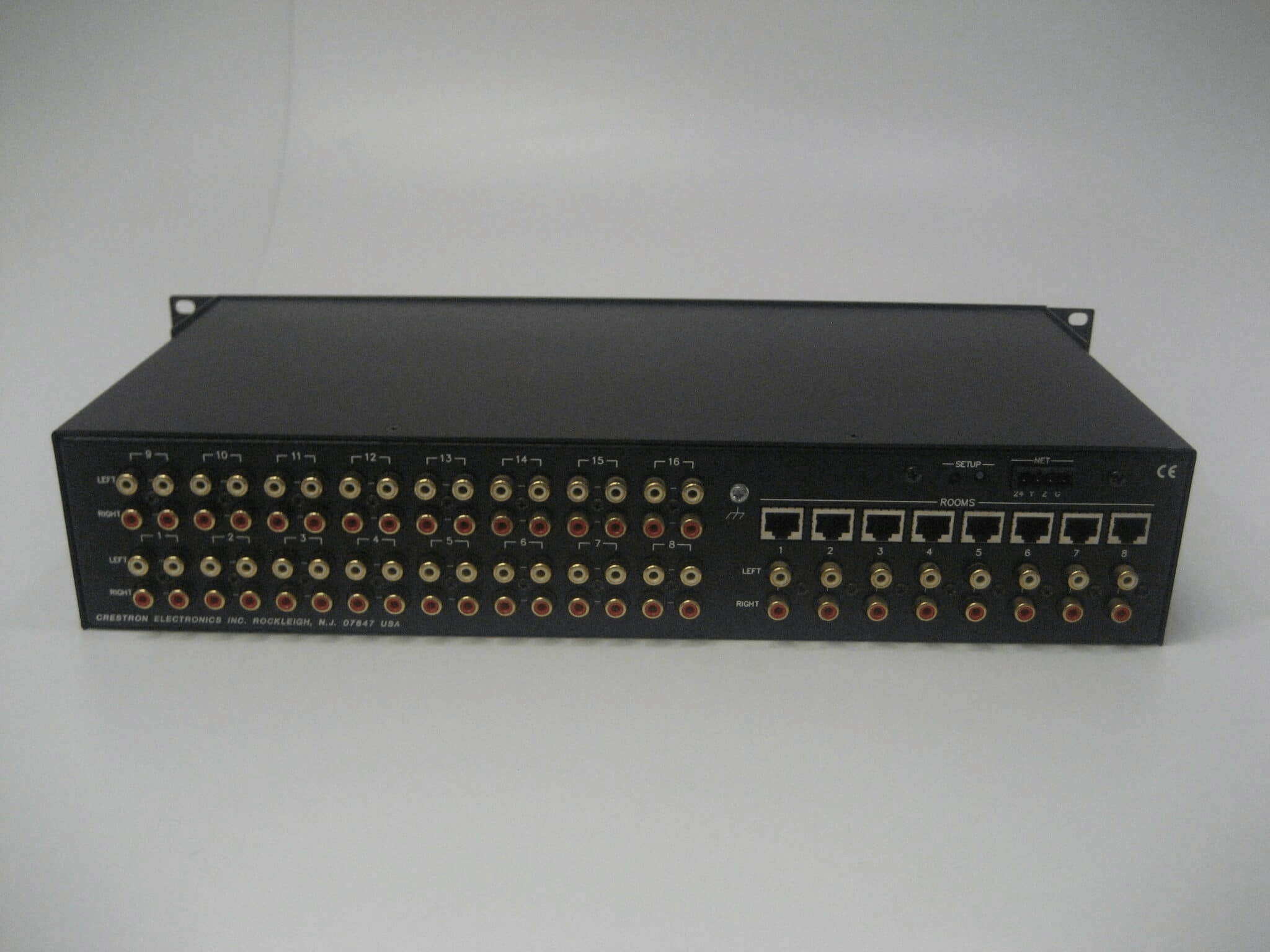

I picked up one of these software controlled signal re-distributio$65 delivered. Case, connectors, scavenge-able capacitors, surface ,mount caps, resistors, opamps, etc. No power supply in this, though.

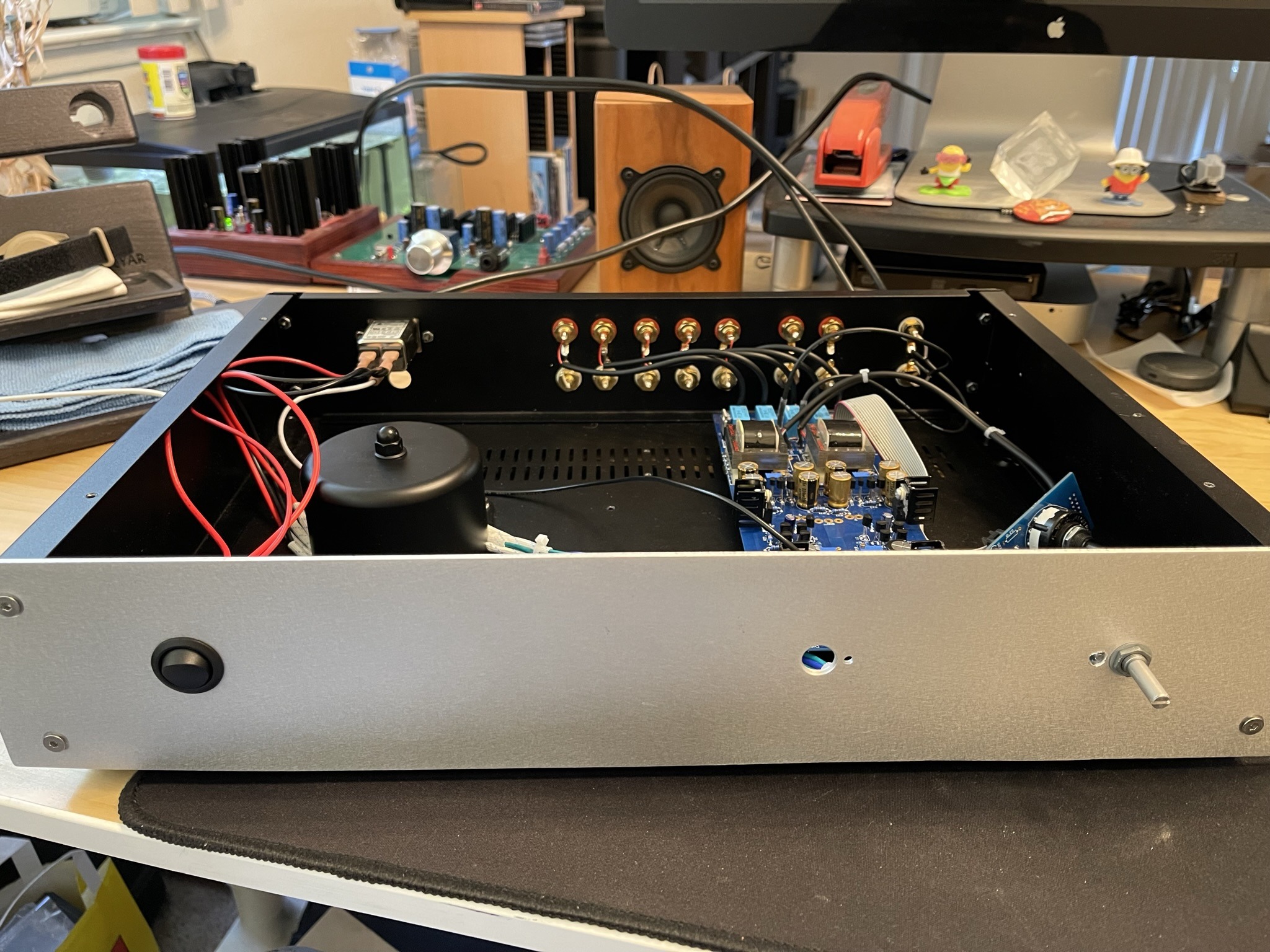

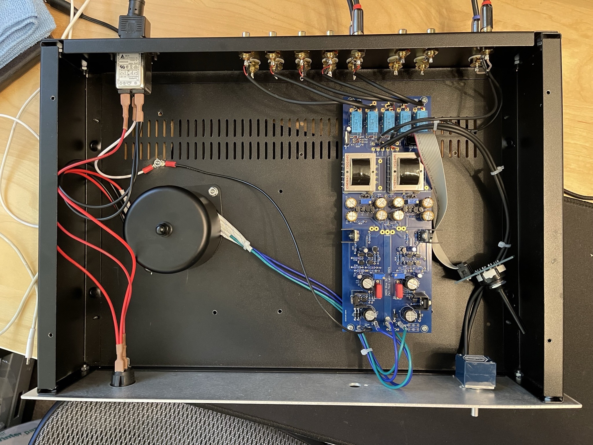

Finished putting all together in a PESANTE 2U enclosure which I used for a different project before. Made a simple front panel using the tools I had at home.
DC offset set to 0v, checked and re-adjusted the rail voltages to +/-15v. Connected to source and the output to ACA Mini. Plays well and sounds nice.
Noticed a faint sound when the selector switch was on mute position and volume close to full output. Source was connected to input 1. Will do more listening this weekend.
Need to make a longer cable for the input select switch before putting the top cover.
Thanks again for the nice project!
