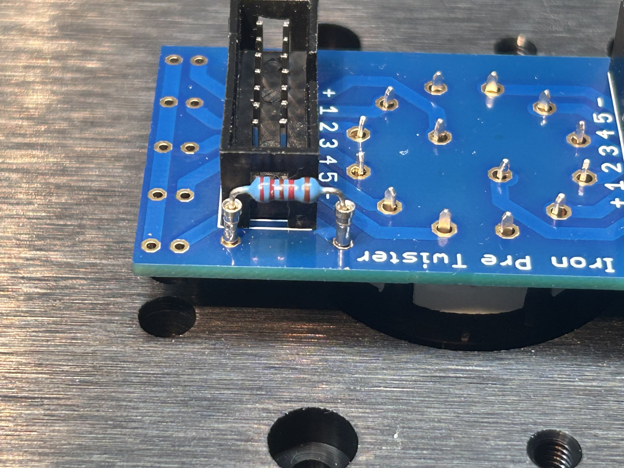

Guess I was lucky 🙂. The leads were just long enough to solder on the PCB.Lovely! Great to see the leads of the '10mm' caps for C5 and C6 could be manipulated a bit w/o harm. Sorry again for that goof.

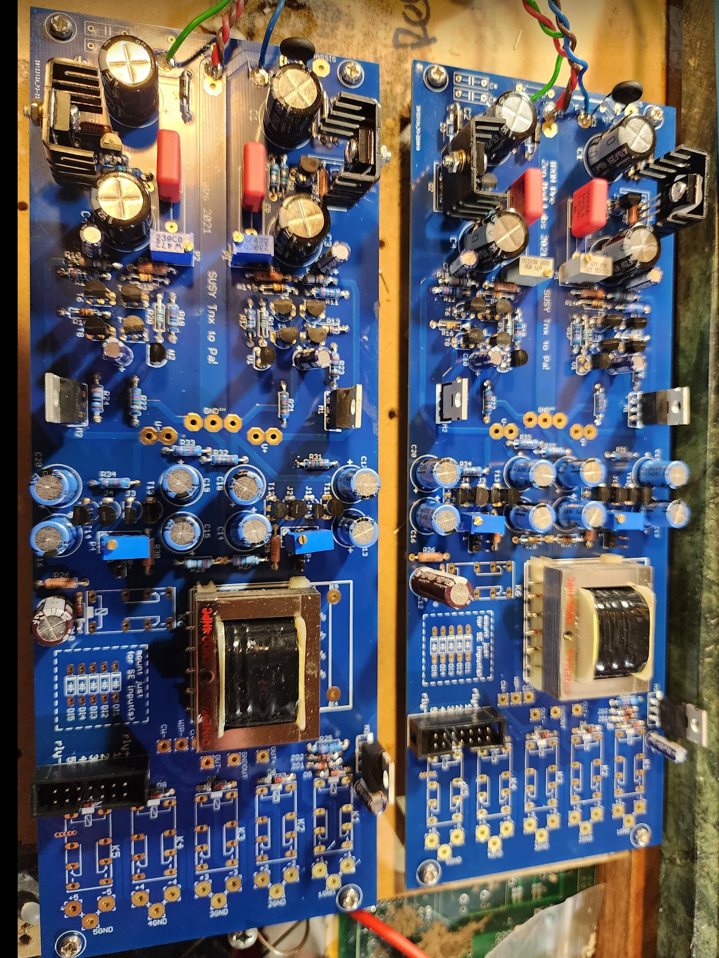

Made some progress
Rail voltages all good and easily adjustable. Offset easy to zero for both positive and negative signals. Only need to install the relays and a volume potentiometer - I have opted for 12V relays ( all that was in stock ) , the anode voltage is odd - negative 22V , Cathode is at negative 6V - the zener is 16V , so that gives them a 16V differential - I need to look at the schematic again as I suspect I should not be using the circuit ground as reference
anyway - all the part in the BOM make the circuit itself work as expected

Final picture until it has been tested with Music
All mechanics and electrics check out . I was going to make my own cables but the ribbons are just so convenient - clever mr zen
Need to sort out how many SE vs Balanced inputs I need and get it rigged up to be able to be tested as a preamp
Overall a very cool project to assemble , I am curious how this holds up to my SRPP tubed pre

Looks great dB, nice work!
This process has been a very long one, you and the merry band of beta testers are the final hurdle for these IP projects getting released out into the Wild.

Also, what value did you use for RLED on the switch board?
I used 10K, but it is not a critical value. Just something in the thousands and not too much higher than 20KAlso, what value did you use for RLED on the switch board?
as Boyz are saying - not critical
ZM's Thumb of Rule - use 1K per each rail Volt
and you can even double it, LED will be visible
