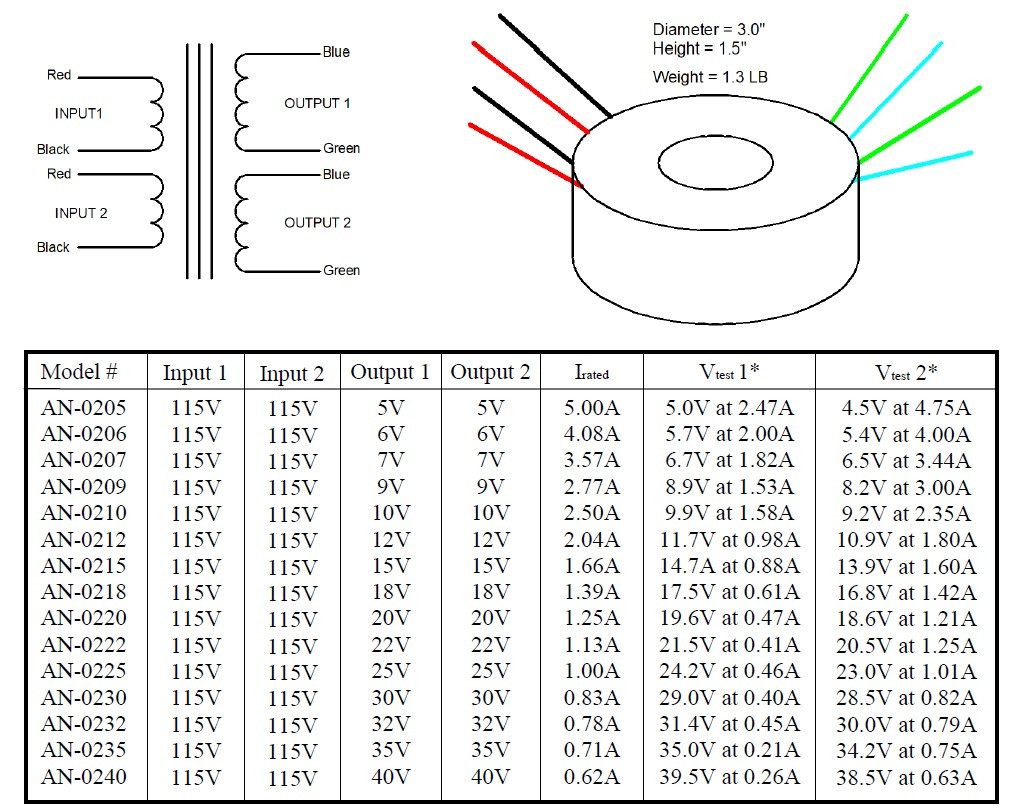

I have not ordered transformers yet and Antek shows "Out of Stock" on the AS-0518. Can someone recommend an alternative? I checked into some REALLY nice Toriody Audio Supreme 30VA transformers, but by the time they're shipped to me they're about $100 each(I need 2)...somebody better stop me before I order these.
The AN-0218 may be a good option. The shield is dependent on your mains power. I'm not a person that says that they're a must have vs. a nice to have, but others may chime in with more knowledge.
They even make nice little 'cans for them' CA-002.
Edited to add - Vunce beat me to it. 🙂
Just for reference, Here’s a photo of the new cans that antek sells: (an-0218 shown too)

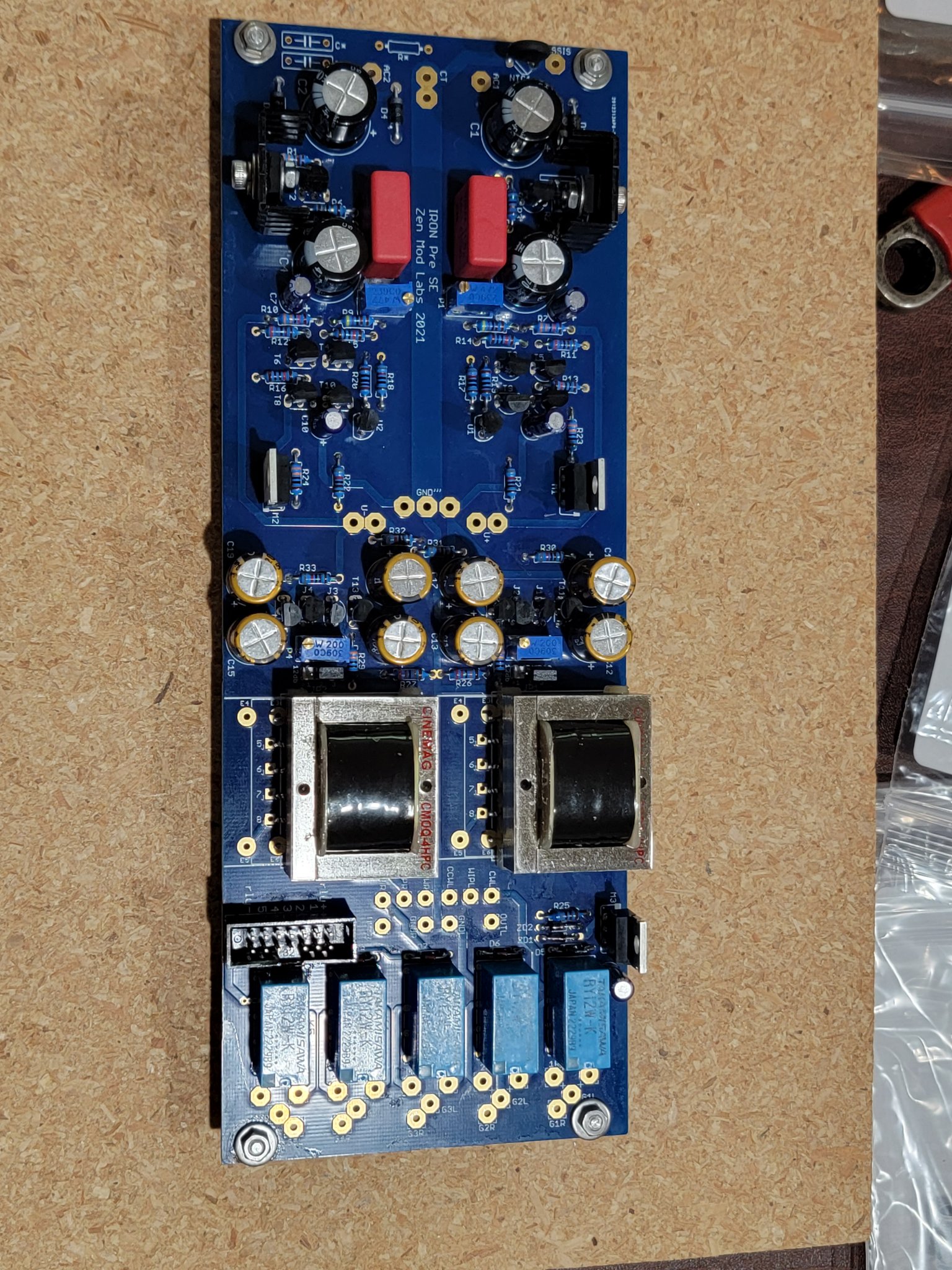

Finished the power supply last night then scrubbed the board before applying power. Hope to get the transformers set up later to test voltages and then finish the build.
One feedback element for builders is to be diligent with the heat and allow time for the solder to flow. I typically solder with a hot iron (450degC) and the traces on this board are heavy, taking much more to let the solder flow than I typically am used to. If you are not careful, you will end up with poor contact or cold joints. (except most of you are pros and this is me preaching to the choir)

Use a pair of these Anteks for Bal Iron Pre:
https://www.antekinc.com/an-0218-25va-18v-transformer/

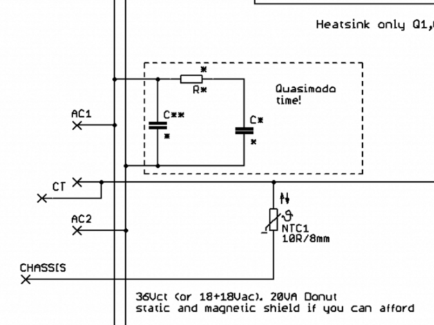

Given the AN 0218 (which I have) and the Balanced Pre, per the schematic:

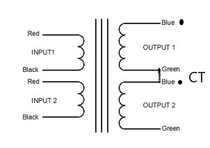

Am I to wire secondary set A to AC1 (blue) and CT (purple), and secondary set B to CT (blue) and AC2 (purple) with each secondary basically driving half the power supply's rectification?
The secondaries wires are usually blue and green.
Either way, see the diagram in the spec sheet you attached and the yellow sticker on the side. Usually the blue wires are shown with the phase dots.
Secondary 1 Blue - AC1 | Secondary 1 Green CT | Secondary 2 Blue CT | Secondary 2 Green - AC2
