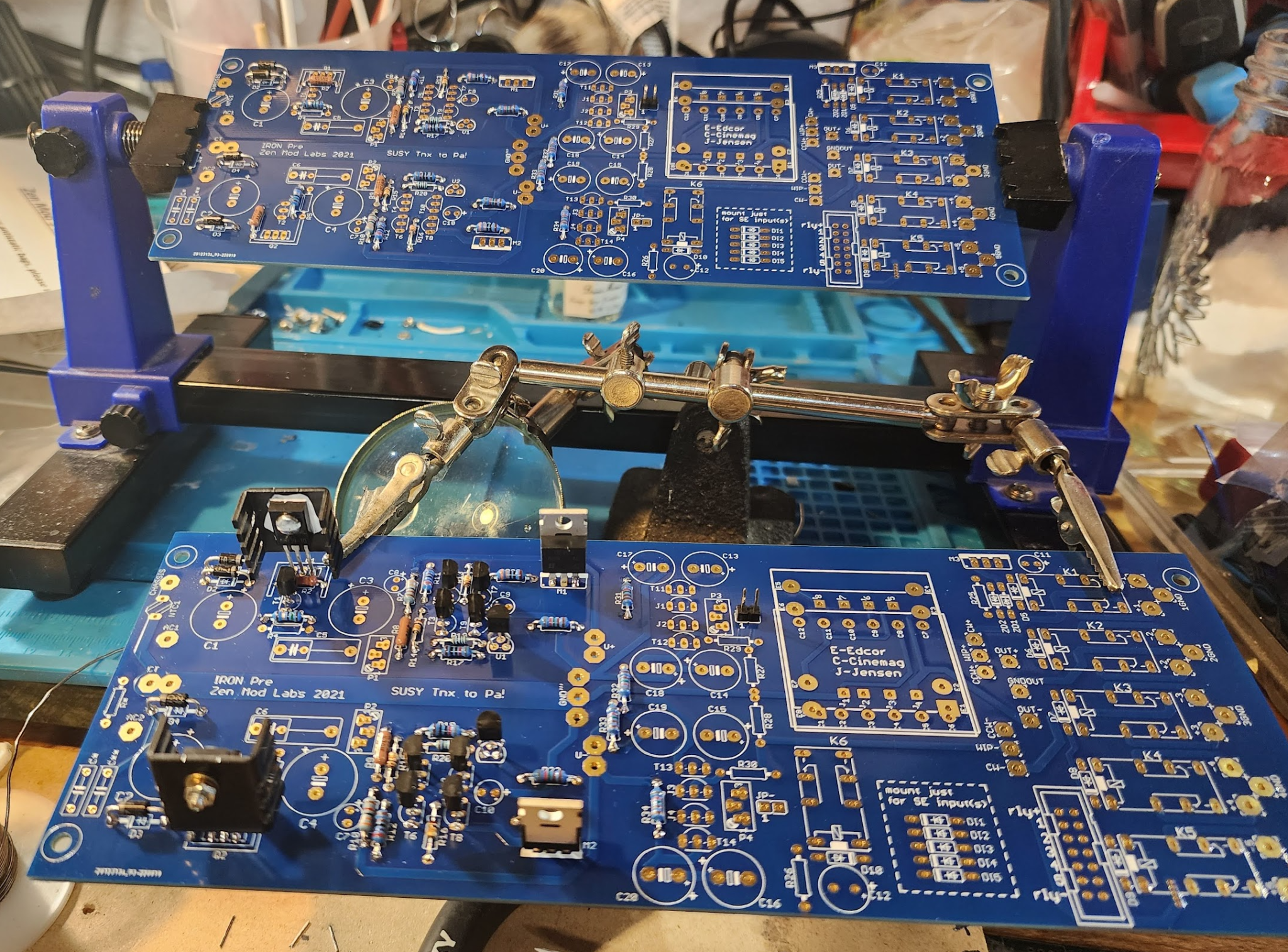

Here is where I ended up last night.
I somehow didn't catch that I needed 15R and 18R resistors and didn't double up on the 20R trimmer , so waiting to find all my errors and will then order the final bits.

Let me know what you need. I have extras of most things, with the exception of P1 & P2...can't help you there.
Source of M1 to Anode of ZD1 = ~13 Vdc.
I'm using 12V relays.
you're good - it'll go down with relay coils loading ; not that 13V will do any harm, but it'll go down
How critical is the value of 470uf for C12? Obviously I forgot to put a small 470u cap in my Mouser Cart and can't find much in the drawer. I do have a 1000u that will fit.
go for it - it'll prolong On/Off time for mode switching relay, (not) big deal......

somewhere back I explained how to with 18R/15R resistor positions

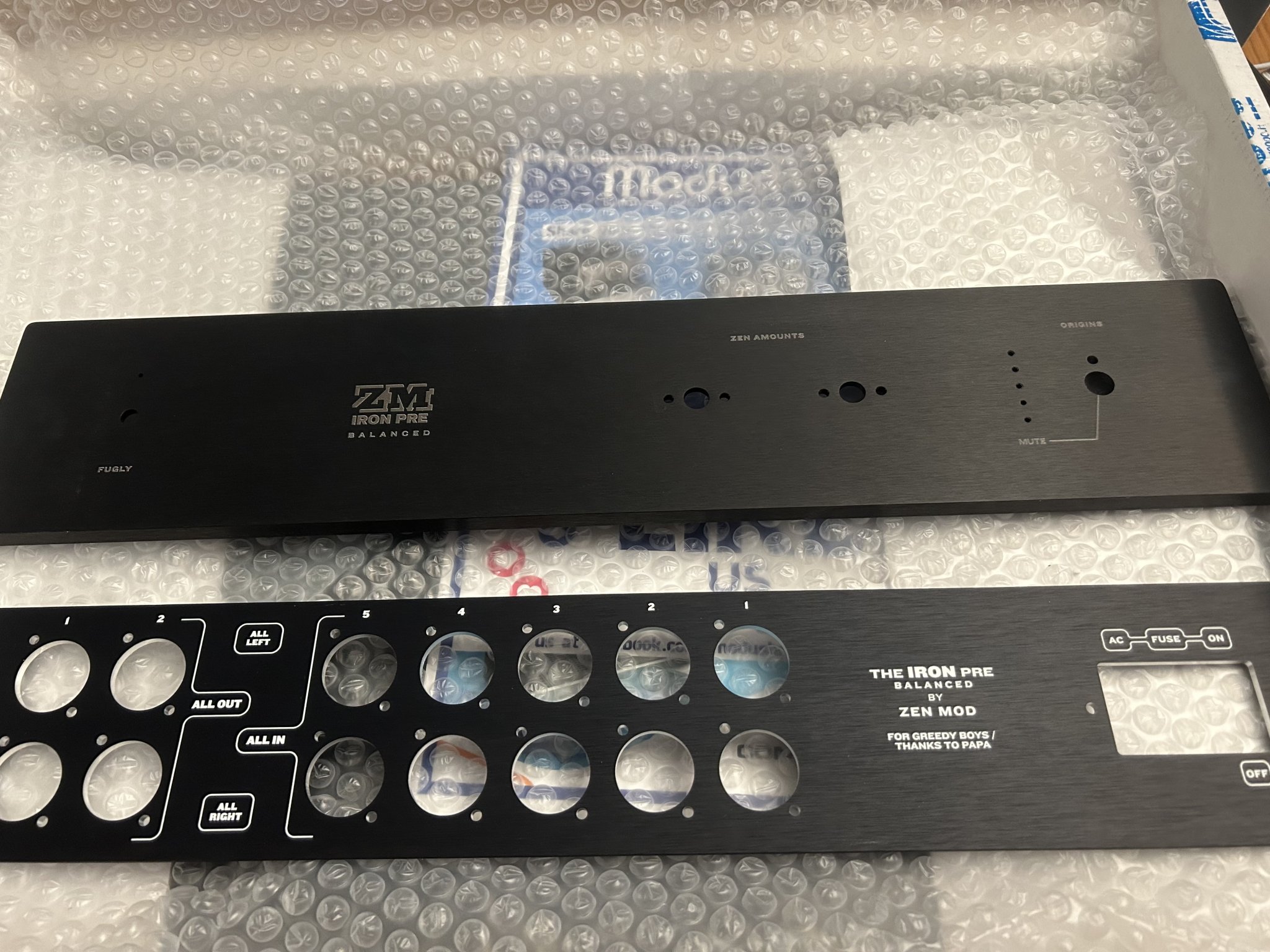

It’s a prototype chassis…hopefully they hit the store someday.Sorry if I missed this somewhere along the line…. Is the chassis included in the kit?
My metal work sucks…I’d totally butcher that thing. Actually I have friend (retired machinist) who has a small shop behind his house. I’ve been having him do my machining. He’s not so good of a friend he doesn’t charge me though. So when I saw the chassis Jim had, I knew it was worth getting just to save the time and effort of having that back panel made by my “friend”.
