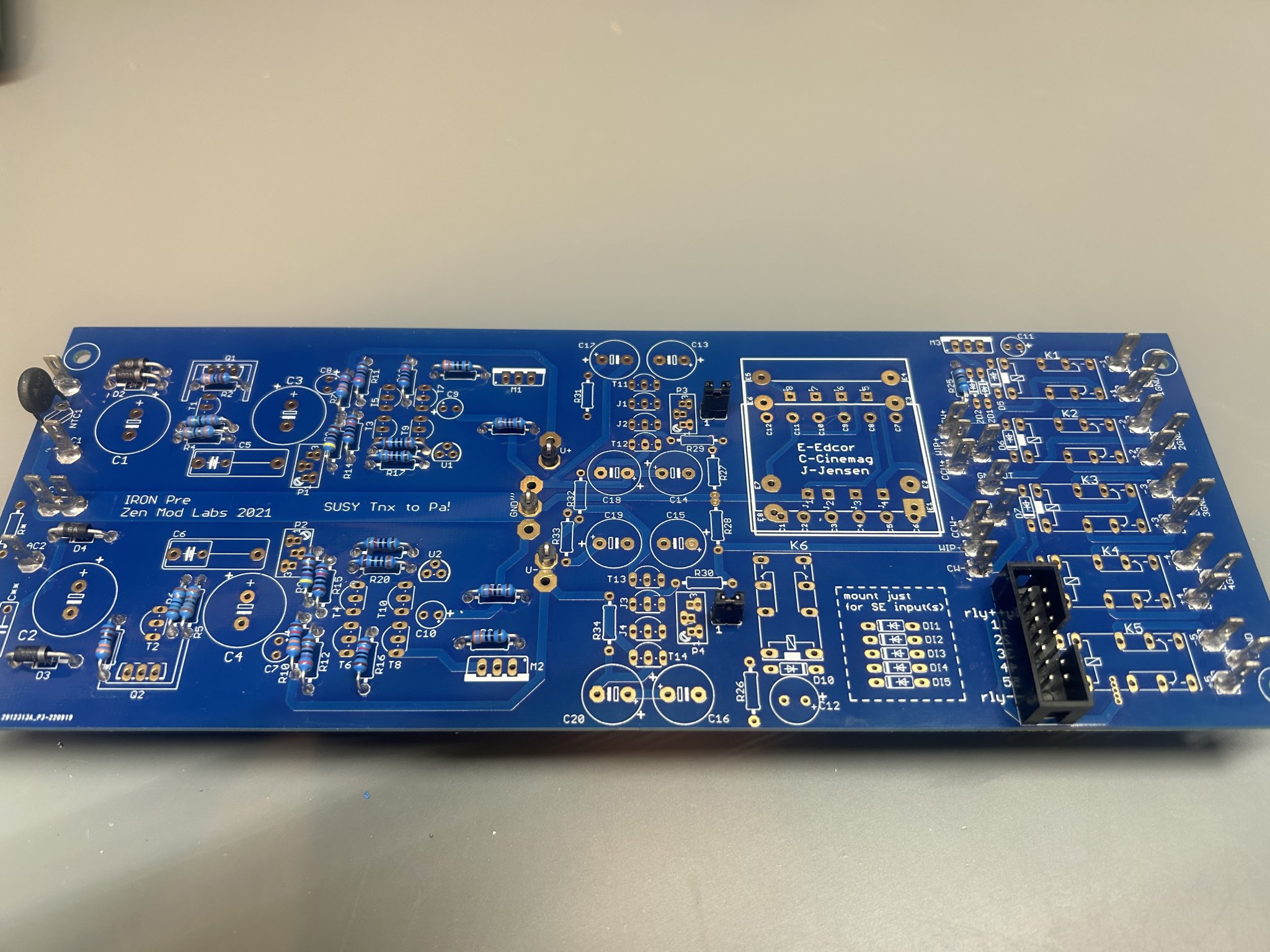

Mighty one is hovering over us as we build…love it.trimpots and lower caps and relays, then TO92 fuses
Take a close look at R22 & R29.Finished installing the diodes and resistors. Next up are the three legged creatures.

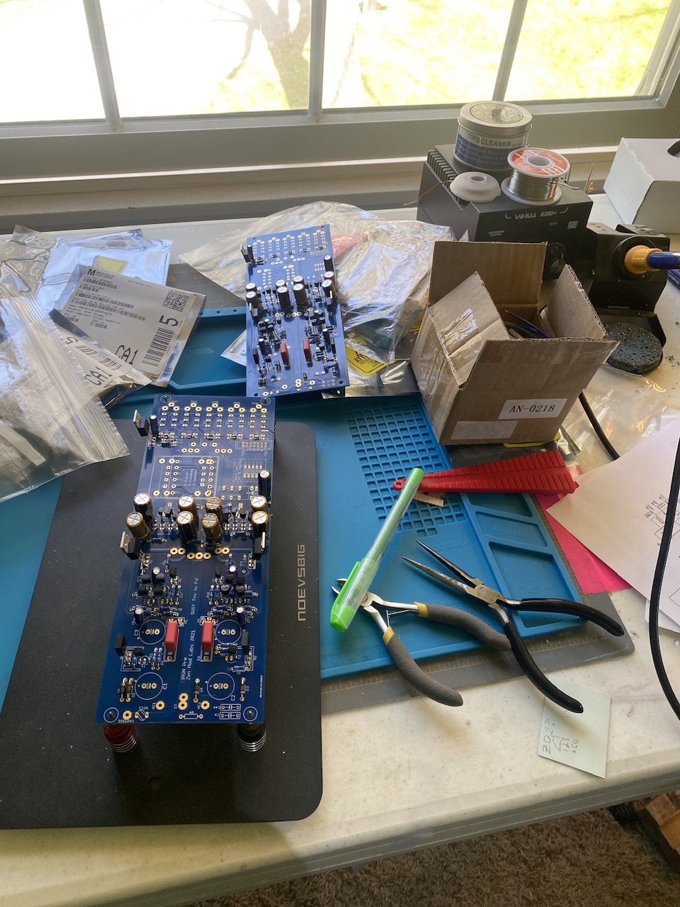

Had to travel for work just after the box arrived but got home last night to find a fresh box of mouser parts for me to investigate 🙂.
Now the fun can begin and I can try and catch up to my partners in crime.

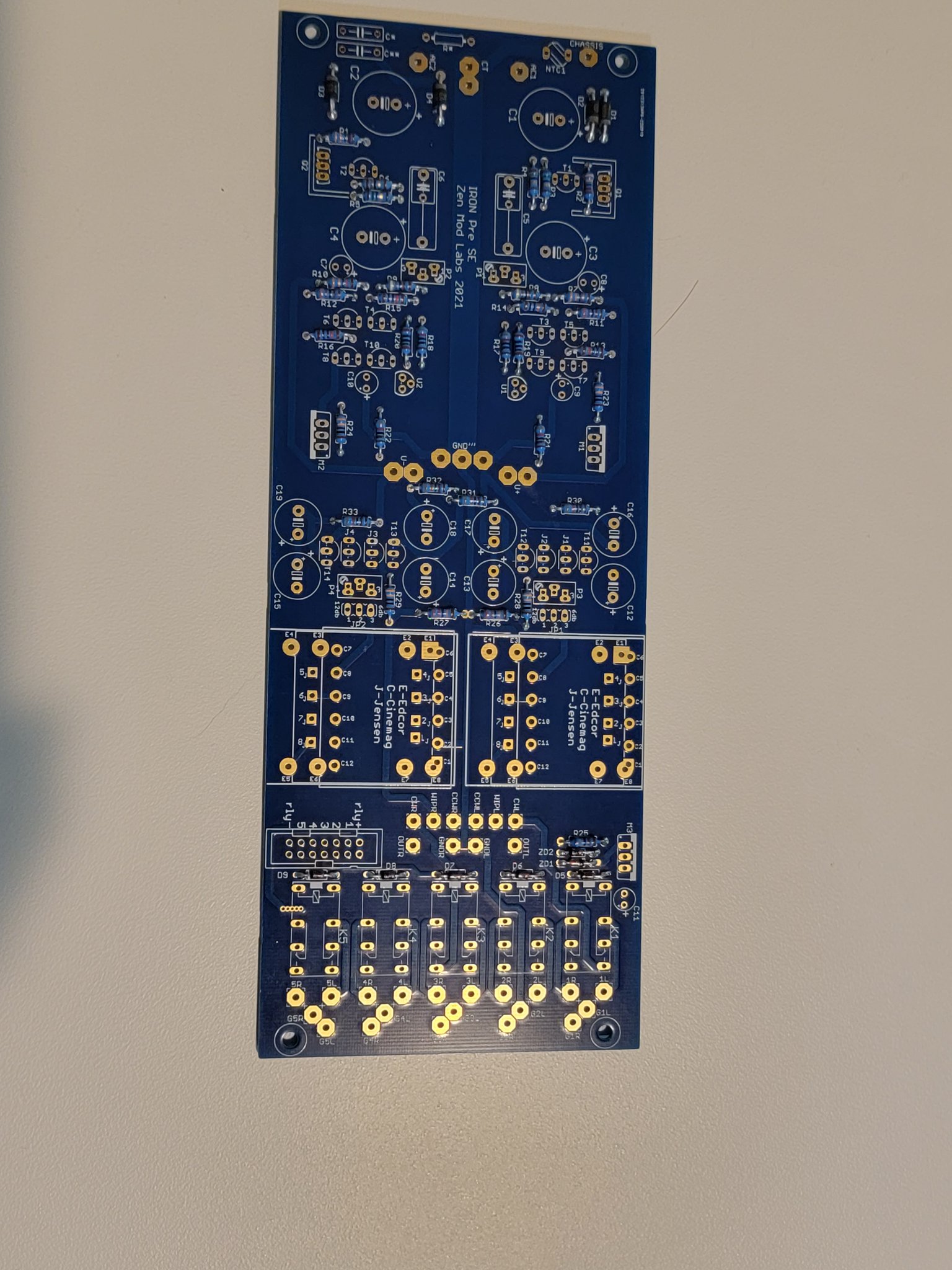

^ As is typical... I'm away from my boards. Please check your C5 and C6 to be sure they're not shorted. I believe those two pads have continuity. The correct sizes that fit are 5 and 15mm pitch. So, the shortest two pads or the longest two. The middle pad and the furthest pad (the 10mm), I believe are shorted. That was my mistake.
Anyone close to their boards that could double / triple confirm for @Toadroller?
Yes, the middle and furthest pads are shorted. He needs to use either 5mm or 15mm pitch caps.^ As is typical... I'm away from my boards. Please check your C5 and C6 to be sure they're not shorted. I believe those two pads have continuity. The correct sizes that fit are 5 and 15mm pitch. So, the shortest two pads or the longest two. The middle pad and the furthest pad (the 10mm), I believe are shorted. That was my mistake.
Yep, it's a nope. Won't much get through C5 and C6 if they don't straddle the line.
I'll add the appropriately-spaced parts to my next Mouser order. One can count on a second order anyway: there's always something. In my case, I also forgot ZD2. But we'll see what other components I might have missed or mis-ordered.

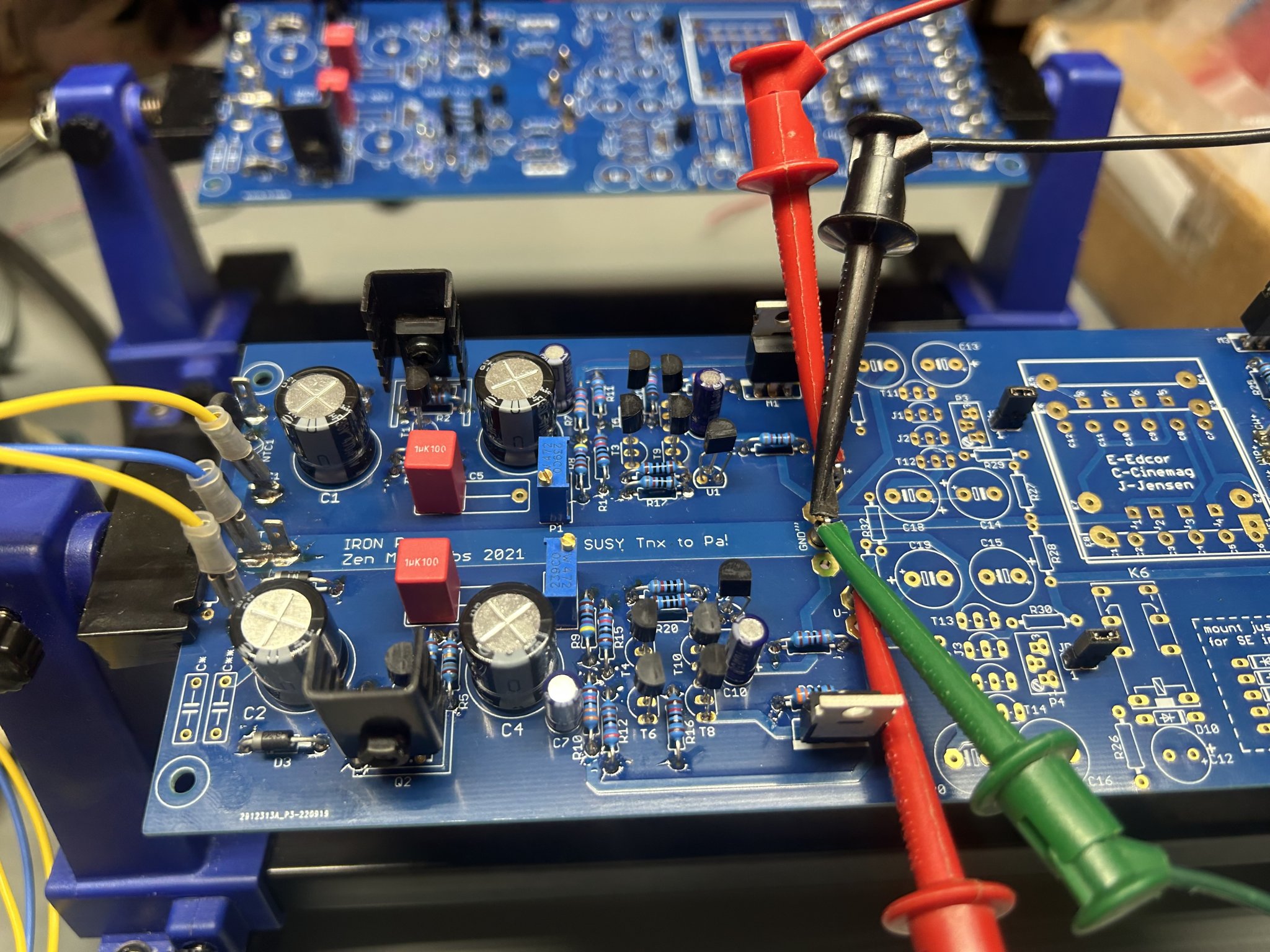

^ Wooooooo 🙂 Check D3. May be my display, but it looks backwards.

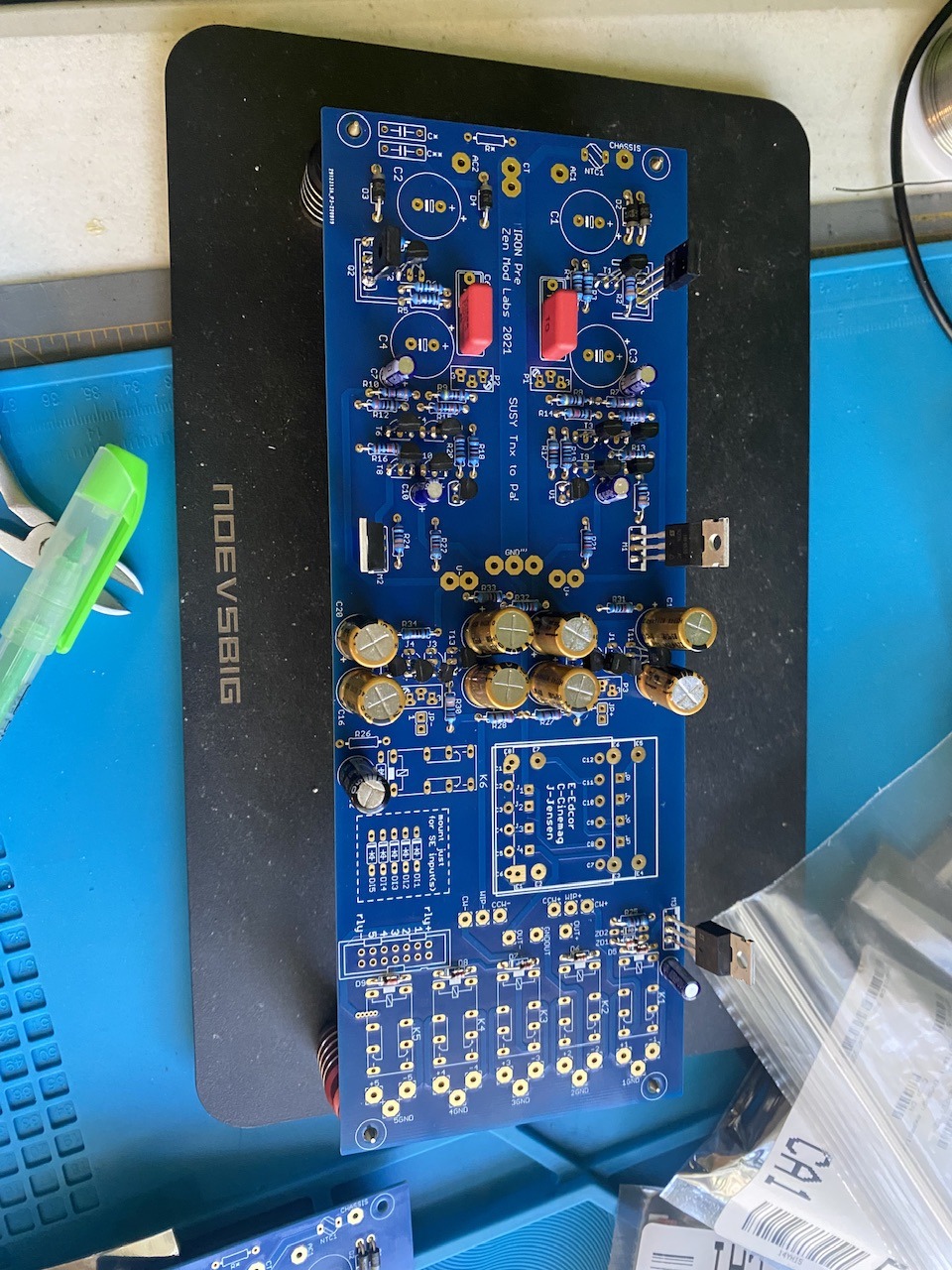

mount bloody hsinks on BD critters, then solder it on pcb
fingerpoking with screws when part is soldered is better to avoid, as general rule
