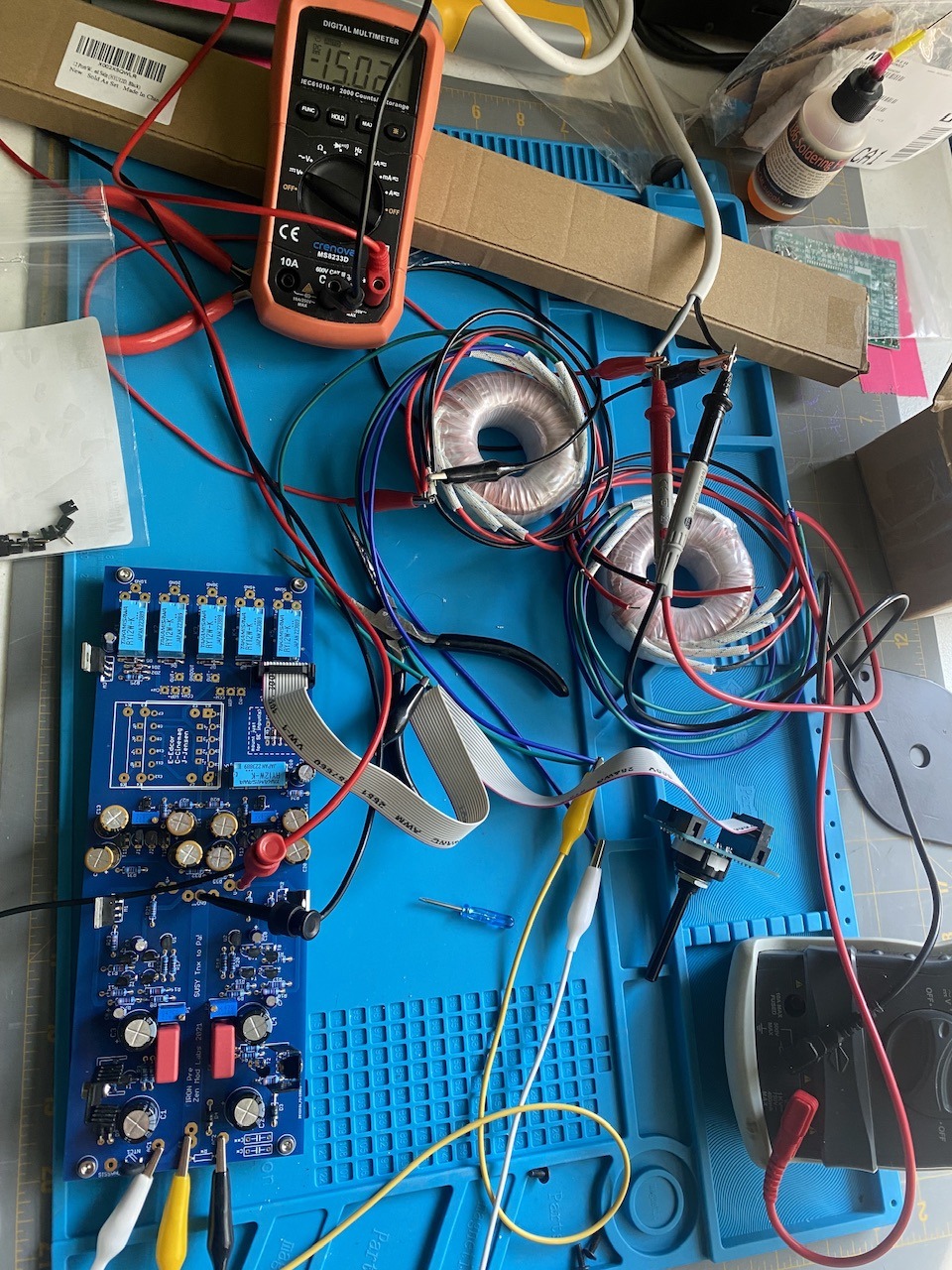

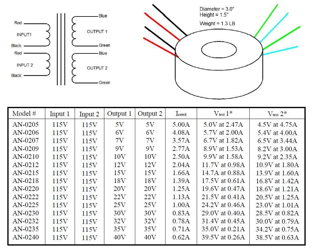

On my pair of Antek AN-0218, continuity check on outputs (blue-green) is fine, but on inputs there is no continuity red-black. On either of the two donuts.
Anyone else experience that? Could I have gotten a bum pair?

Try measuring the resistance, which may be sufficiently high to not trigger the meter's continuity.
Dennis,
Good call. 60 ohms. Not insignificant.

Power supply tested in a very non-OSHA approved fashion.
Don’t try this at home. Wait. That’s where I did try it
