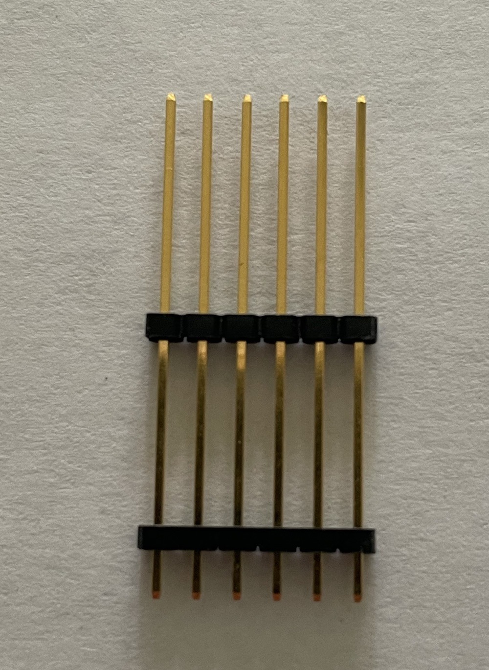

Is this the place to ask remedial questions? Regrettably, I have a few.
1. What is the name of the gizmo in the attached picture? I'm thinking of something like this with a jumper to select between 6 and 12 db of gain, but my Mouser navigation abilities are weak. Yes, I can (and probably will) modify that thing I have, but I'd like to have the ability to order the parts I need.
I call them headers / header strips. I use things like this and cut them to length. I have a zillion header caps from PCs etc., but you can order those too if you need them.
https://www.amazon.com/Straight-Bre...887792&sprefix=0.1+pitch,aps,3419&sr=8-3&th=1

1. It’s called a header and has 2.54mm spacing. You can get them at Amazon as well as the mini jumper.

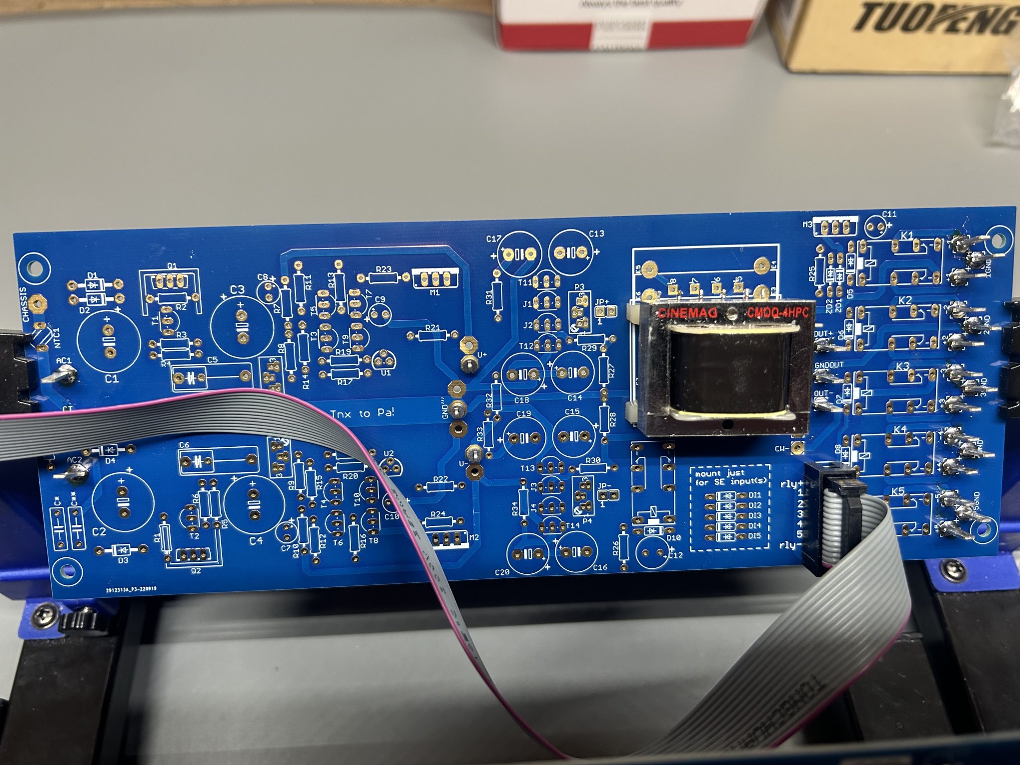

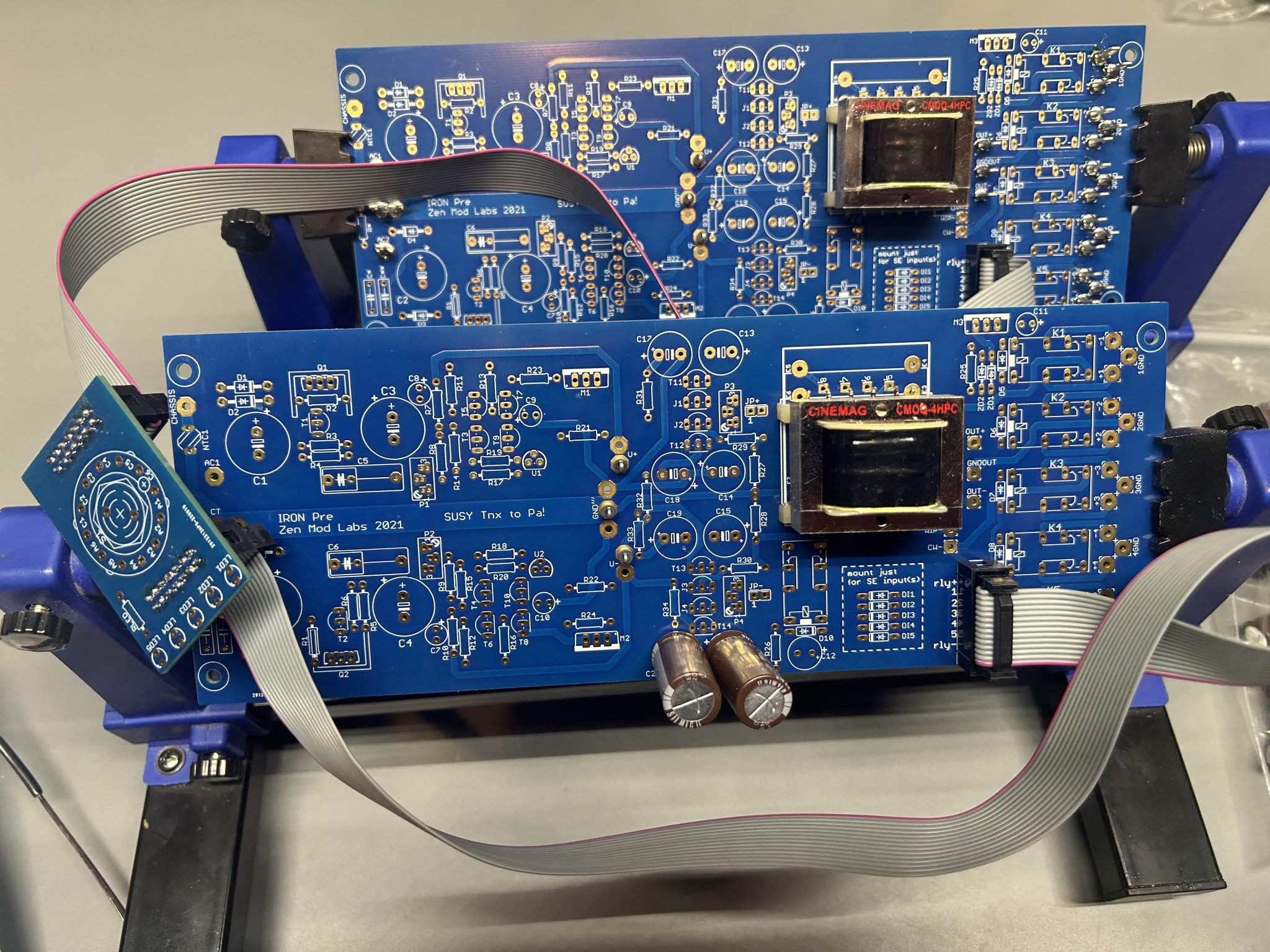

Here's the extent of my work this weekend...I don't have my Mouser order yet 🙁. Transformers and caps are just dry fit. The Silimic II's I was going to use are a tight fit...are they worth using in this position (C13-C20).
View attachment 1169867View attachment 1169869
Couldn't find the actual Fujitsu relay at Mouser so I ordered these from Amazon:
https://a.co/d/9qTVQvV
use smaller caps
take care of using appropriate zener in relay voltage reg
27V for 24V relays
16V for 12V relays
any other - relay voltage+3 to 4V

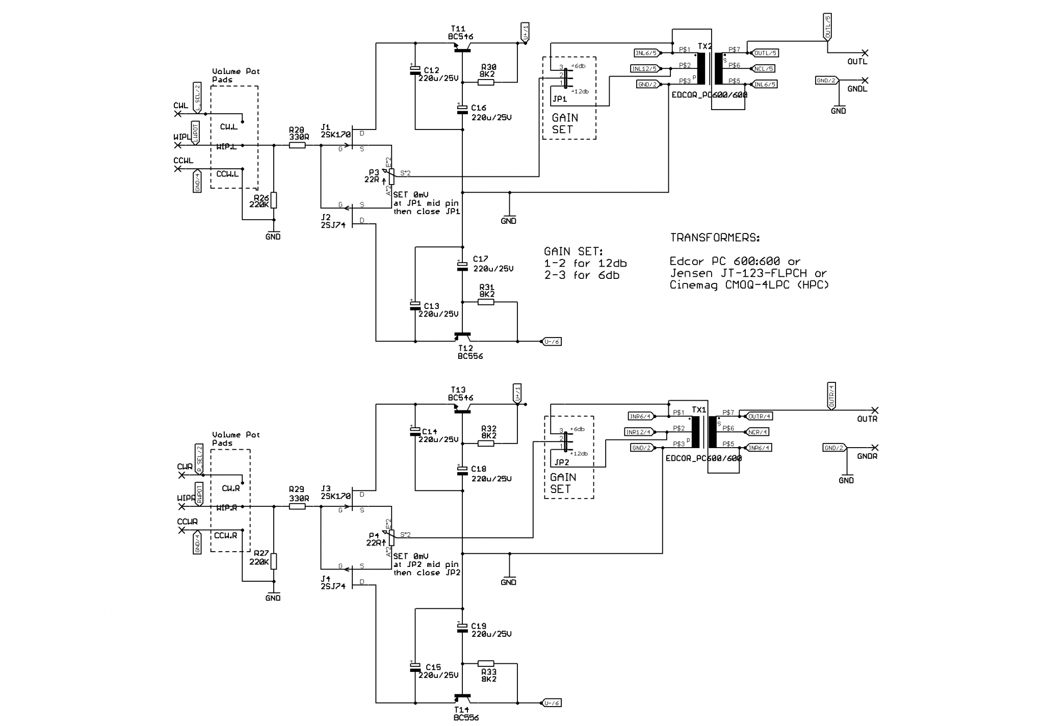

I've been staring at the schematics for a while now, which has prompted a question...what exactly is the purpose of T11 & T13 and T12 & T14 (+ surrounding components). Sorry to bring this down to a 101 level class.
