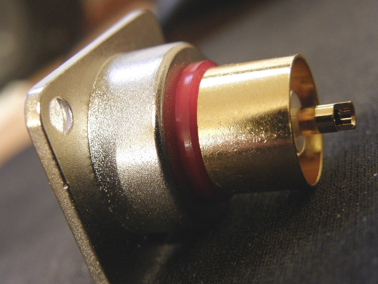

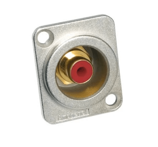

Guys, I can tell you that the RCA jacks that I am using are temporary! I do not like them at all. Neutrik costs more for a reason apparently. These are cheap Chinese copies. How many times must I learn this lesson!?

Yes, I've long ago given up on cheap RCA jacks. I find that REAN is also a good-quality product and I've used probably a hundred of each color now.

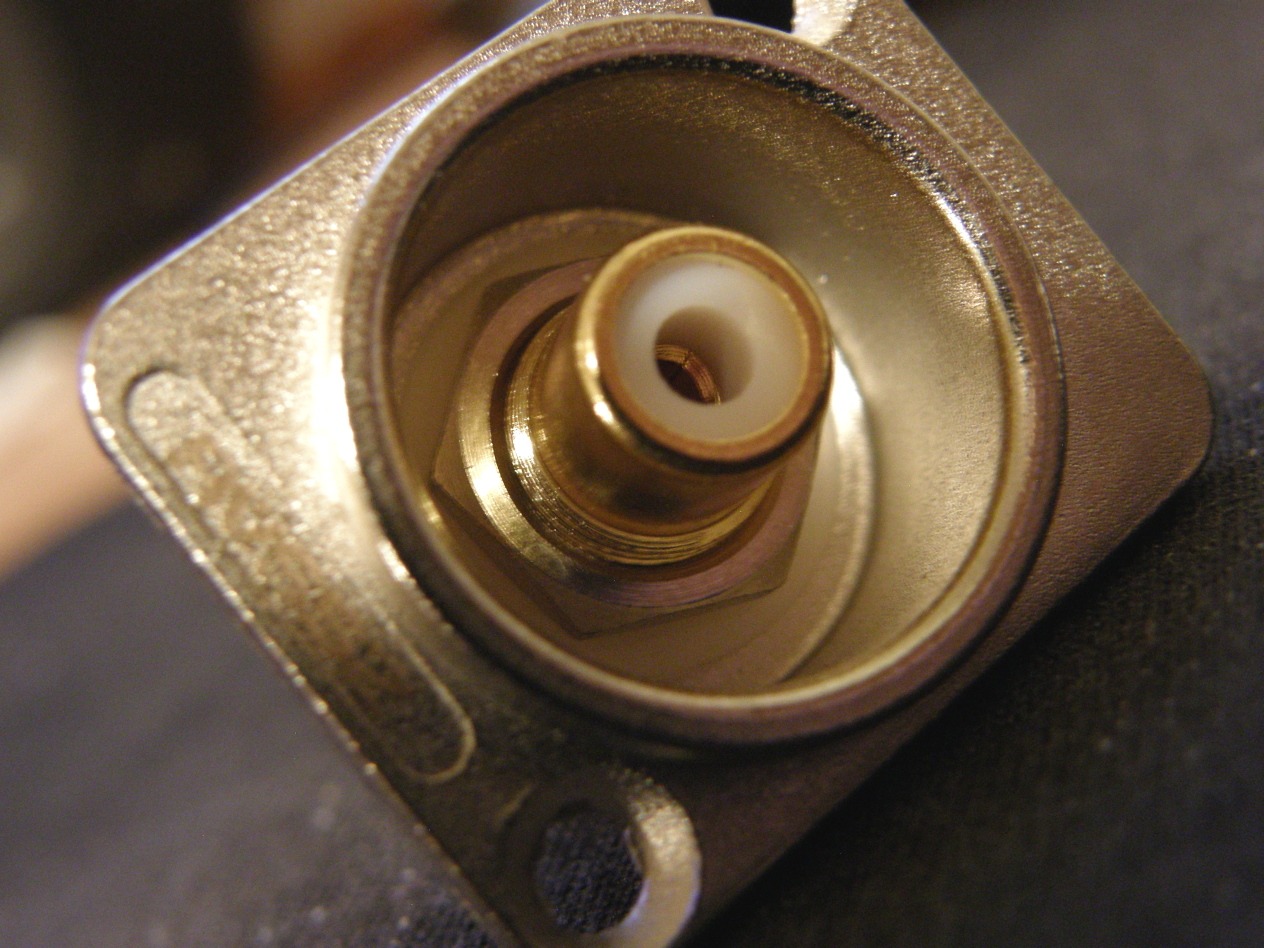

Because the actual barrel size of RCA jacks is all over the place, I had to increase the size of the hole in order for the Manley step washers to fit (that may not be needed with other jacks). Manleys are larger than others out there and so you end up with a 1/2".
So to answer your question, no these were not blanks (though I wish they were). These came with installed jacks that are junk. Yup, the ones that will take solder very poorly before melting the inside insulation of the jack. So they all ended up in the trash, and that is where the drilling began. Pretty soft metal. With a drill press and vise, it is child's play, but watch for wandering of the step bit anyway.
When it is all said and done, each Manley/Chinese drilled blank jack will run $8-10 each. >>If instead, you order Neutrik jacks in the first place, they run between $6-8 each, depending on color. For a guy like me, only black oxide bolts will be used (they do not come with either brand of jacks), and adding to that the cost of hex nuts and internal star washers, the total cost is more but i haven't calculated it in.
