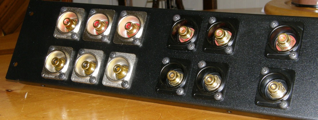

Thats to badThen I like my preamps like I like my politicians.

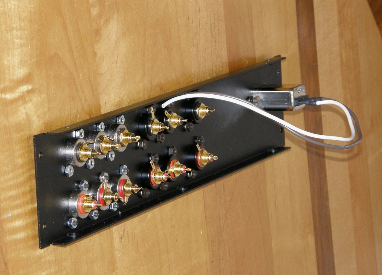

And surprisingly, they don't take solder very well. hmmm.
Neutriks are soldering as charm, with proper tip size
It's a matter of preference, but I much prefer soldering the wiring to the jacks before installing the jacks. I install them from the 'inside'. To me, it looks a little cleaner. Most important (to me) is that it's much easier for me to keep the input/output wiring shorter / tidier and easier to install without trying to manage the back panel.One step closer. Today the rear panel(s) arrived, and I got to work. These jacks are more trouble to mount. And surprisingly, they don't take solder very well. hmmm.

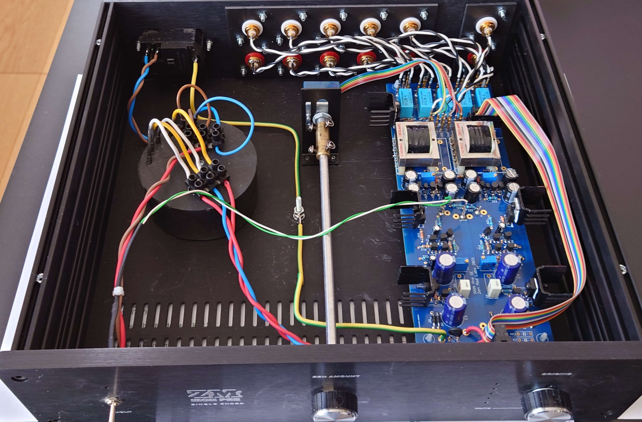

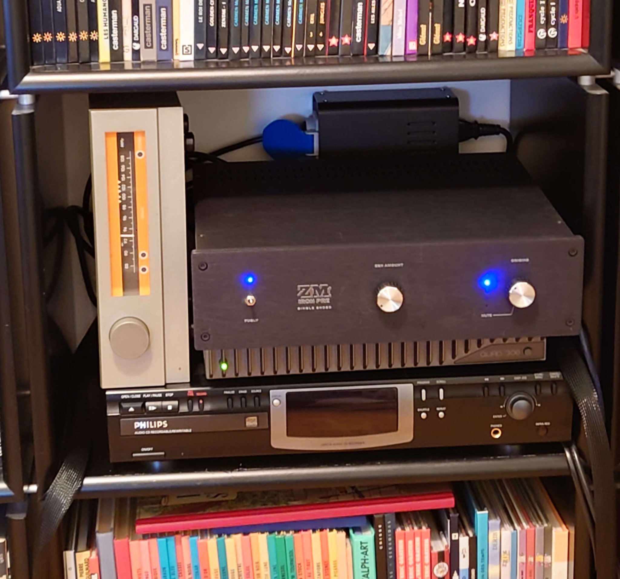

My Iron Pre SE is ready now: I listened to it yesterday night for a few hours, and I must say, I'm really delighted about it.
The Iron Pre sound very natural and airy: wood and brass instruments sound very natural, as well as piano; voices are phenomenal! Even electronic sounds are clean and pleasant.
I listened to tunes from Joscho Stefan, Patricia Barber, Philip Catherine, John McLaughlin, Johnny Cash, Terje Rypdal, Malia, Rodolphe Burger, The Clash, Pink Floyd. All different kind of ensembles, recoding techniques. In all cases, Iron Pre was perfect!
I had connected the Iron Pre to a Quad 306 power amplifier, connected itself to a pair of Davis Balthus 50 speakers. On input side, I had connected a Philips CD-Player and a (DIY) streamer (in the Quad FM2 case). All connected to a mains filter. It replaced my Quad 66 preamp, which I usually use for my office stereo set.

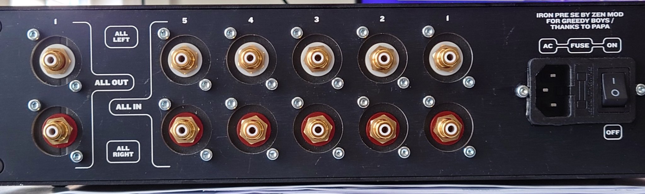

I mounted the RCA socket on a black nylon panel which I had lying around.

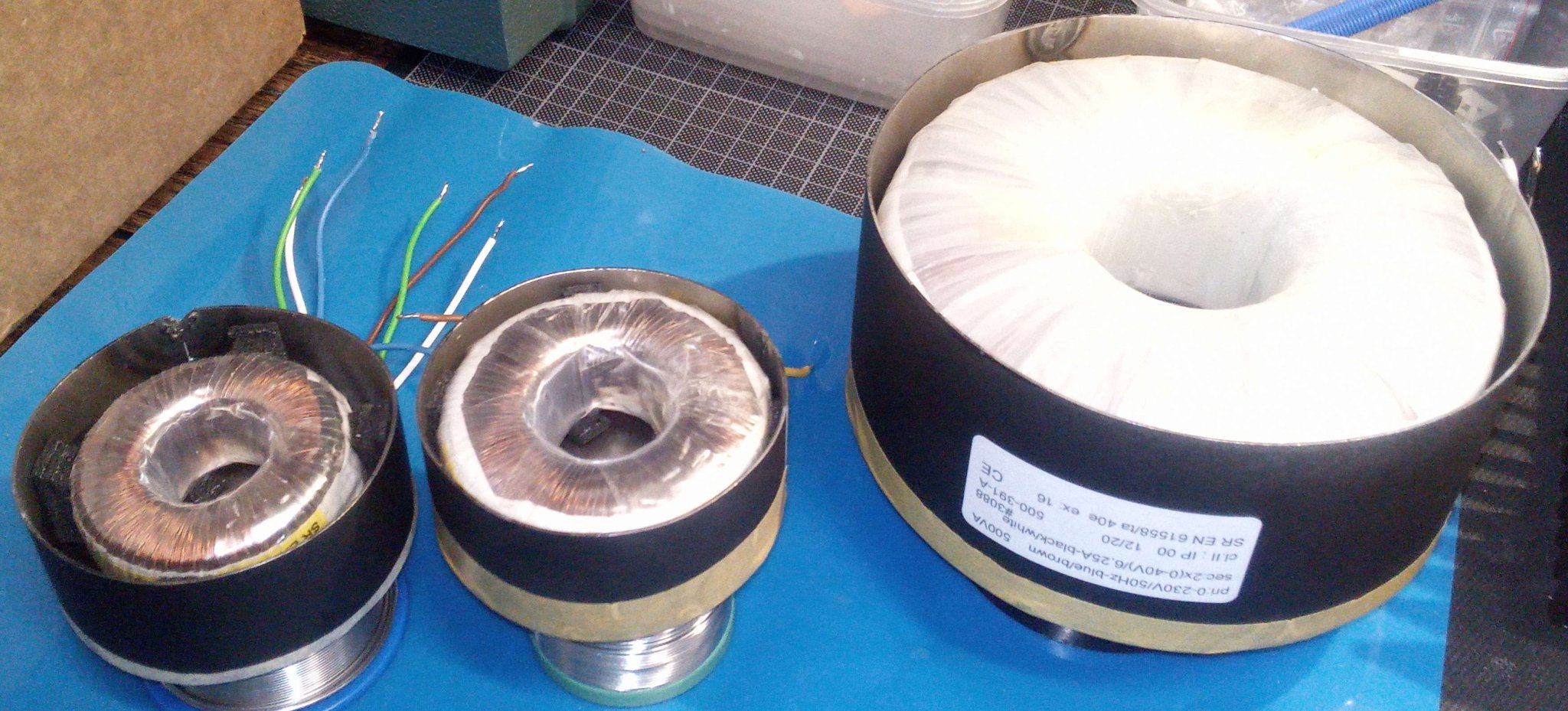

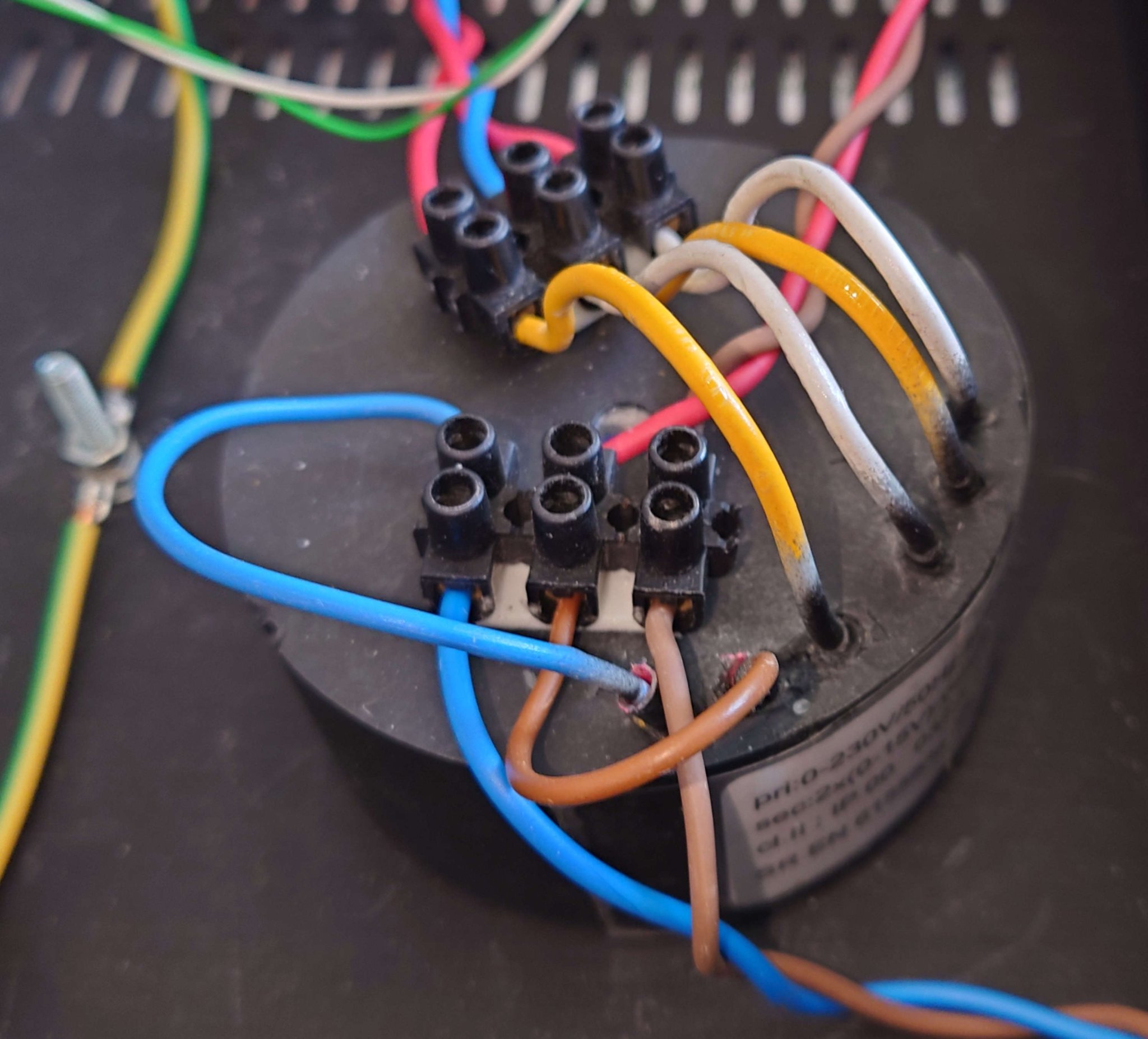

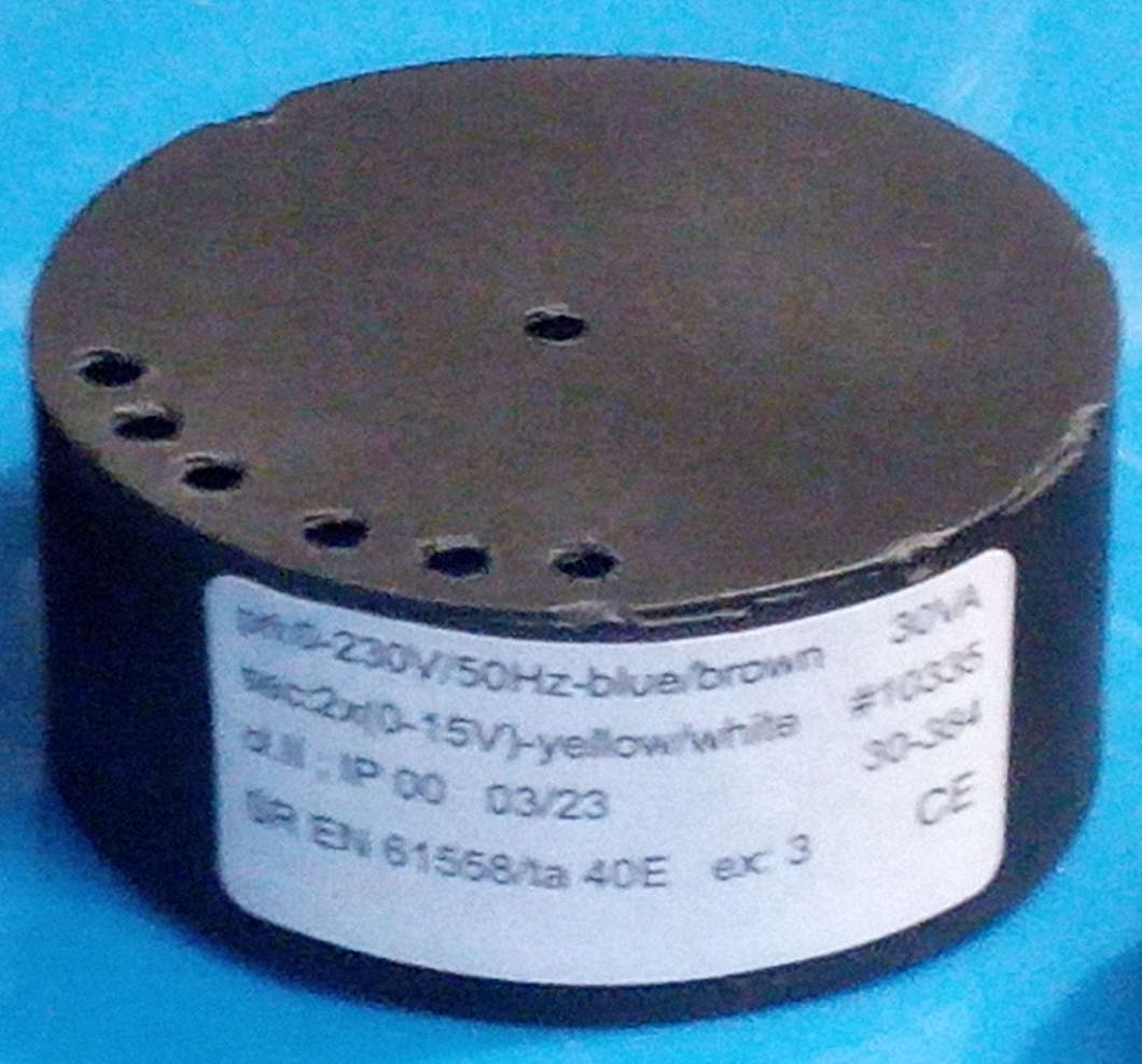

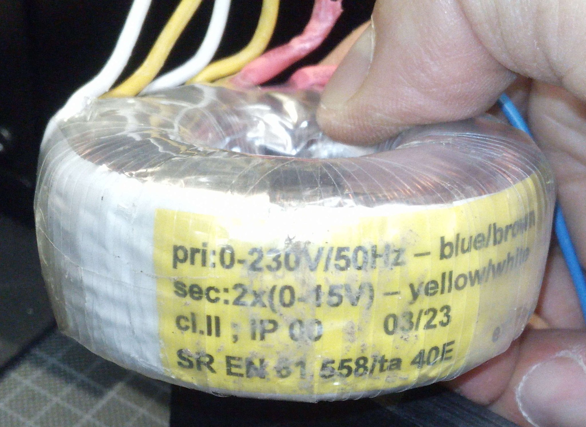

As it's a DIY project, I welded a trafo case from sheet metal, placed the trafo into it and filled the whole thing with epoxy (don't ask what a mess that was...). Finally, the trafo is screwed from the bottom with a nylon screw (I found some in my parent's house - I guess from swimming pool stuff).
Thanks a lot to you Zen Mod, and to all the contributors and last, but not least, to the gentlemen running the DIYaudio store.
Now I need to build an adequate power amp: Q17 turbo and Alpha Nirvana and are waiting for completion...

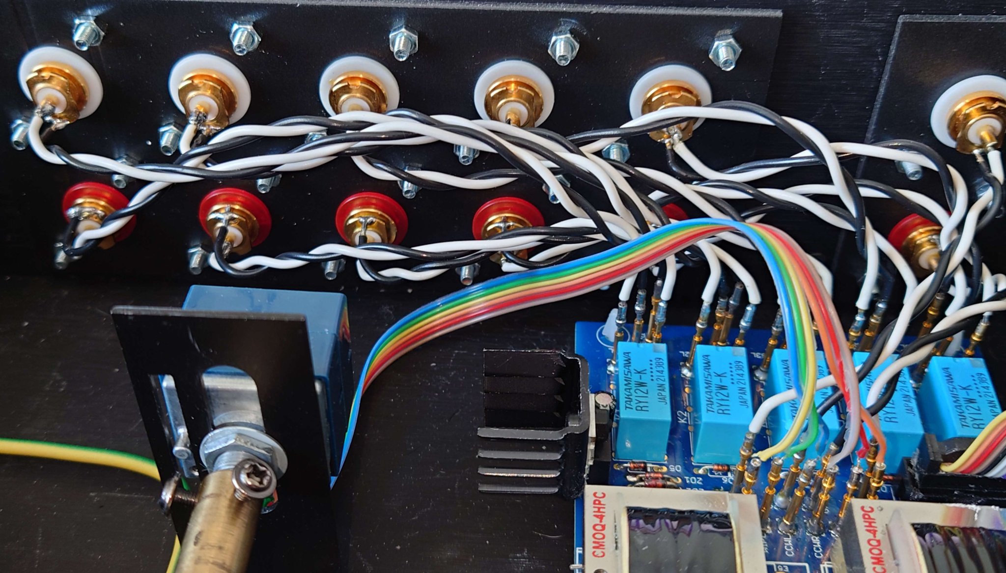

- signal wires (twisted pairs) still too fat

- take care to keep enough distance between Iron Pre and any nasty behaving mains xformer around

Thanks for the hint with the signal wires: I took what I had at hand.
Do you really think it's an issue? I even welded them on connector pins in order to allow for removal without deteriorating the PCB.

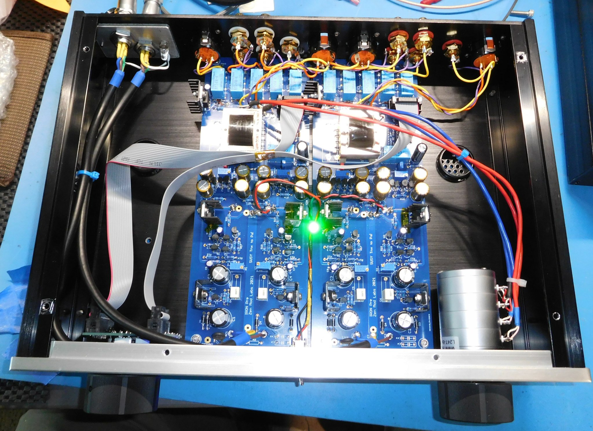

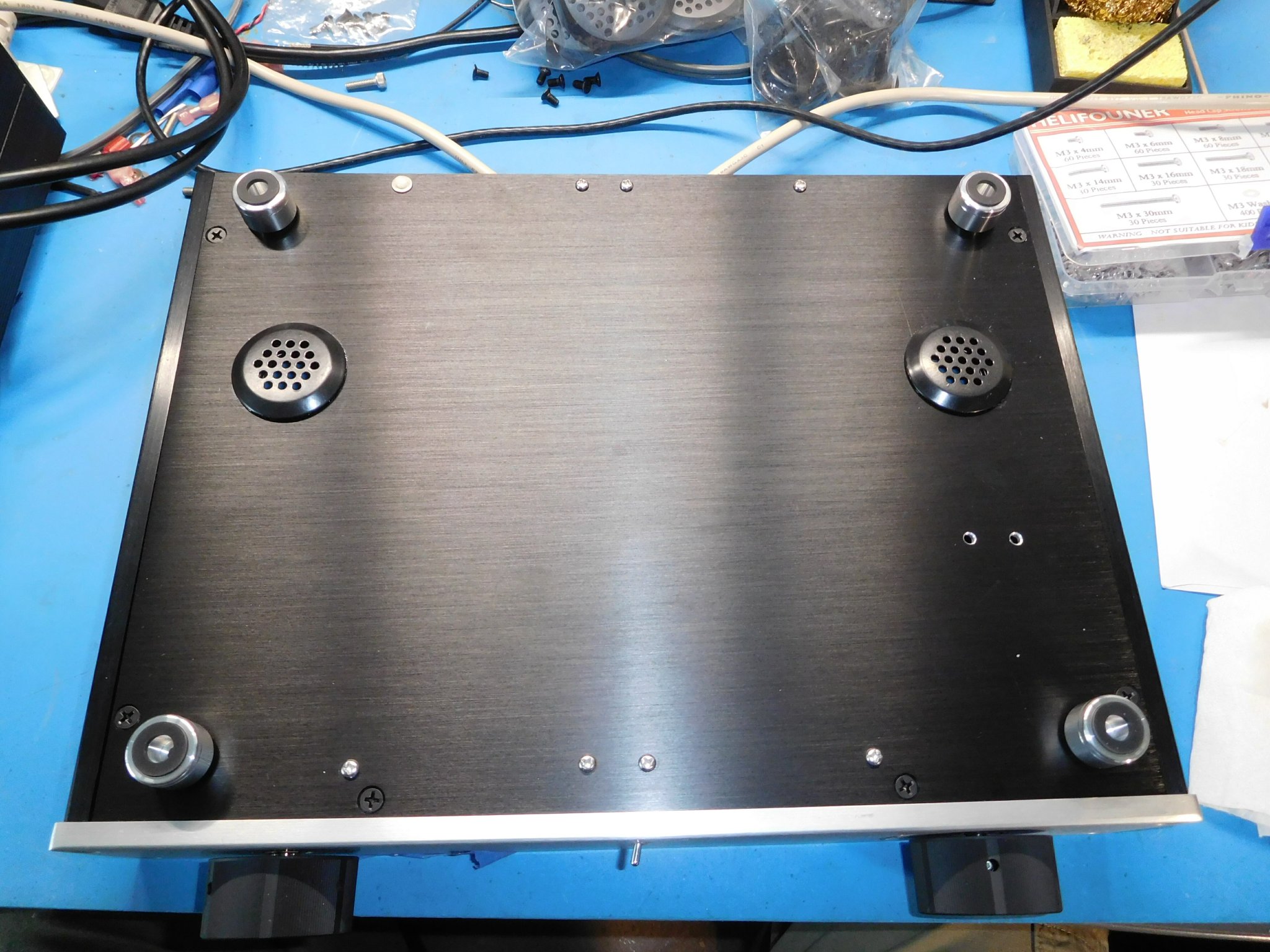

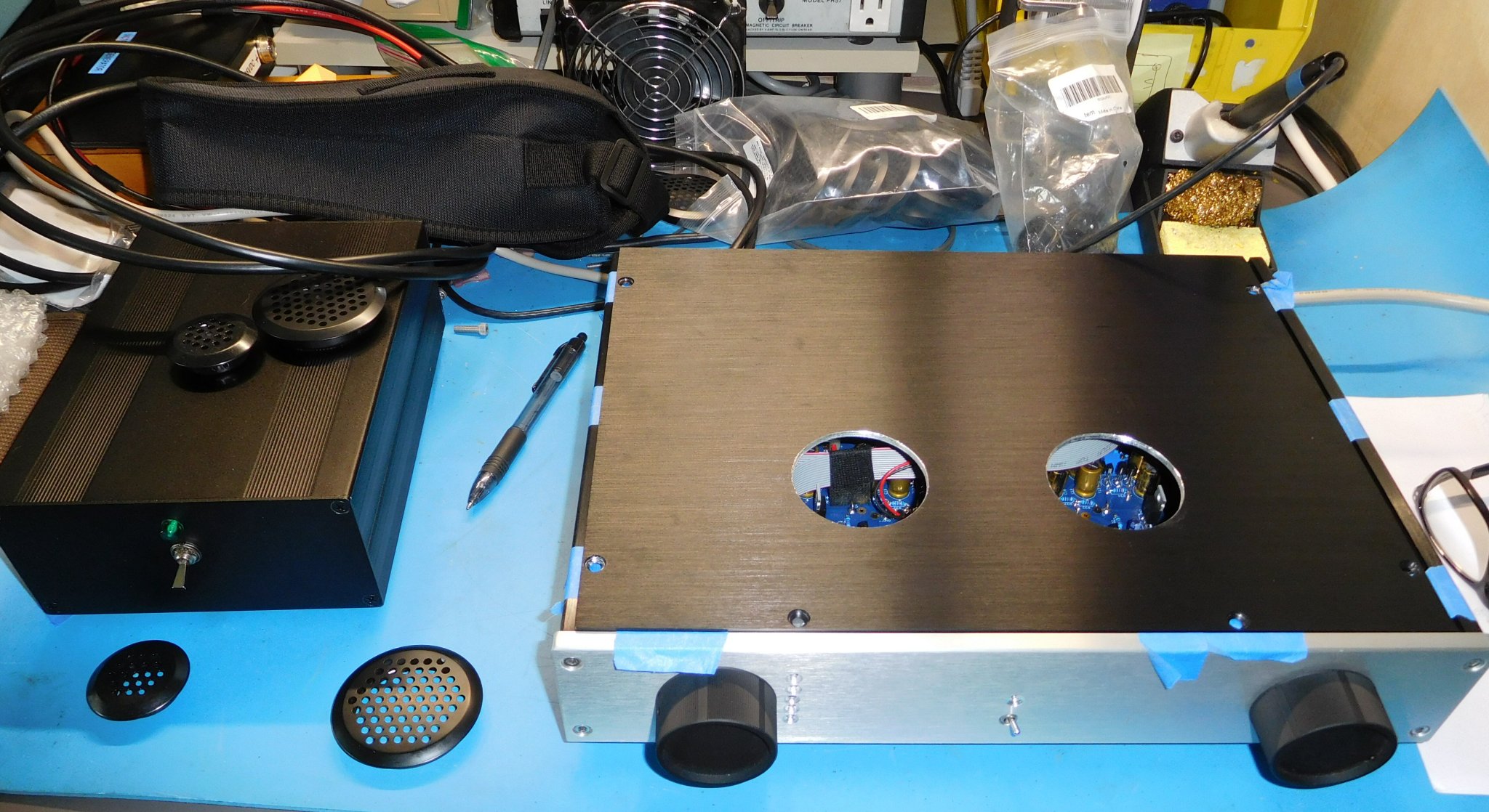

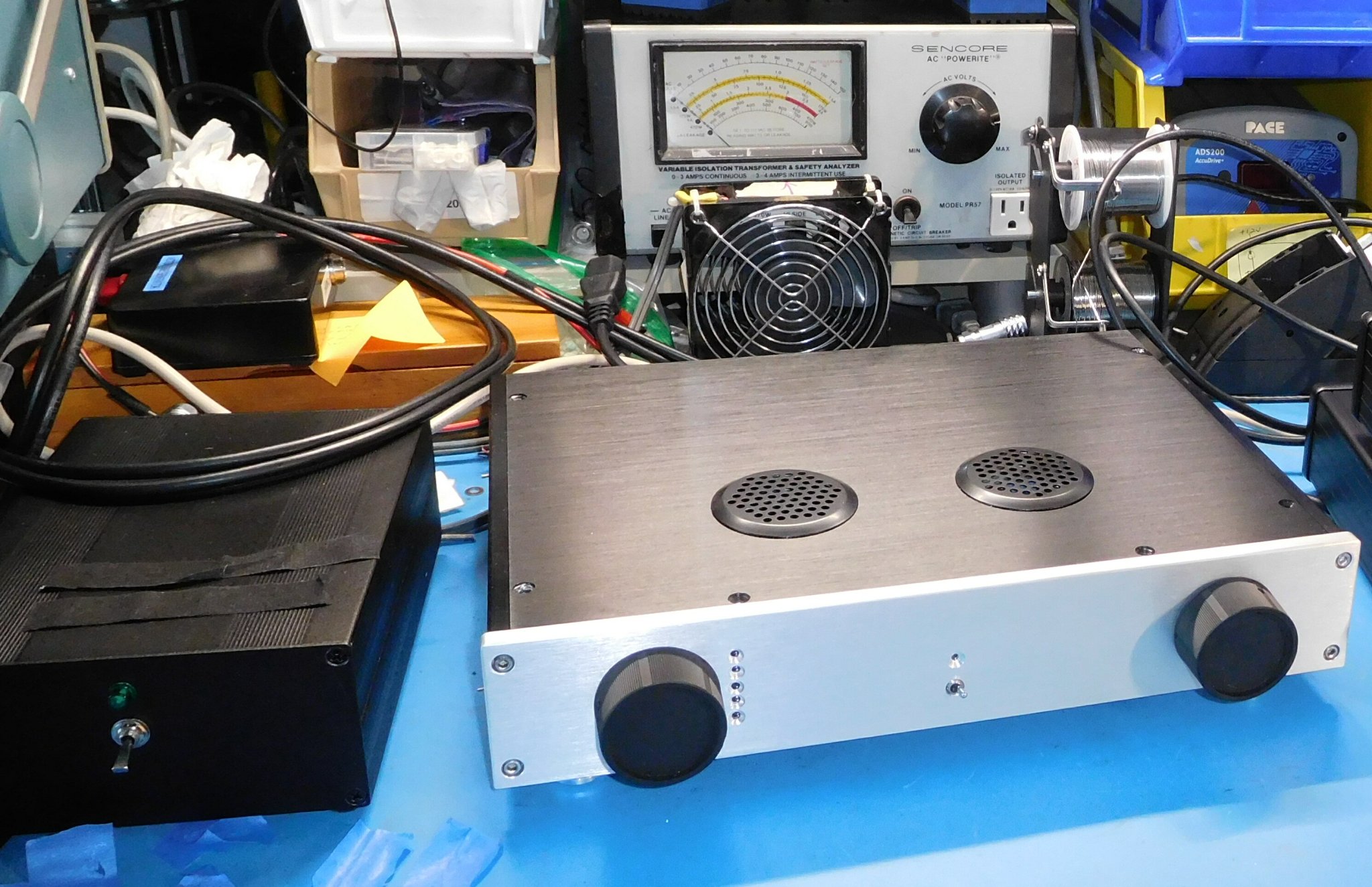

It's cool to see more of these getting built with all the variations.
I had made the decision to use a chassis I had on hand, and having done a lot of machining of the front and rear panels, decided to use it rather than buy the excellent project-specific one.
After a few hours of use I noticed the chassis getting warm, so I popped off the lid and measured the temperatures; the IRF parts were getting up to 95F, so I decided to install small heat sinks onto those parts (all other TO-220s had them already), and cut holes in the top and bottom lids for some round vent caps. Having a milling machine and proper carbide hole cutters exactly the correct size was a major incentive.
The entire unit is running cooler now, though I might increase the size of the heat sinks on M1 and M2 later.
not an issue at all
just my OCD having tiniest possible wires for signal
additional contacts - well, I wouldn't do that, but if you like it ....... again, matter of principle
one by one detail - not that much each one per se, but amass them several and suddenly there is a difference, in sound and sometimes even in longevity of actual build
