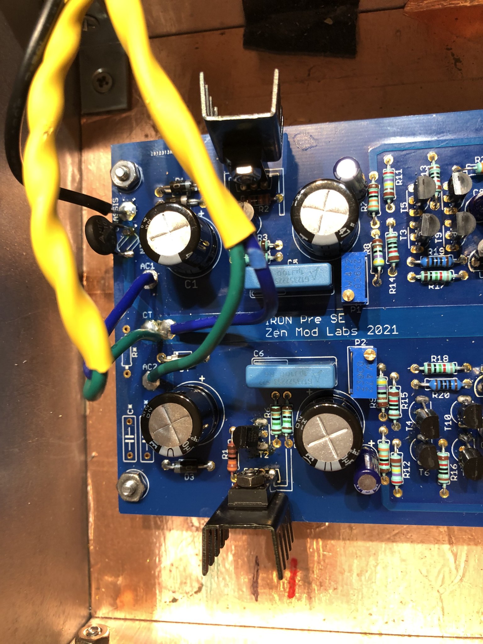

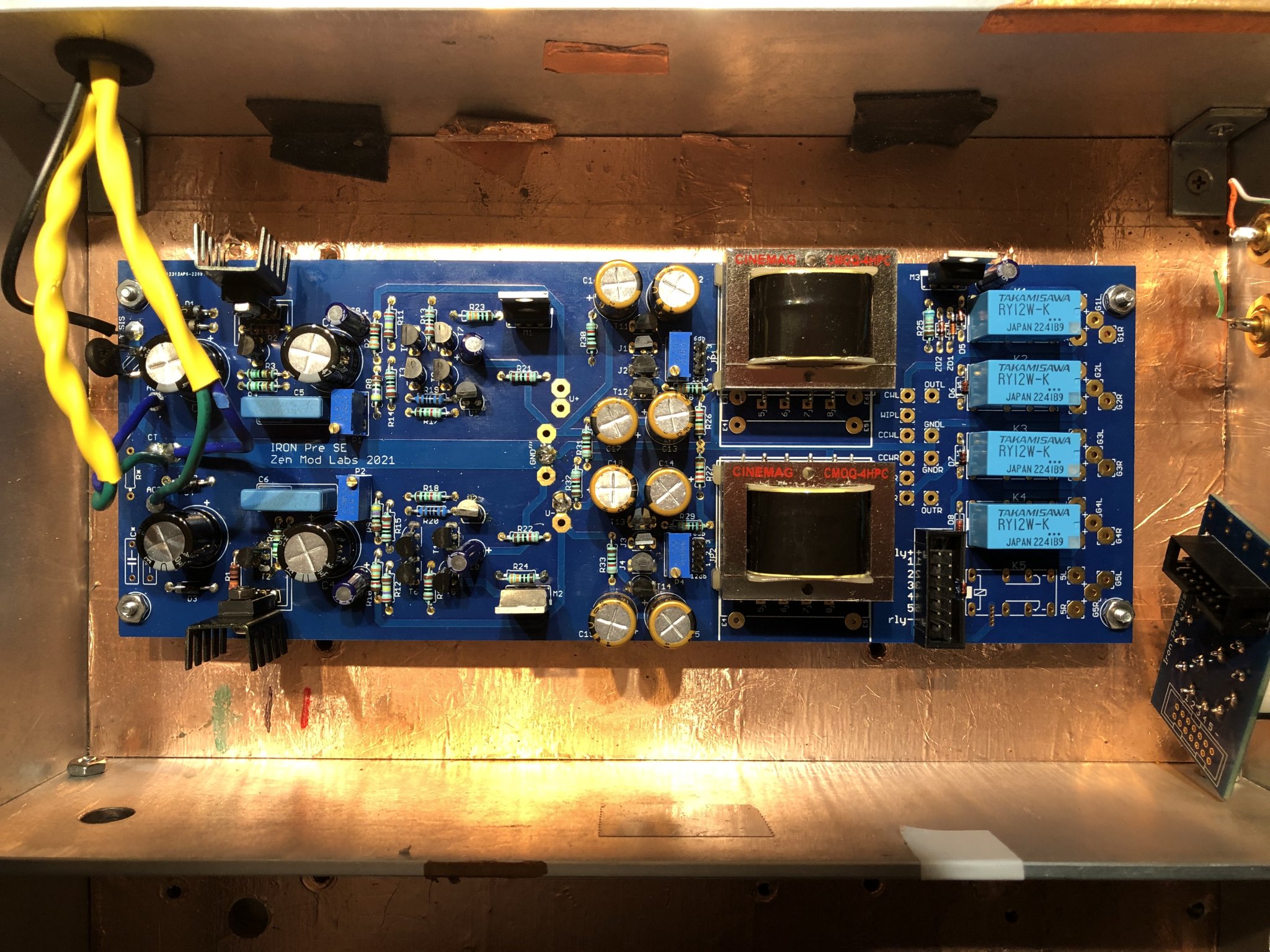

Houston, we have a problem. We got 19.5vac. Zero vdc. Trim posts do zilch. Where do I start checking?
it could help if you say where you got that
then I would say - post pics
I think it's a quote from Apollo 13. Either the movie, or the real life event. Just guessing though. I've been wrong before.

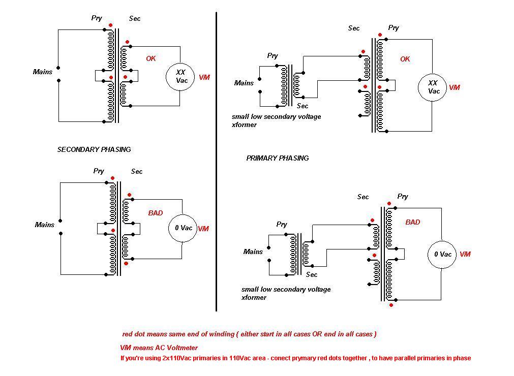

I’ll post some pics, after coffee thanks. I’m thinking I may have wired transformers blue/green wrong.The eay I paired them up was using a multi meter on beep. Beep beep made a pair.
gimme Vac read between:
AC1 to CT
AC2 to CT
AC1 to AC2
also, just for giggles - triple check placement of all active parts; I'm first one who made swap of BD transistors, same as IRF ones
AC1 to CT
AC2 to CT
AC1 to AC2
ok, that's good
parts orientation/placement checked?
take your time - stare at goats and schematic and parts placement paper and actual pcb .........
what you have now on test pads, on rails, positive and negative?
