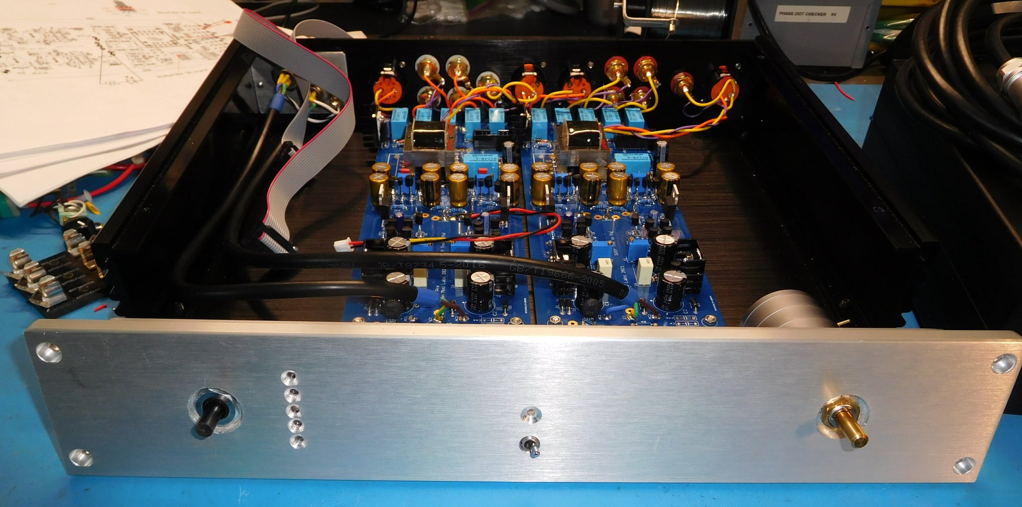

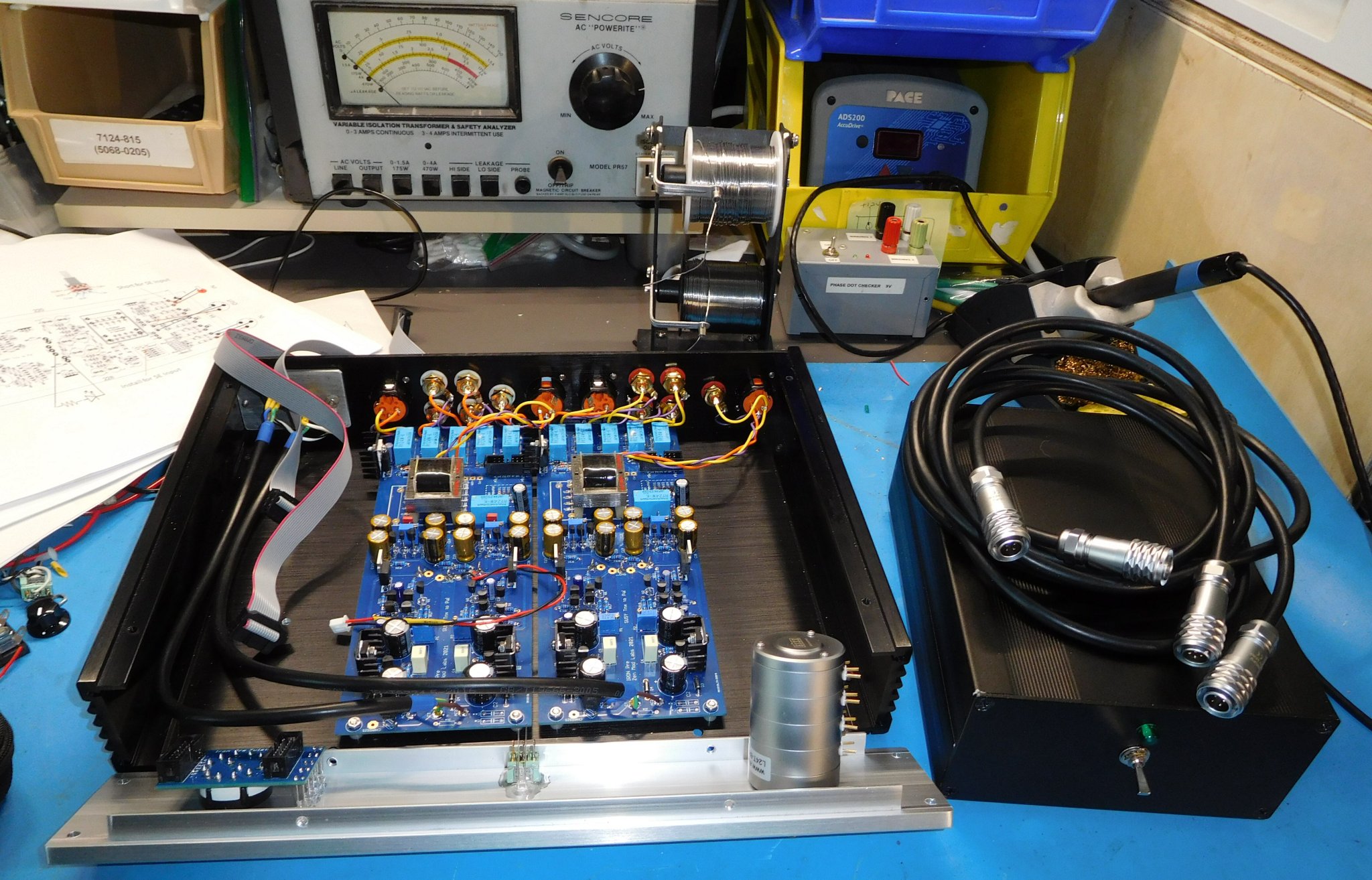

My balanced build has been taking more time than intended due to repair projects on some commercial amps and preamps, parts ordering (many thanks to @6L6 for giving me the rotary switch that was out of stock at the time!), and building a Pearl 3 (again with thanks to Jim for supplying several parts) and an Aleph 30 (thanks to @rhthatcher and 6L6 for lots of helpful guidance, help and recommendations)! I used Randy's excellent boards and matched transistors, as well as the recommended chassis, and it turned out great and sounds incredible.
During lulls in those projects, I completed the power supply and machining of the front panel of a chassis box into which I shoehorned both boards. Not as beautiful as Giancarlo's chassis for this project, but since I had already committed, it made sense to complete the build. Because space is limited, my choice was to use an EIZZ 4-gang attenuator which I'll wire up tonight. At first the intention was to use 4 balanced inputs and 1 SE, but plans changed so this has 4 RCAs and one XLR for inputs, and one XLR and one RCA for outputs.
@mkane77g - I used two AN-0218 transformers in a remote box, also a tight fit to keep the package size down.
Smoke test was today (passed), and hopefully tomorrow I'll have voltages adjusted, everything wired up and tested, and this bad boy in operation.
Many thanks to @Zen Mod for the intriguing design and all who are involved in bringing these kits to us!
