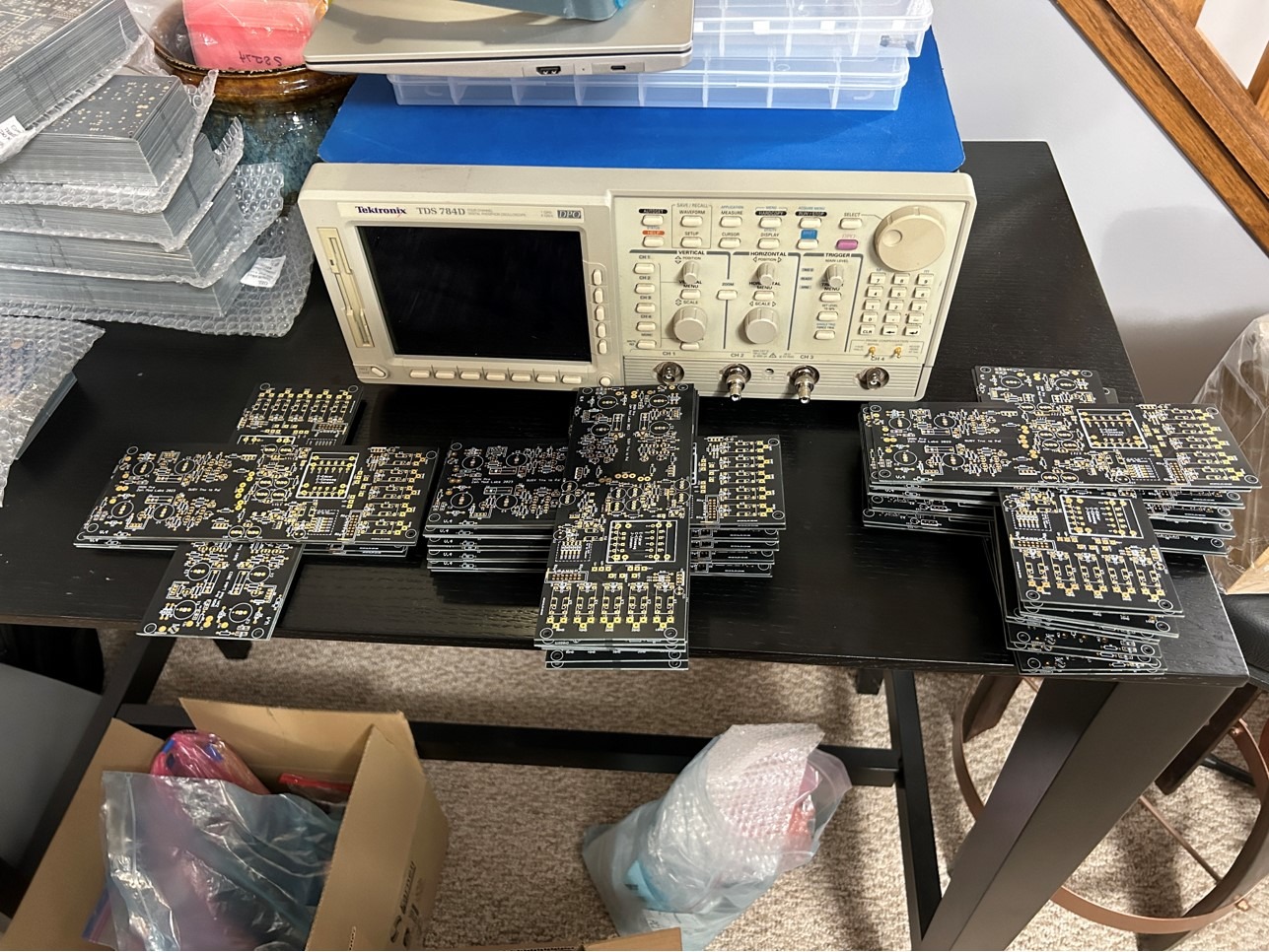

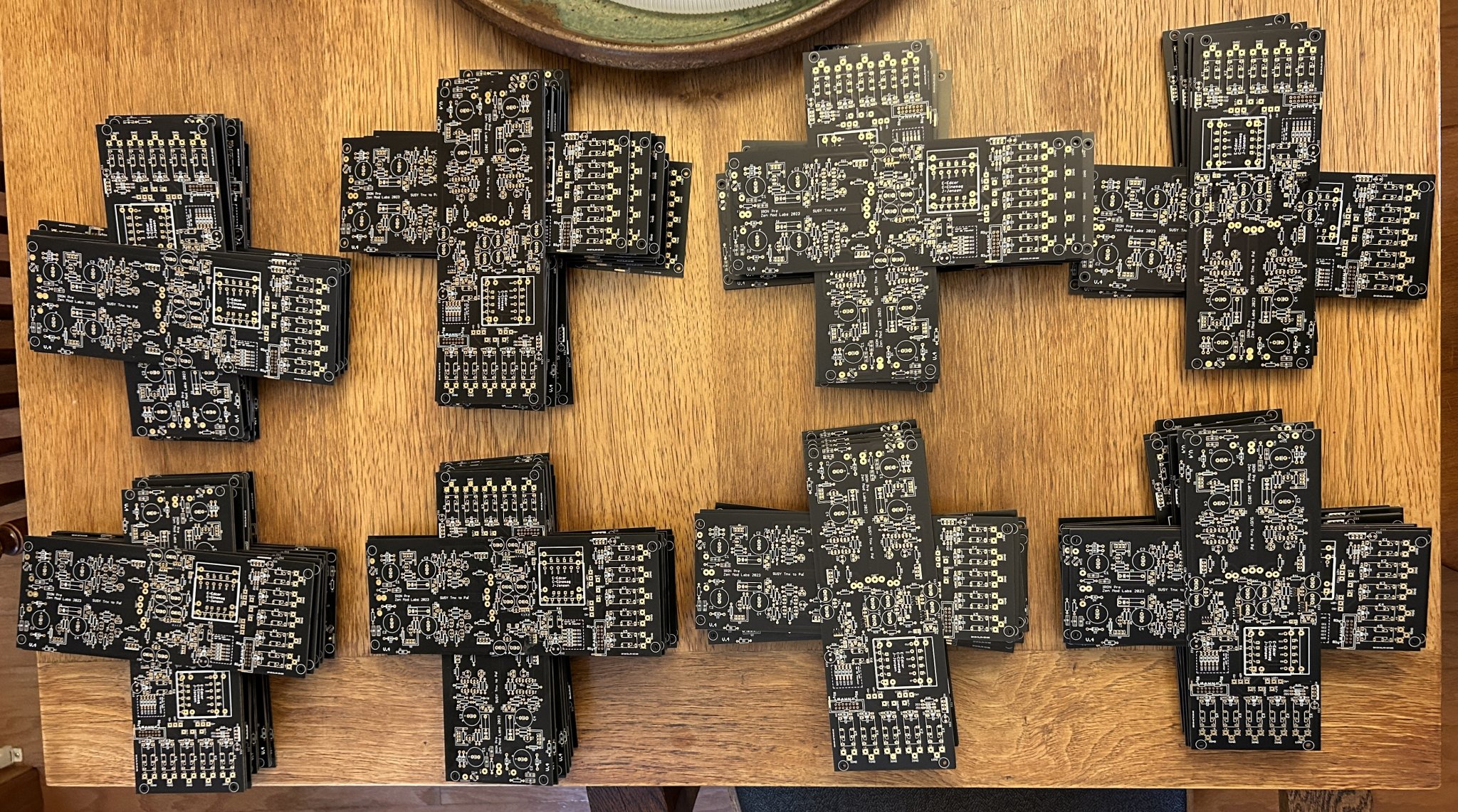

I'm steady plugging away. All the initial validation is complete, and we're into "production". It sounds amazing, IMO. It measures extremely well (previously shared). As of this morning...

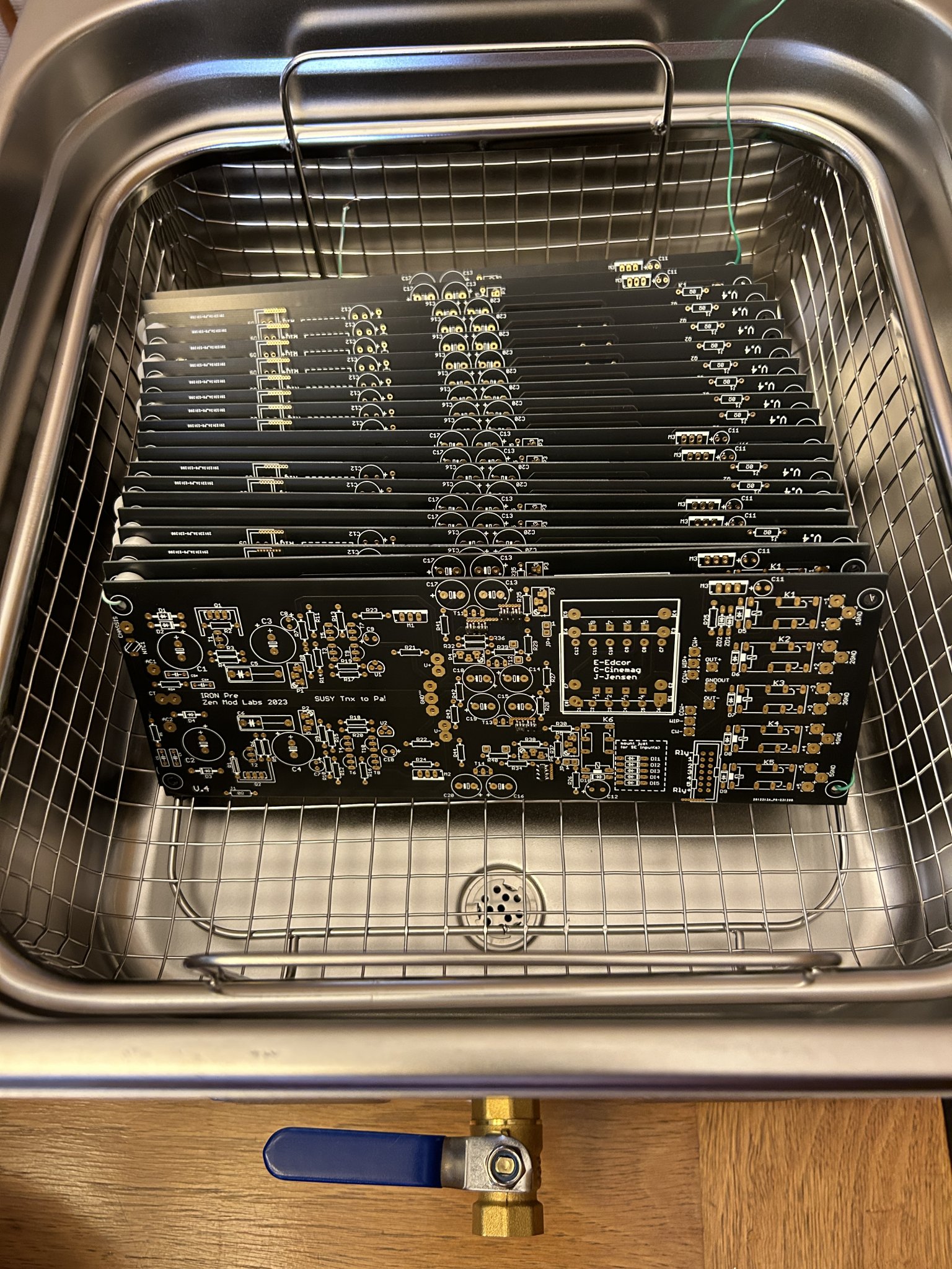

Well... here is a recent picture (an hour or so ago) of 150 balanced boards (6000 solder joints) ready for their bubble bath... Yes, I use no-clean flux, but... I like shiny boards, and I get dish-pan hands.
