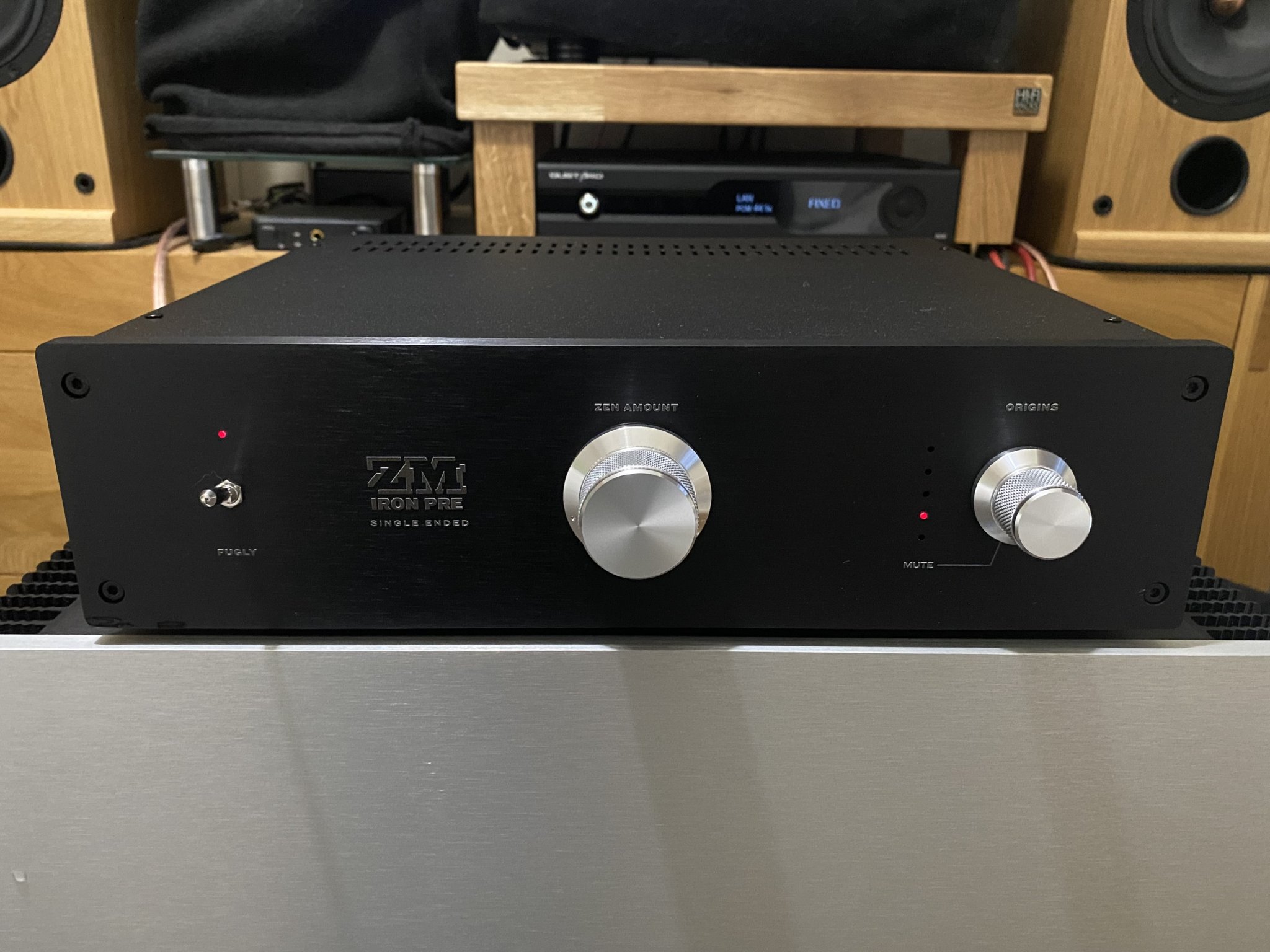

it seems half of your fun was with that not-so-flat cable ......
btw. nice detailing with heatshrinks
Fugly!
Fugly!

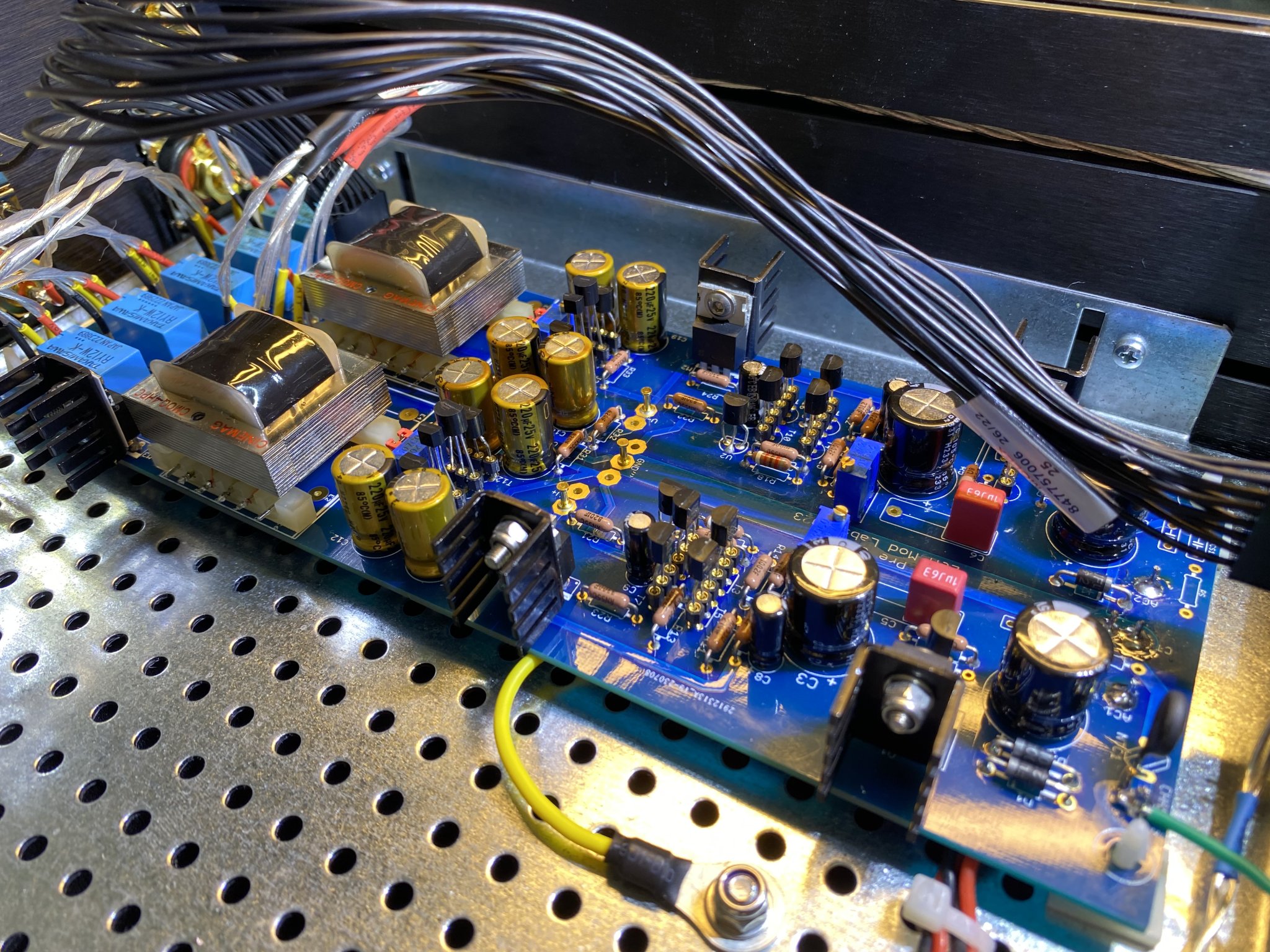

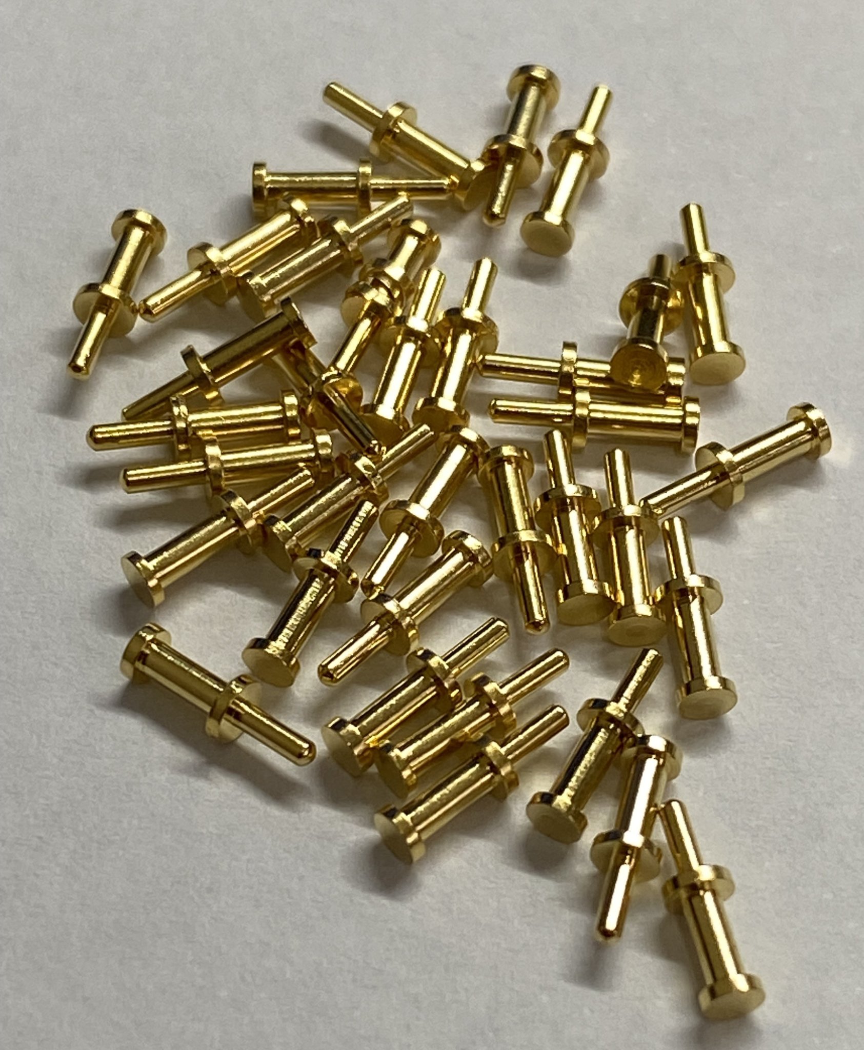

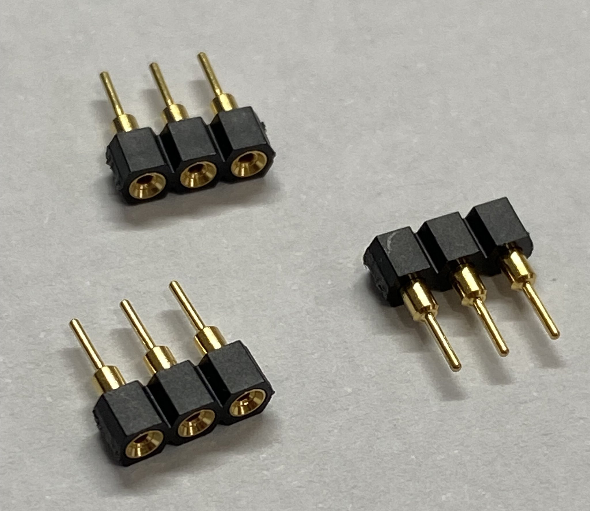

What are those test point posts called? Same question for the blocks that the transistors plug into. Do those use a set screw?Just completed my Christmas project. Throughly enjoyable build and excellent sounding preamp.
Big thanks to Zen Mod.

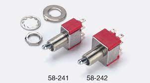

I have the balanced unit. I want to be able to use two inputs: one XLR and one RCA. So I will use two relays per board. Instead of using the selector switch can a toggle switch be used to switch between the two inputs? How many pole toggle switch would be needed?
2 position miniature toggle switch
1 section - for SE, left one on pic
1 section per board - for Bal, right one on pic
The test pins are Multicomp TEST-22. They are excellent for clipping your test leads to leaving you with a free hand to dial in the pots. Datasheet attached.What are those test point posts called? Same question for the blocks that the transistors plug into. Do those use a set screw?
The IC sockets are Omron part number XR2C-0311-N. Invaluable for enabling you to correct errors (the number of times I’ve put things in backwards) and allow parts to be swapped between projects. As you install the IC in the socket try not to apply too much pressure and things can go sideways pretty quickly.
Trick to installing both flush with the PCB (without getting your fingers burnt) is to push down with cotton wool buds (Q-tips) while soldering (no screws required).
