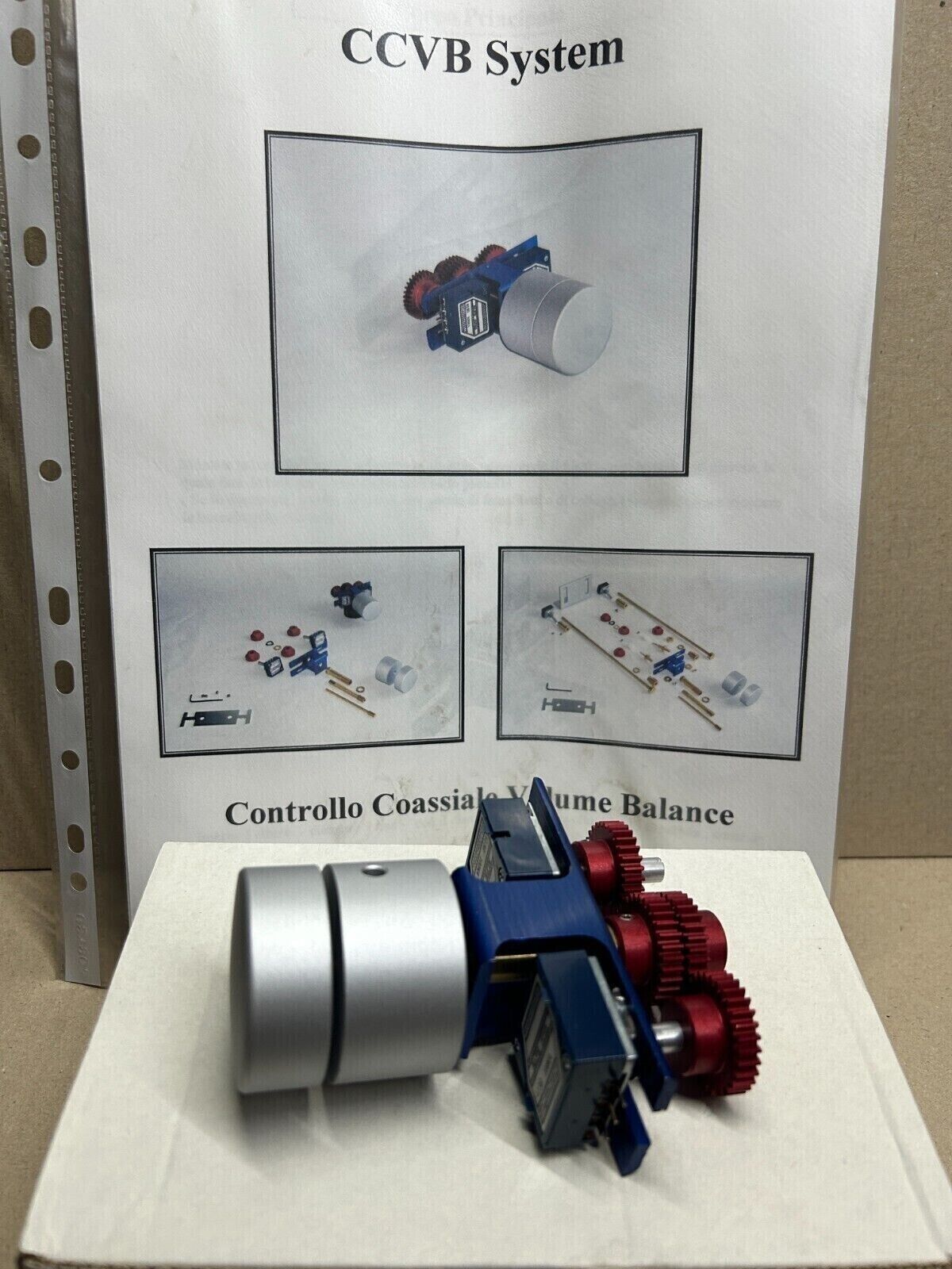

Needed parts will arrive shortly. I just couldn't help myself by ordering yet another stacked mono volume control, complete with gearing to use for volume and balance. This should have caught on long ago.
Had an interesting idea lately about using this stacked mechanical configuration. Yes, it is intended to be used a mono operation per each knob. That is what gives you the ability to have the balance of channels in an easy form. The 'what if' bug hit me and it is possible to abandon this thinking for the mono pots, and instead use the stacked figuration to control 'coarse/fine' stereo adjustment instead. One knob has coarse volume and the other a fine volume in smaller steps. There is the key word> steps, as in Stepped attenuators. Yes, yes this will involve more mechanical work and a different wiring of the stepped attenuators. Go to the Glassware Audio site and look at John's ingenious designs in different sorts of volume control situations.
Right now this is just a thought that started from wanting to use stepped attenuators instead of potentiometers. Nothing wrong there except that stepped units are fatter than the needed pots for this build. The answer then is to use rod extensions and reverse the resistor sequence in order to keep the audio taper. It is reversed since the physical position demanded for this design literally reverses the pots position, making the resistor arrangement necessary.
Photos to come to help explain when parts arrive. It twists my mind a little boys.
Just trying to be more clear about this little venture. The first photo is the mechanical gear setup for separate mono controls. The second shot is from Glassware Audio where each switch is used for either the purpose of coarse or fine adjustment. Yes, I know this could get tricky.
