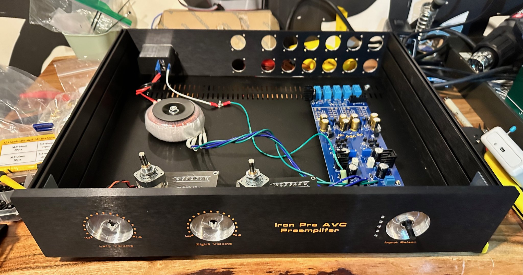

Twister/input select all working properly now. Here's the full build in progress.

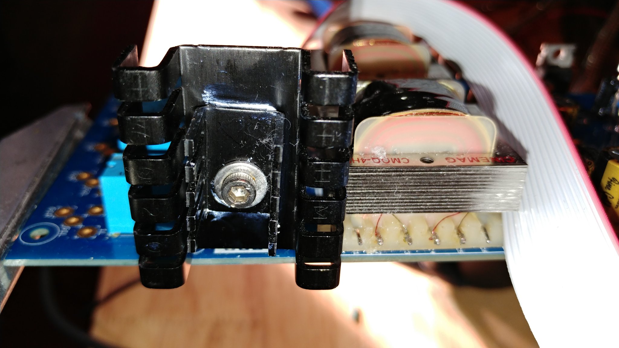

What might help is to reverse the direction that the fins of the heatsink point. Hope it works because I have also chosen the 12v. Haven't fired it up yet. A larger heatsink may be required. I wonder if two of these heatsinks could be used back to back?
They get hot... I wouldn't worry about it unless you intend to operate it au naturel, sans chassis, in the buff, in its birthday suit, etc.
Even then, it could be displayed safely and proudly with little to worry about unless unless you have inquisitive pets, friends, or kids. If you happen to be near a radio tower, I'd also consider 'covering up'... :rofl:
On a more technical note... the operating junction temp range can be up to 175C... so...

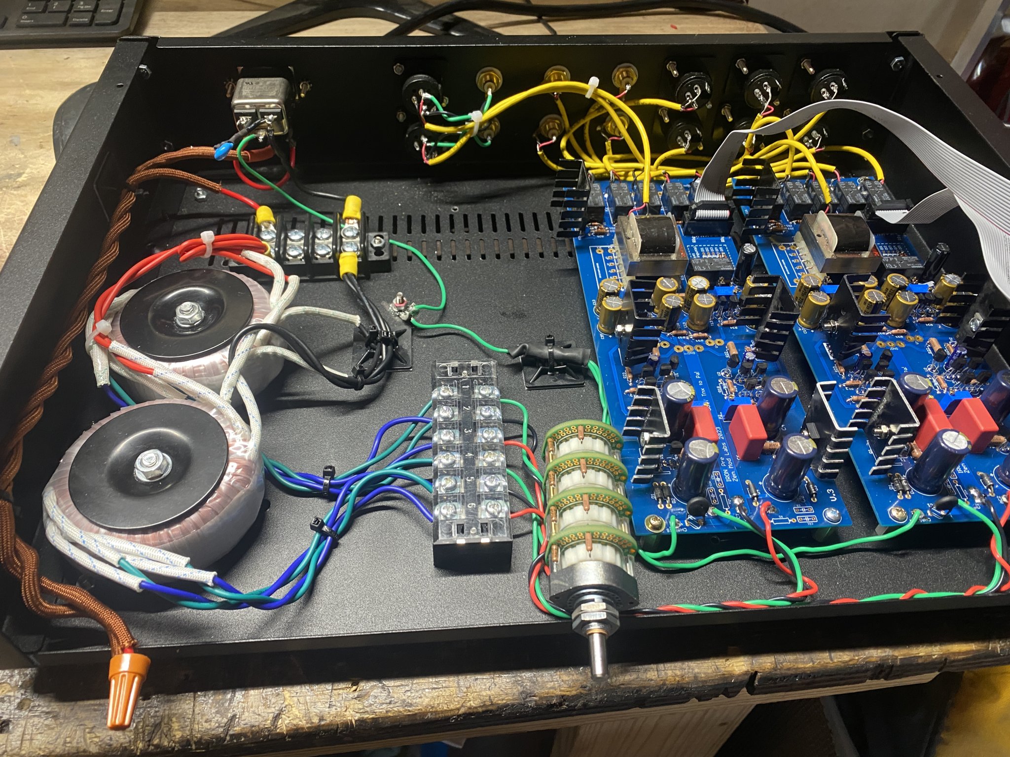

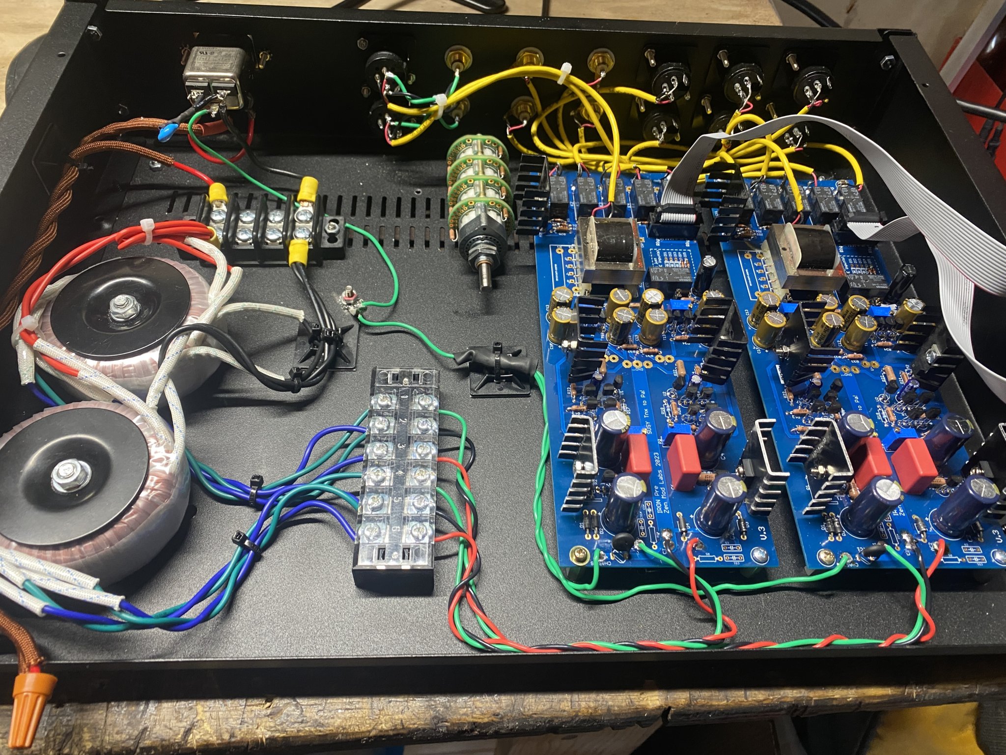

I reworked my layout and now have all mains and transformers to the far left and the two balanced boards to the far right. My only problem is now figuring out the Goldpoint.
Is there any harm placing it like in picture one or two?
I don’t have room to mount it to the front unless I move both boards towards the back of the chassis and I need to put smaller heatsinks on.

I sure do appreciate your photos of the build as I am busy building the SE version and trying to make good decisions about placement as well. Goldpoint is a favorite of mine when I can afford it, so it is easy to back your decision to use one. About placement. If in fact there were some sort of problem about placing the control on the front panel, you could consider using a shield around the switch. OTOH, if you decide to mount it toward the rear, that may alleviate the need for shielding should it have been required in the first place. If I understand this build correctly, the switch does not carry signal but simply tells a relay when to close or open. If that is the case, it seems that no real harm would come from the switch placement.
