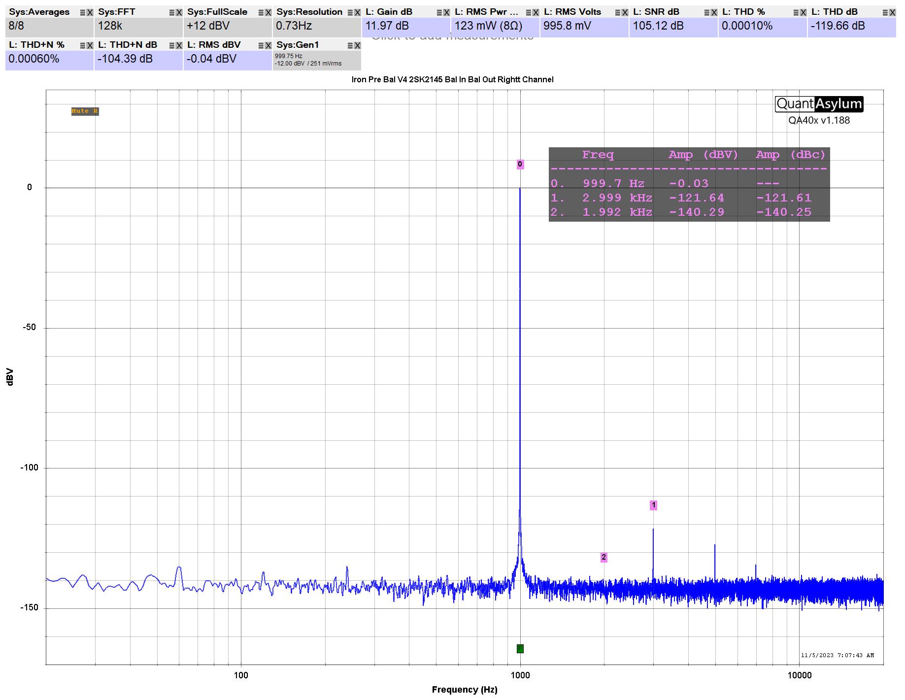

Here is a teaser. Posting b/c it relates to fun topic of 2nd / 3rd etc. Also posting to show once again ZM brilliance and to confirm others' thoughts that yep, it is 3rd dominant for balanced... I ran a range of input voltages, and when I can actually measure the distortion... it starts off as 3rd and remains 3rd.
This is prototype Iron Pre V4 Super Mega Deluxe Balanced. It's in a chassis hooked up properly. Next up for today's fun... some listening.
Anyway... Ignore generator voltage noted. It is actually 250mV for a positive signal and 250mV for an inverted signal. So, input differential signal is 500mVrms. Output voltage is correct at 1Vrms differential between + and - signal.
Balanced in to Balanced out...
Yes, it's quiet...

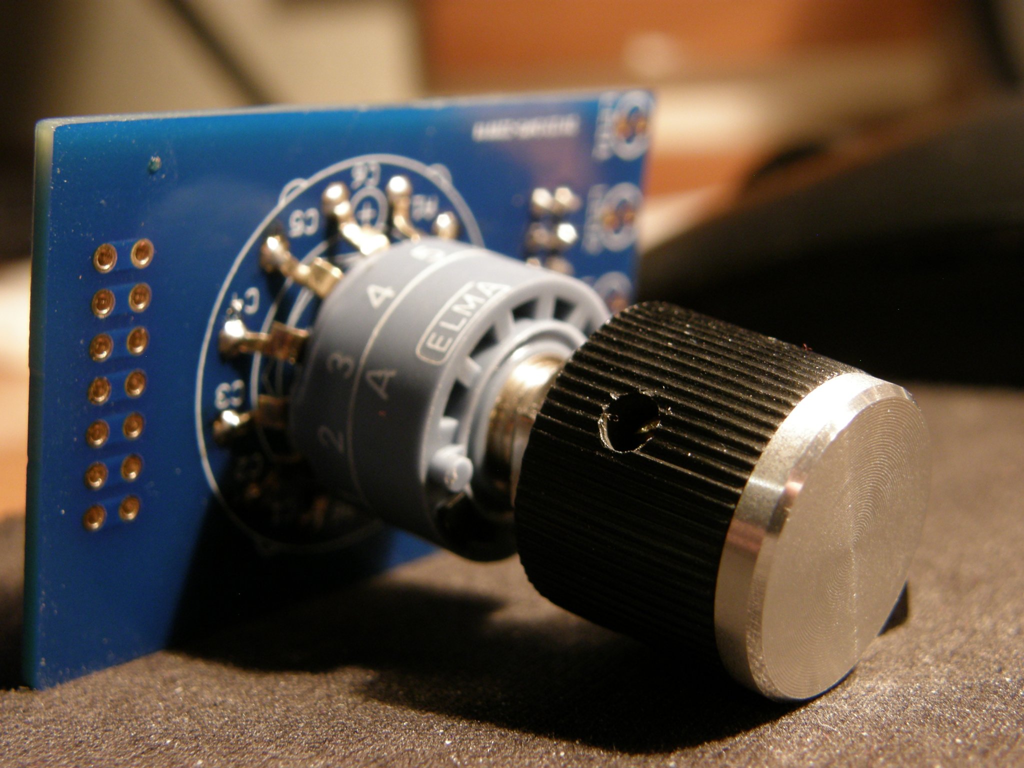

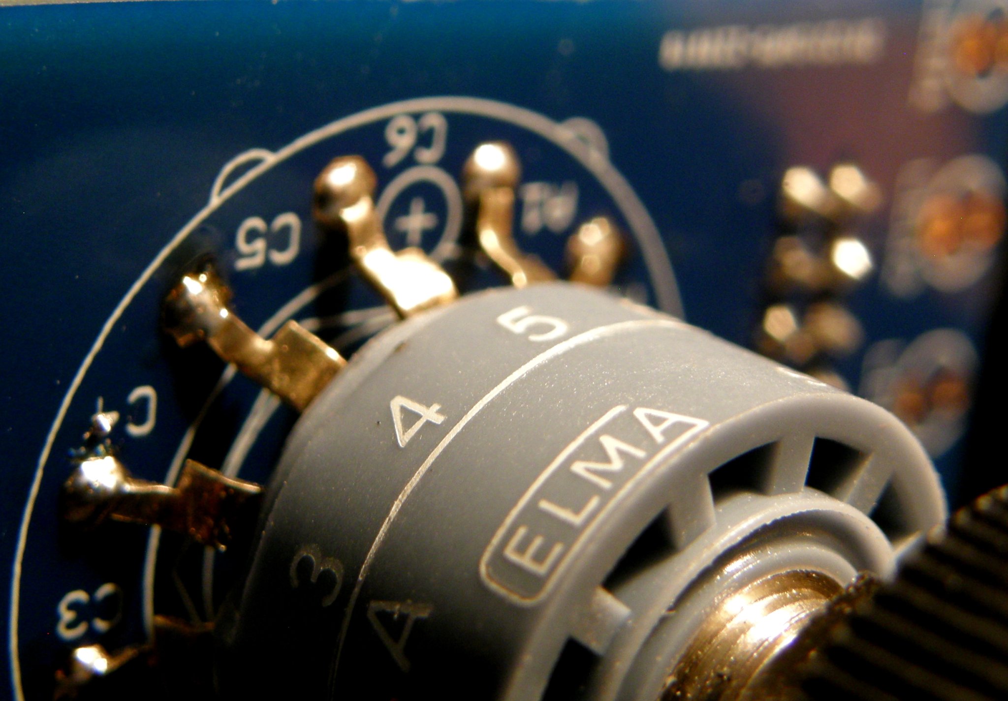

Ok, so I am thinking that I need a new Twister Board. Look at the connections. They are one off. Desolder? HA! Well, yes, I do have another Elma pot. This one will be destroyed when removed, and likely the Twister board won't look too good either. Interesting bends had to be made for this to work.
I can give you mine, but how to get it back over the Atlantic to you 🤷♂️So, Twister Boards. Are they available? Yes/no
Will be much cheaper getting one from someone in the USA.
Thank you for your replies. I am going to look at this closer because even though it doesn't look right, I just ohmed out the switch by position, i.e. position 1 on the switch equals corresponding number on circuit board (1-5). Also, I notice that on the circuit board on each side of the header location is a + by the number 1, and a - by the number 5. These appear to be connected to what would have been position 6 of the switch. I will take another look at the schematic to better understand what this means, but I know that it is feeding the LED string, correct?
As to why I used the Elma switch in the first place, it was a matter of having them on hand, and I got them for practically free. Because they have a 1/8" shaft, it became another reason to use them up in cases such as this, since 1/8" cool looking knobs are harder to find.
completely valid and logical - you had them, so opportunity was there
same as I had opportunity to pull your leg, couldn't resist
both Ry+ and Ry- are there on Twister, to enable LEDs
in first batch Switcher was distributing Ry+ to relays, second batch is changed, to distribute Ry-, matter of compatibility with logic circuitry (plenty of Boyz are Overgreedy)
