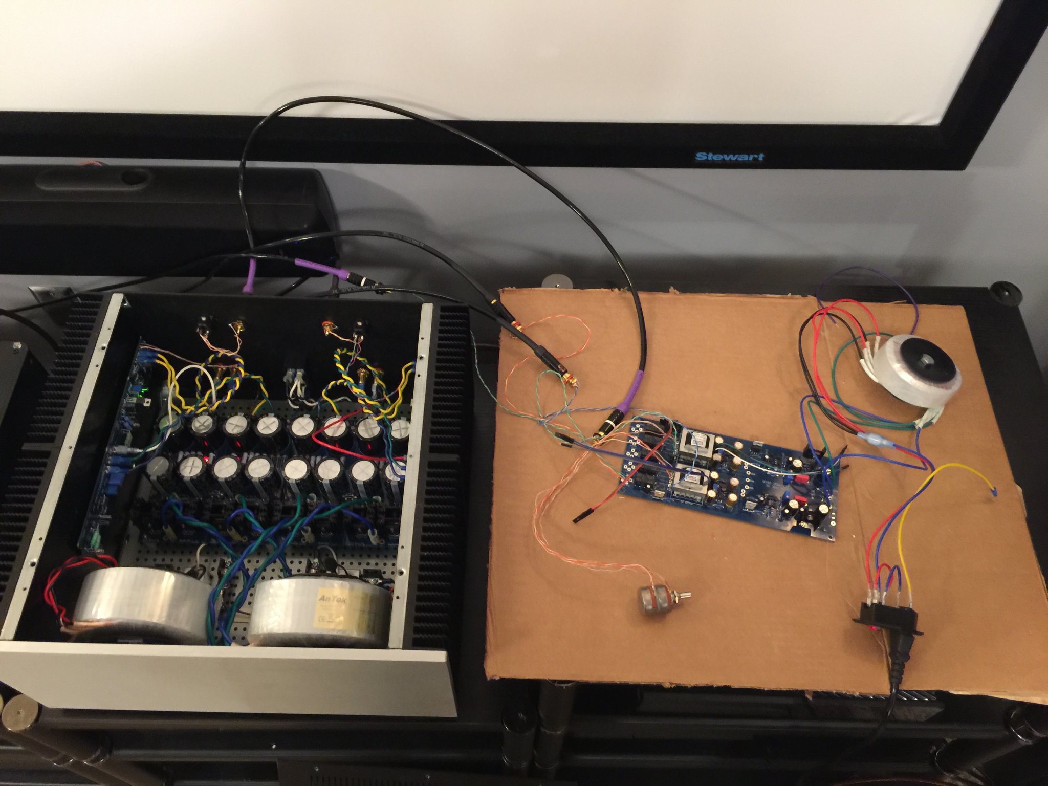

Hello, D10 is not marked on the board, but I assume it is the diode between K6 and C12. The balanced BOM shows D15 (separate from DI1 through 5), but I can't find a place on the board that relates to D15. Often I can't see the kitchen utensil I need when it is right in front of me. Is there a D15?
yeah, D10 sign lost under K6 overlayHello, D10 is not marked on the board, but I assume it is the diode between K6 and C12
there are no more diodes than D10
4pcs of rectifier type - 1N400*
6pcs of small ones, 1N448 type
then 5pcs small ones, marked DI1-DI5
I'm not aware of anything called D15
Those are the capital letter "I" not the number 1.
DI5 through DI9 are the diodes inserted for SE inputs. D10 is right next to C12.

Just so you can see my source of confusion, these two lines are copied from the balanced BOM pdf file:
7 D5, D6, D7, D8, D9, D10, D15 1N4148 1N4148 512-1N4148
5 DI1, DI2, DI3, DI4, DI5 1N4148 ONLY for SE IN 512-1N4148

Oops.... that's what I get when I try and work from memory... I should have just said the one's with the "I's" and think I for input.DI1 to DI5 are the diodes inserted for SE inputs
