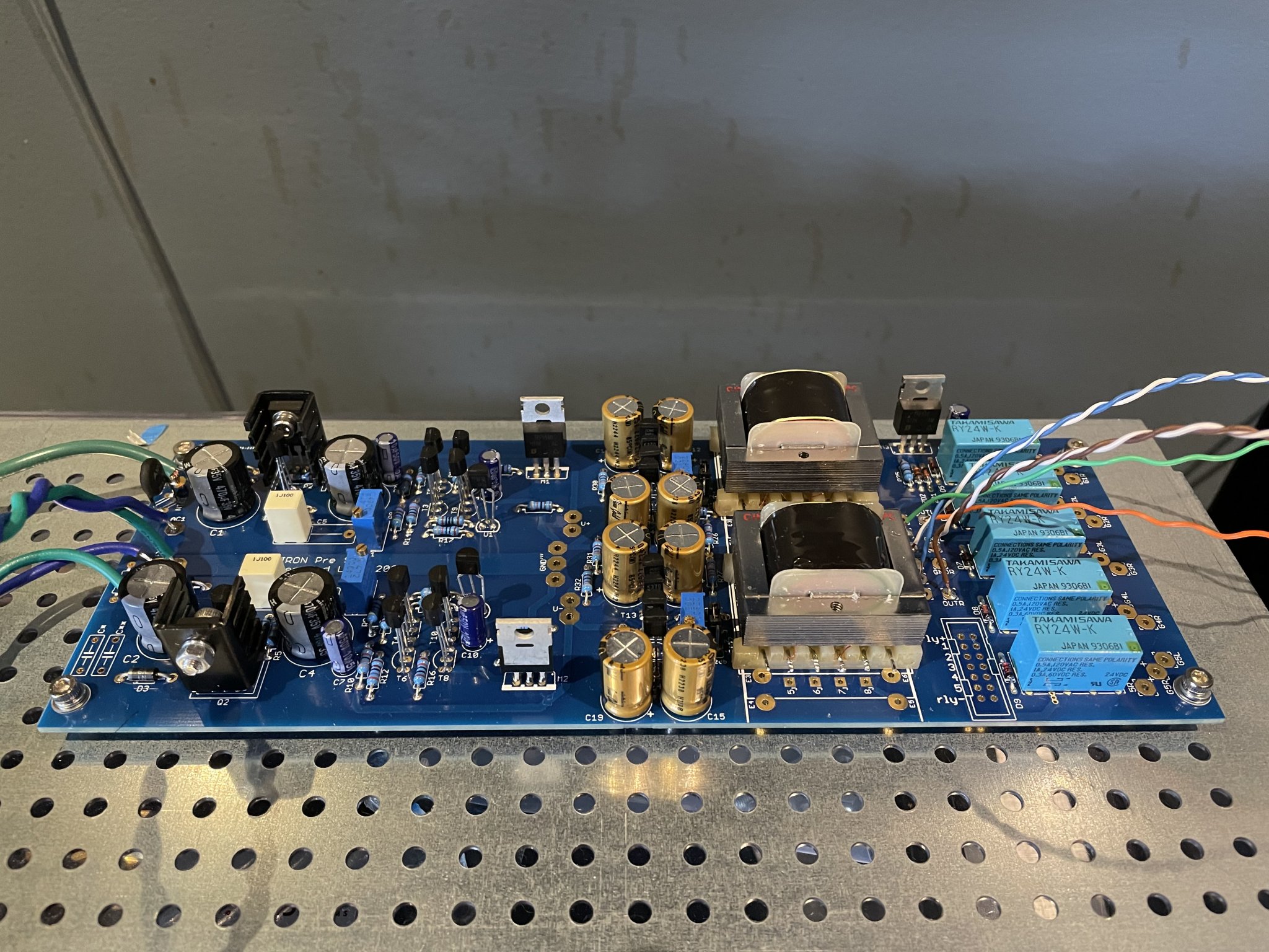

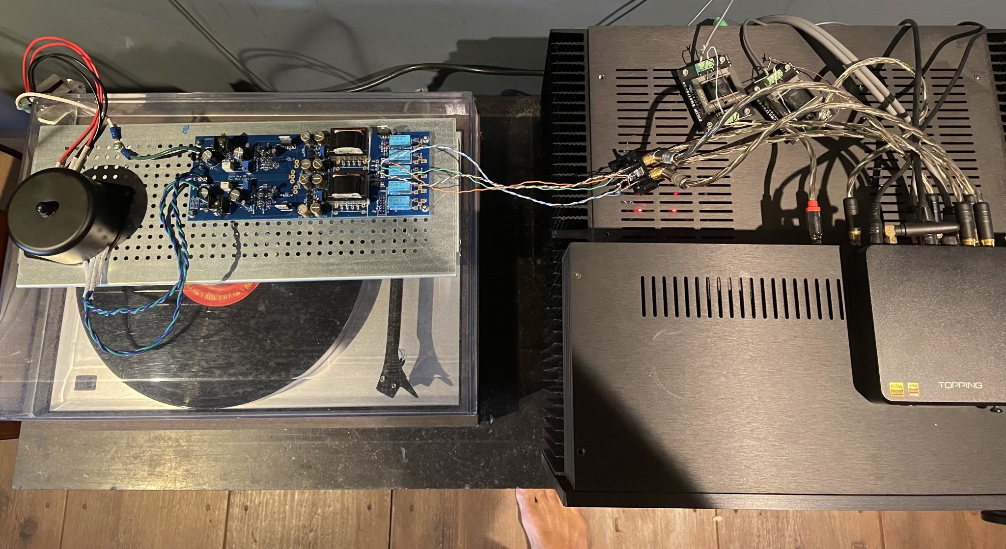

Another IP is alive and playing music. Thank you ZM!
