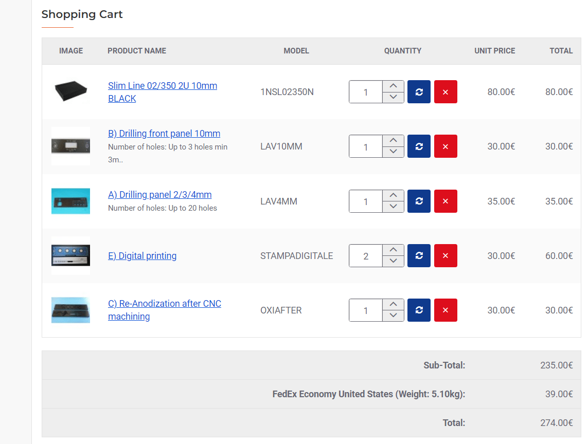

This is almost correct, the front panel customisation option should be "customized on one side of the panel" and the option for the rear panel should be "more than 20 holes". Everything else is correct!Here's what you need to order... tell Giancarlo it's for an Iron Pre and he'll know how to finish it.
Heads up, I think they're still on their summer vacation.. Euros and their August.
As soon as I am back from Colombia I'll make sure to add a complete product to the store so it is easier for everybody to purchase the chassis without having to add the single customizations to your cart

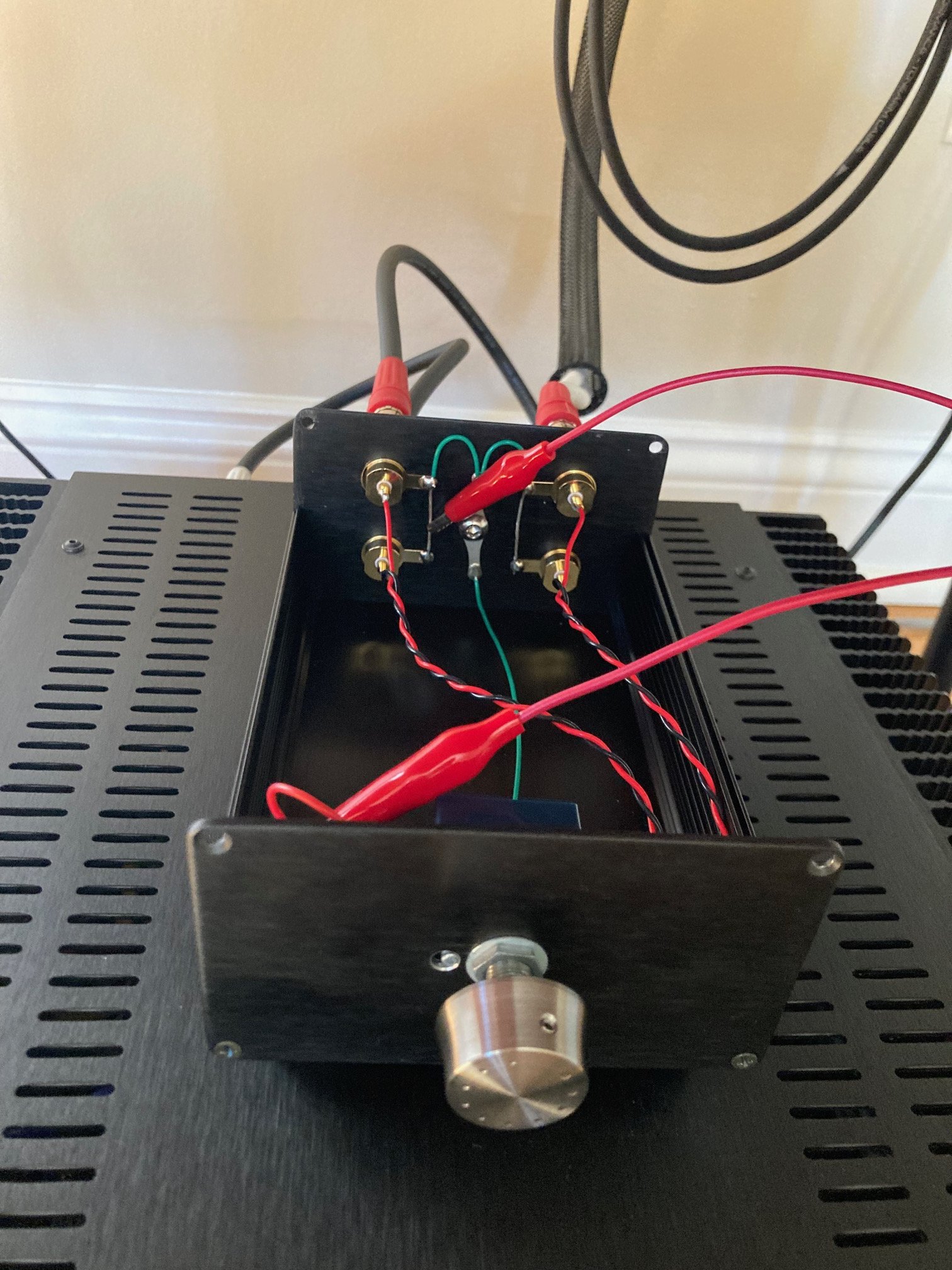

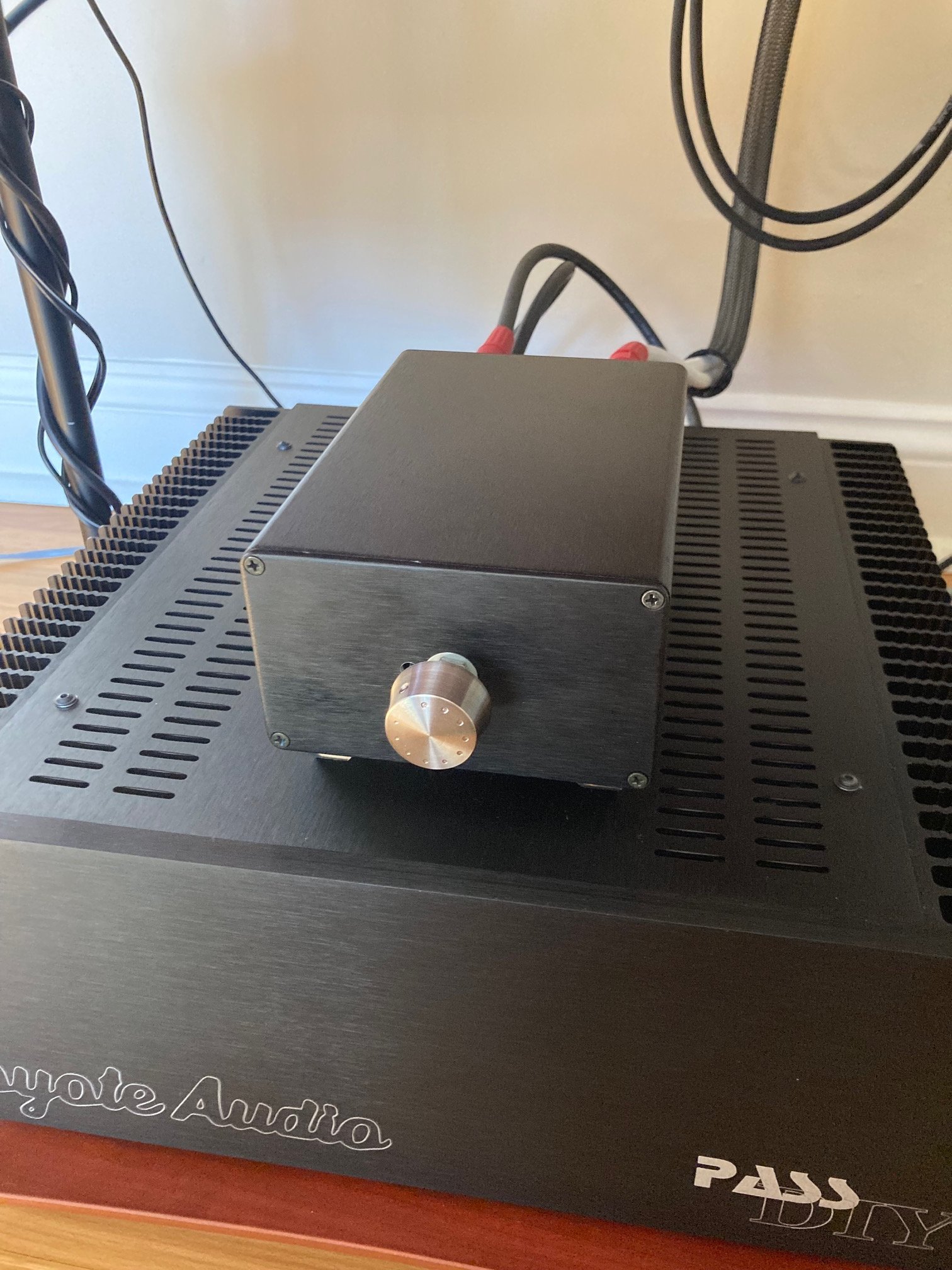

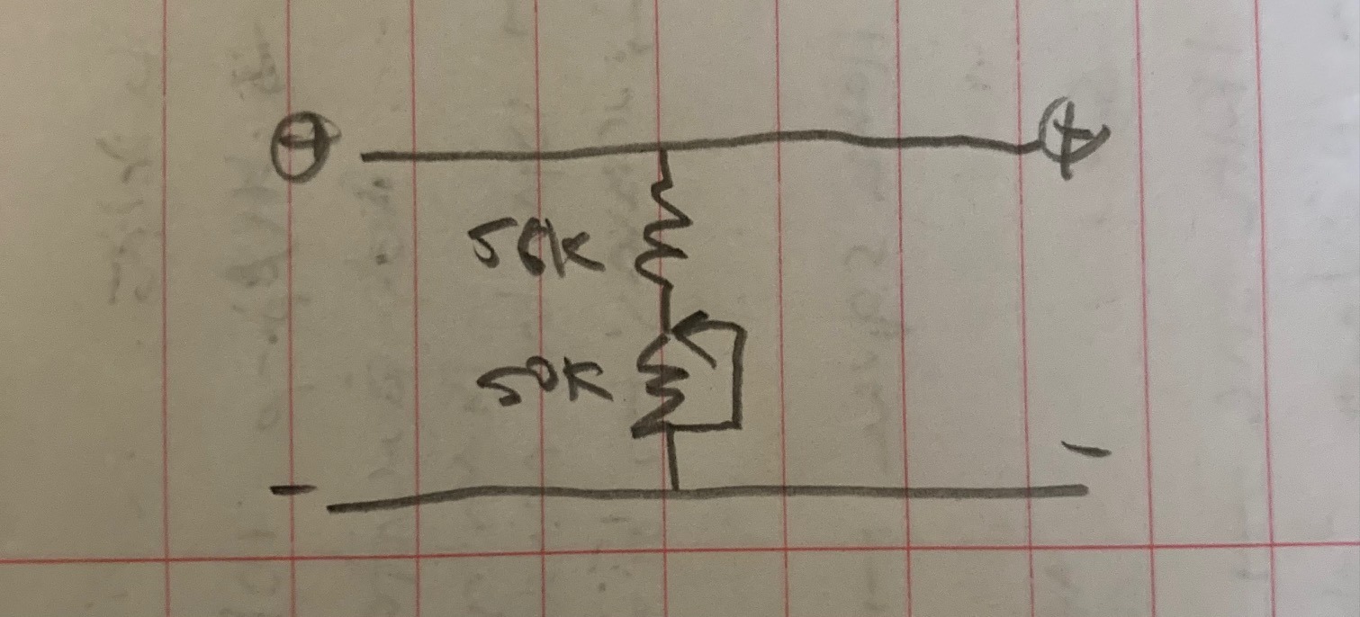

So, I did an experiment, adapted a little box to dial in a shunt resistance from 100k down to ~55k, and later, from 50k down to a short. I didn't notice any convincing change in the sound until right before it cut out completely, when the shunt resistance was dialed close to zero. Maybe this shunt needs to be right on the secondaries to have an effect, idk, but I'll claim that a shunt halfway between the preamp and amp, with RCA cables in between, doesn't.if there is sibilance, try loading output of preamp itself - resistor shunting output hot to GND (physically - either on pcb output pads, or on RCA/XLR outputs)
in cases where Rin of power amp is highish, some taming of autoformer can be good thing to apply
say (resistor) 100K and down - leave value which you like most
Then I got clever & put in my little old passive preamp after the Iron Pre and before the amp. That changed the sound & now I have two tone knobs to play with. But overall I'd say, leave it alone.
I'm, frankly, leaning to conclusion that - if there is any significant sibilance when Iron Pre is introduced in signal chain - better try what's happening with some other decent source
any possible rinzinging of Iron Pre itself can be tamed with RC cell loading of pre output, but it is impossible as general recipe, considering wast range of possible amplifier input impedances

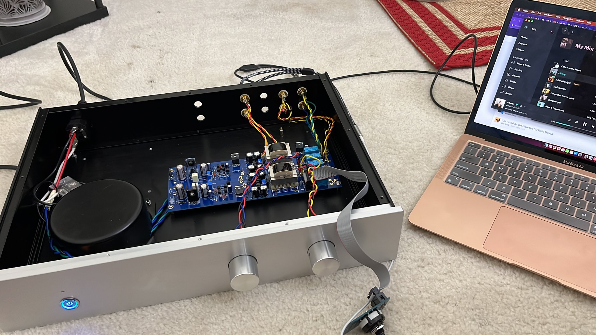

My IP is singing now 🙂

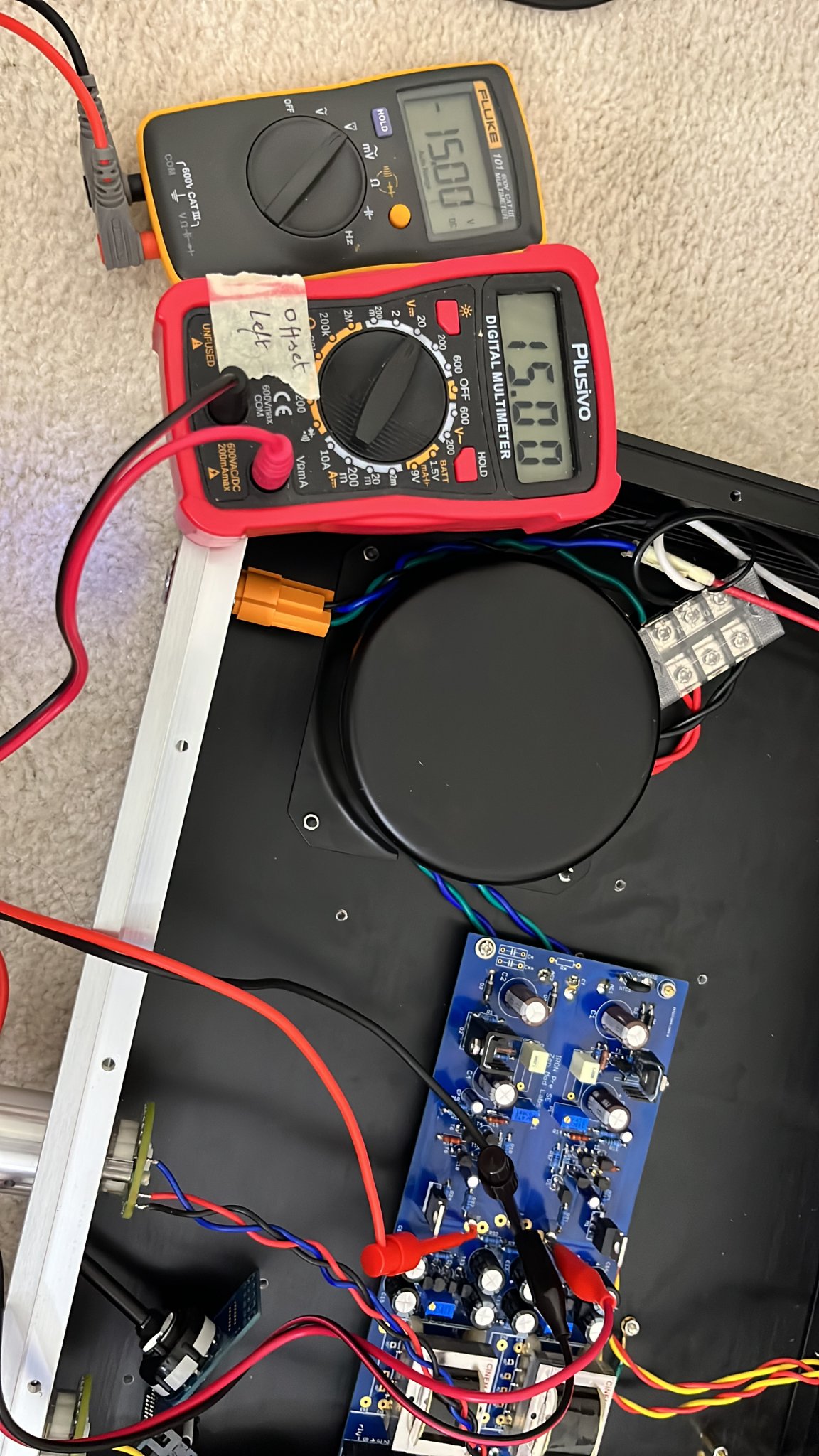

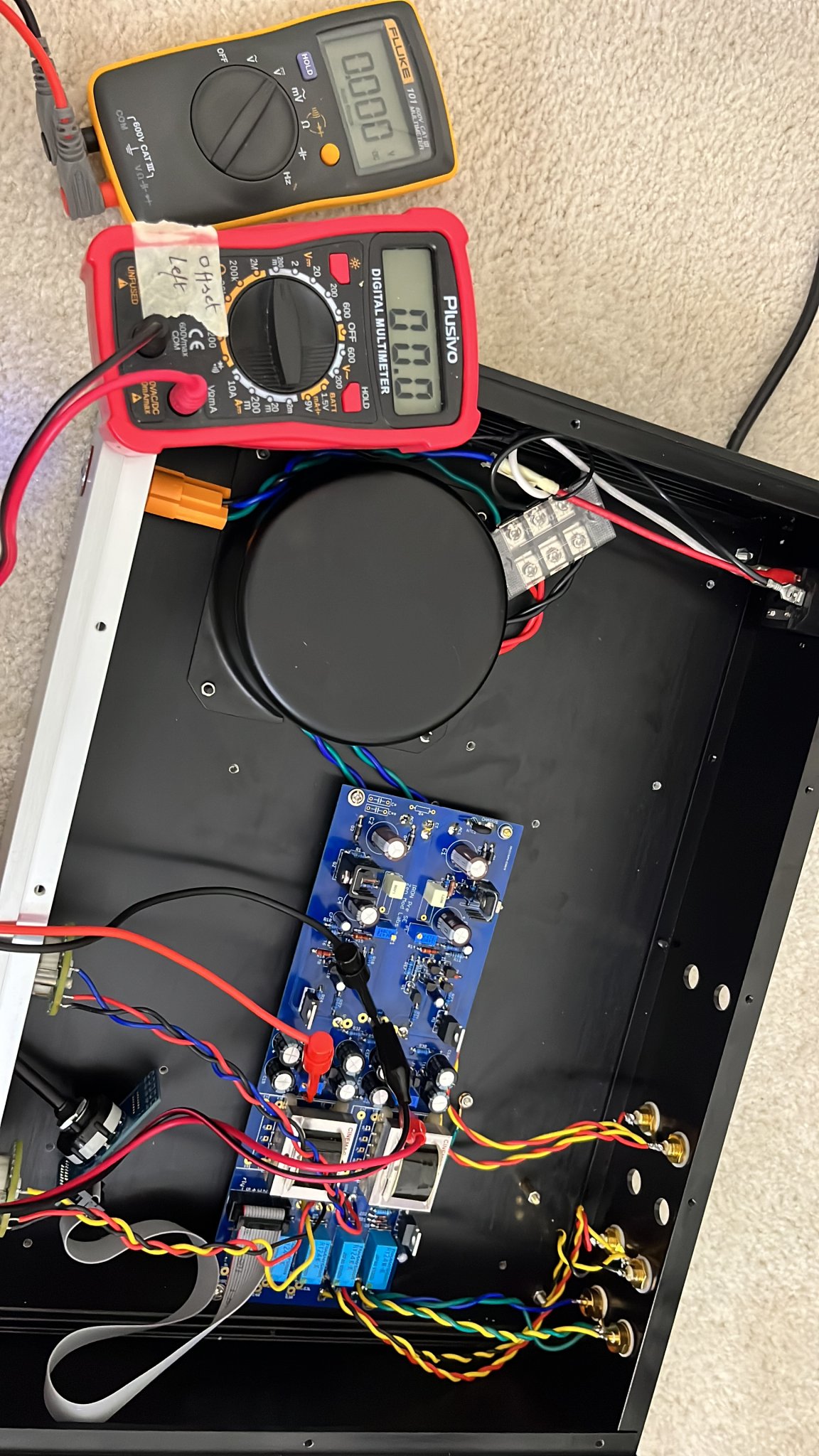

Was easy to dial the voltage to +/-15vdc and then was able to offset to 0.00mV perfect no fuss initial setup. Using the SCG preamp cabinet along with the Goldpoint mono stepped attenuators with 6db gain.

yeah, so afterwards I hooked my Iron Pre up to a signal generator and oscilloscope. I didn't take any pictures, but I didn't see any evidence of ringing on sine or square waves up to about 28kHz, so I don't know what I would be trying to damp with an RC cell on the secondary. The rise of square waves at high frequency got a little delayed, but I assume that's just hysteresis in the core.I'm, frankly, leaning to conclusion that - if there is any significant sibilance when Iron Pre is introduced in signal chain - better try what's happening with some other decent source
" but I didn't see any evidence of ringing on sine or square waves up to about 28kHz"
Was the scope the only load on the preamp? If the preamp's ringing is susceptible to the load, would it be that the scope's load impedance is too high and tames the Iron Pre?
Maybe load the scope in parallel with your amp, the one that exhibits the "sibilance" and then take the measurement again?
What ZM and Tony said.yeah, so afterwards I hooked my Iron Pre up to a signal generator and oscilloscope. I didn't take any pictures, but I didn't see any evidence of ringing on sine or square waves up to about 28kHz, so I don't know what I would be trying to damp with an RC cell on the secondary. The rise of square waves at high frequency got a little delayed, but I assume that's just hysteresis in the core.
Regardless of measurements, simply do what you can to single out the IP as the source of sibilance.
Also keep in mind that it might also be so transparent that it reveals DAC or source issues better than other preamps.
If it is the IP, you have basically ruled out output transformer ringing, or? Next move i would imagine is to increase the input series gate resistor, first to 1k. If better but not perfect, move on up a bit more, not above 3K2 (quote MZM in private romantic Viber conference). Of course killing ZM’s preciousness of maintaining dynamics everywhere possible
So, if your poweramp is a silly easy load (Aleph J, etc), try swapping power amps, or load the output transformers.
If suspecting oscillation between source and IP, increase input series resistor. If that doesn’t cure it, and the IP was done right, the issue may lie somewhere else in your chain.
