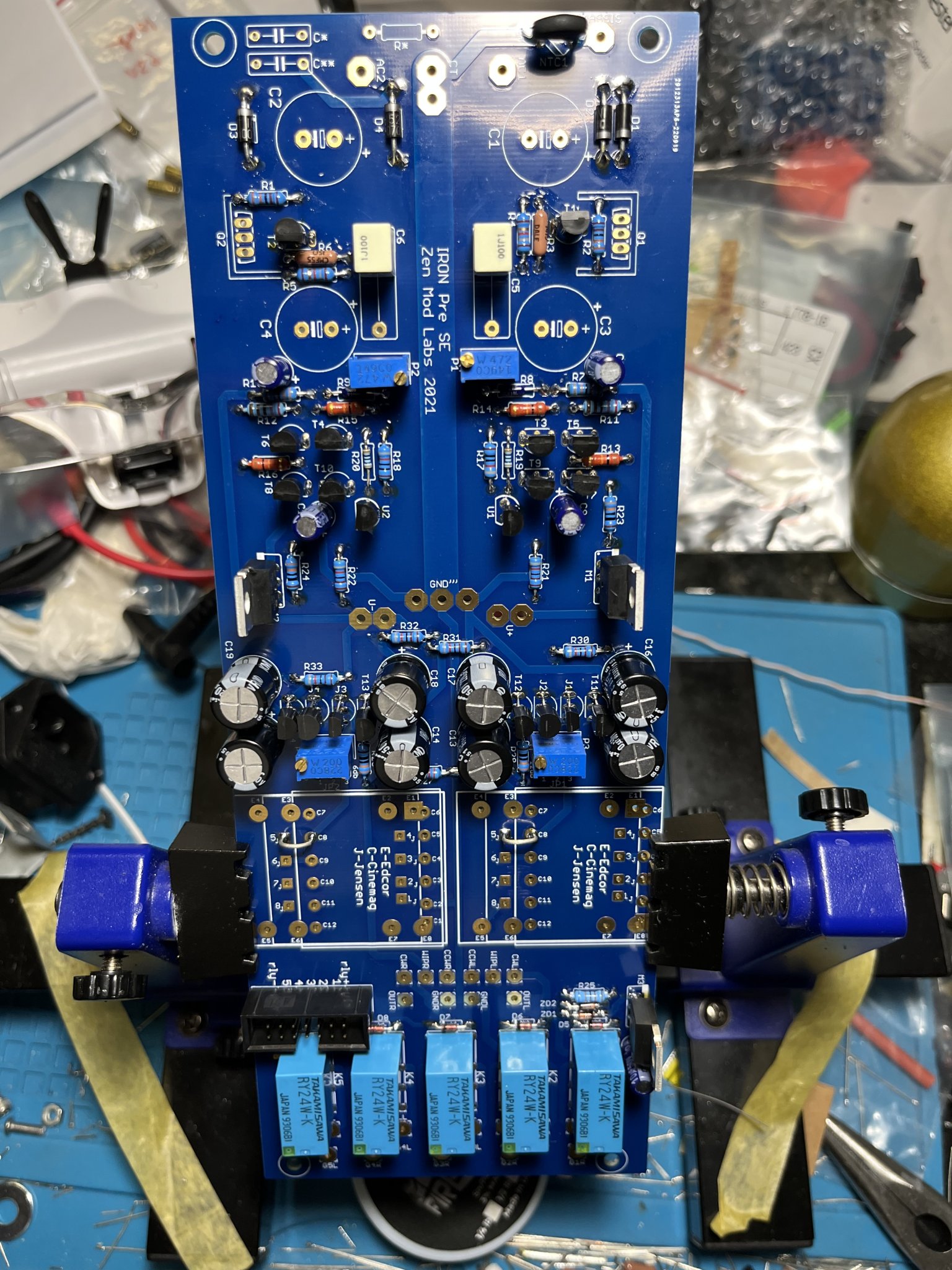

Almost done with the iron pre SE today and my bad missed ordering the 470uf/35v caps for C1-4. Realised I have few Nichicon but only in 25vdc which I believe will be too close to the rail voltage and not recommended. Now need to order again.
overall disclaimer for elcos - only C1 and C2 needs to be Vdc=Usec*1.41
if you take that practically there (reg input then diode bridge) is more than 2*18Vac (stabilization factor of small xformers being lousy) , and one always must account on mains voltage fluctuation of +/-10%, 35Vdc is nice figure for these two caps
every other afterwards - 16Vdc is enough - simply because rail is regulated and never above 15Vdc
Thanks Kevin I am not sure how good are those Gem con capacitors never used them. Good idea to scout on eBay or Amazon as I need only 4 caps rather than from Digikey or Mouser. But is it fine to use 25v caps on C1-4 considering 18vac transformer secondary?I’ve found THIS SOURCE to be reliable if you don’t care to place a Mouser or Digikey order.
Thanks ZM, I do have 50vdc caps which I can use in C1 & 2 and use 25vdc caps for C3 & 4.overall disclaimer for elcos - only C1 and C2 needs to be Vdc=Usec*1.41

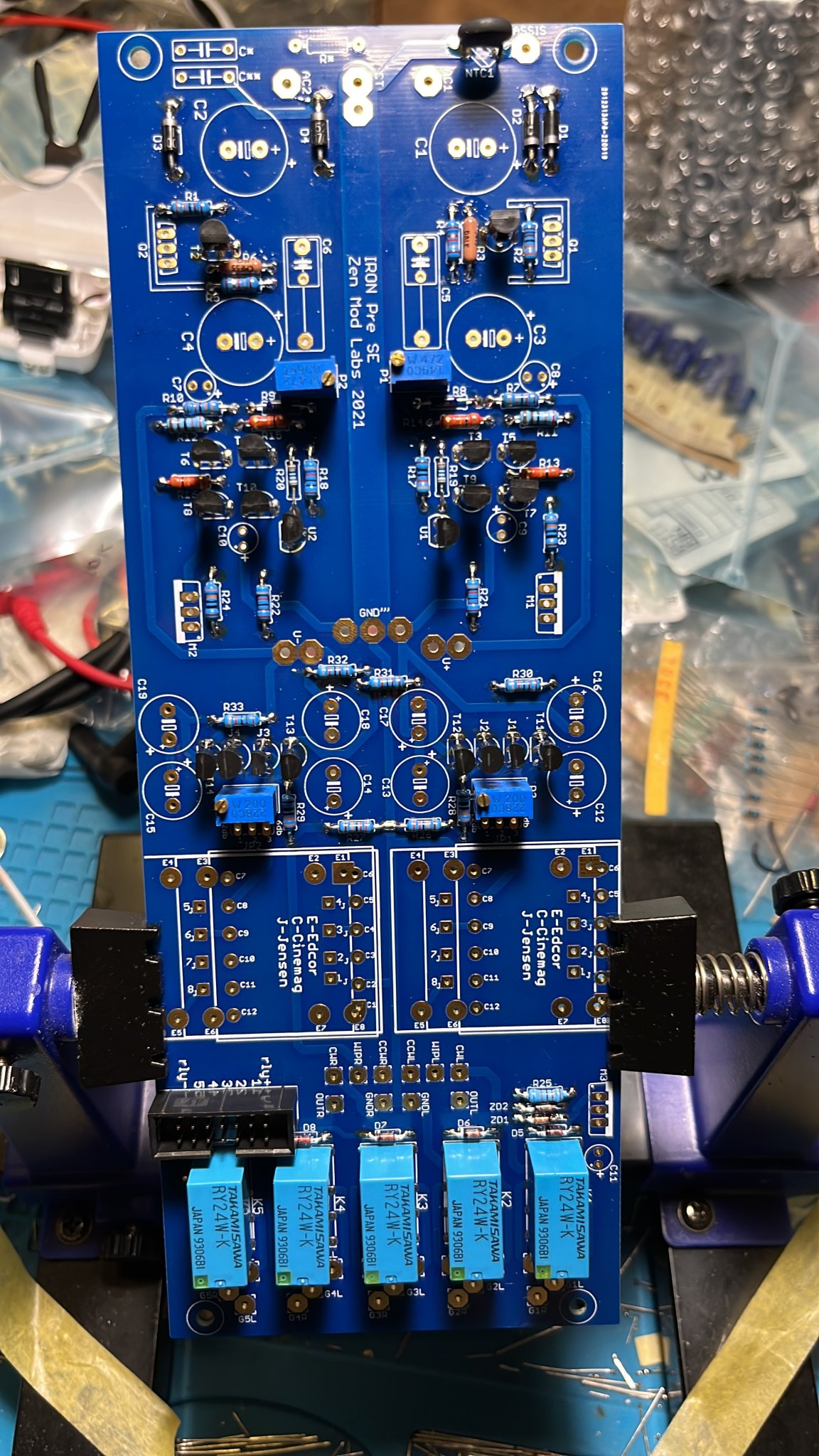

A quick question before I power up my preamp. Looking at the first post with regards to the C11 silk screen error with the '+' sign on the outside I see that on my version of the PCB board their is no + sign on the outside but its inside of the cap marking. And should i now follow the silk screen to mount the cap or go with the first post correction to reverse the cap with the silk screen?
My PCB board picture for reference
9 - Aug 2023
There is a minor error on the silkscreen for the 2023 SE boards. The polarity notation for C11 visible when the cap is installed is incorrect. Ignore it.
9 - Aug 2023
