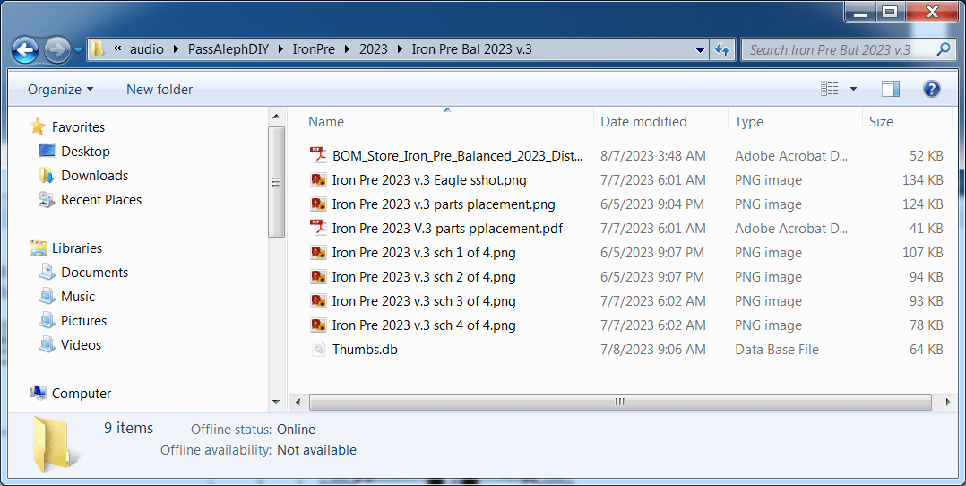

Looking at the schematics... version '23 v3.
sch 3 of 4 : I see = -IN/5, +IN/5, -OUT/5 and -OUT/5.
should these be IN/3, OUT/3 ?
clarify/post exact schm page you're talking about
practically, speaking of nomenclature of inputs and outputs - all you need to know is on pcb and it is same on schm
what you see as "flags" at xformer itself - ignore that - those are names of particular nets in circuit; tool used to connect what's needed between different pages of schm
no.
Then, in the balanced schematics provided in the first post, I see four slides. Slide 3 calls out -IN/5, +IN/5 and so on... at the Edcor_pc600
And slide 4 calls out +IN/3 and -IN/3 as well.
There is no slide 5 of the balanced schematics, there is for the SE... I think the sheet 3 of the balanced schematics is either wrong or there is a missing sheet 5 for the schematics of the balanced design.
I traced them...
I traced them...
and, after my explanation - how those flags are of any relevance to you?
number after dash is not for "page", it is flag instance of same net
Oh.... I was chasing them across sheets. Thinking the number indicated the sheet not the instance. OK then... I spent quite a bit of time trying to follow those.

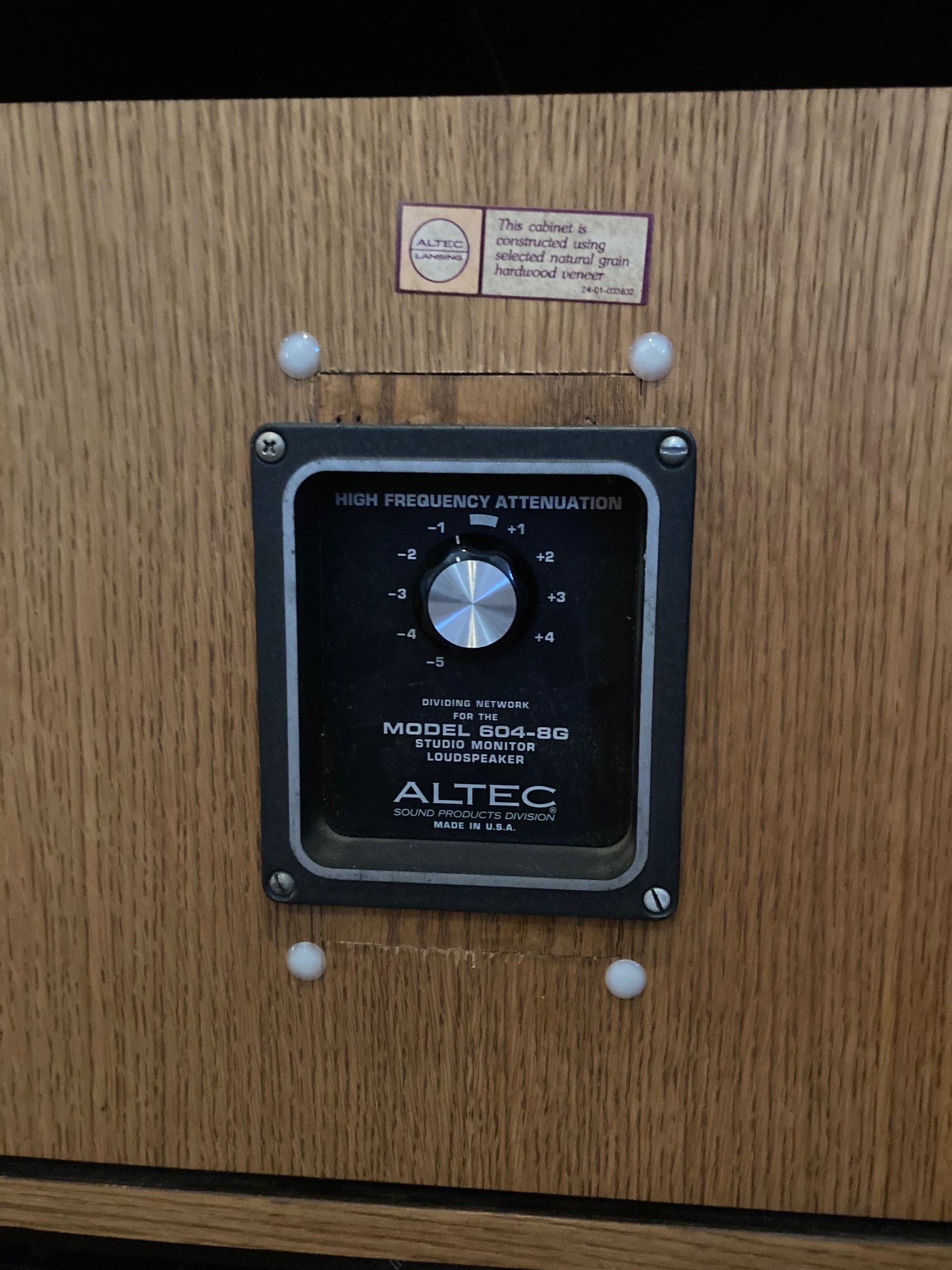

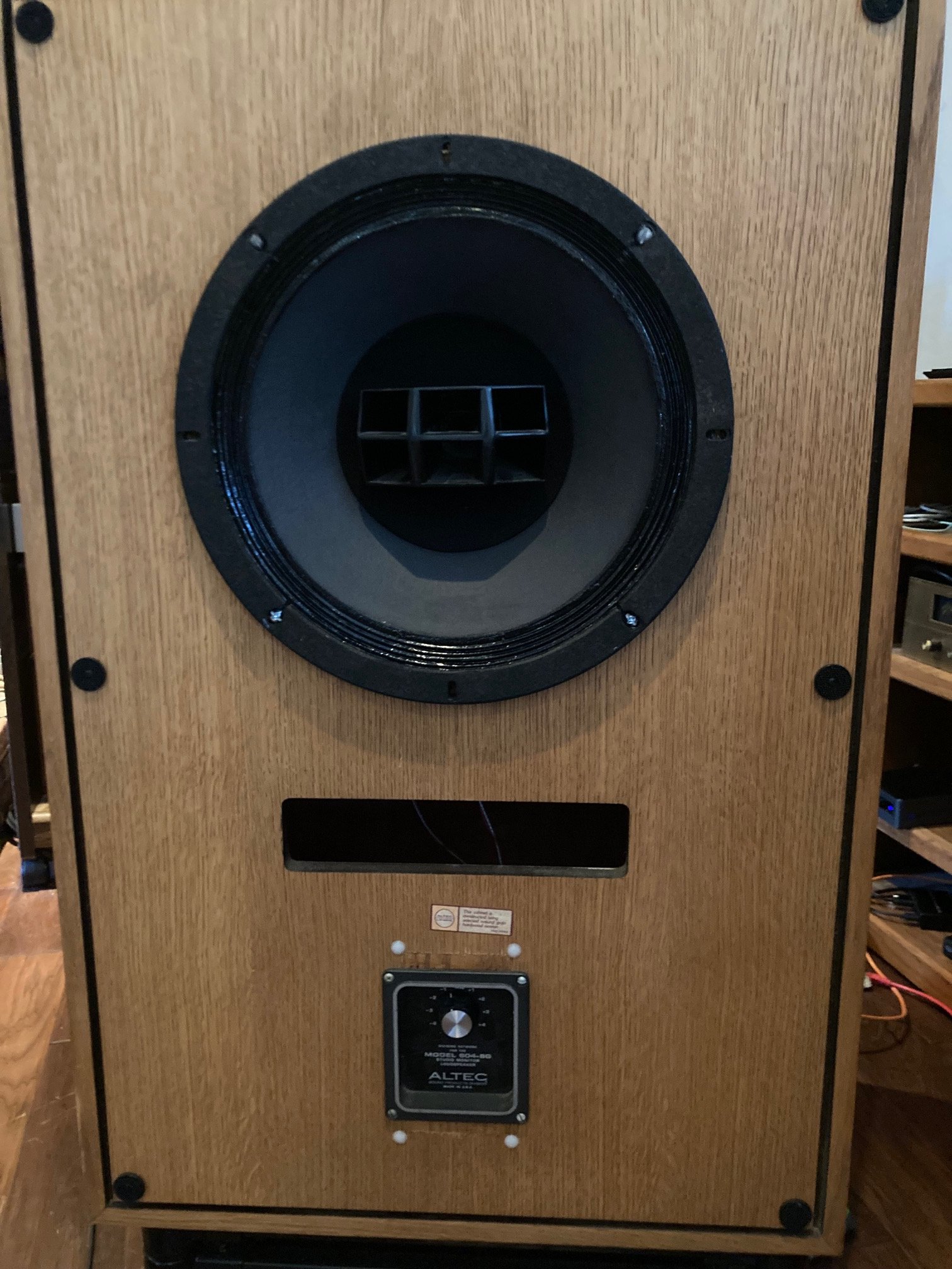

So, the Iron Pre makes for sharp horns. It can drive these horns through the grumpy gates of Aleph classic driver stages, which is a thing, and a sound imo. After hearing some classic jazz played on a classic system this weekend, I'm thinking that sometimes, maybe classic jazz should be played in a way that makes the horns sharp. If you have an Iron Pre, and an amp with cojones, may I suggest playing some sharp horns, just for fun.
Sharp as in forward, prominent, long decay, like the sibilance in vocals and hits to cymbals that retain loudness and trail off for a bit after the hit. Rightly or wrongly I've been associating these sounds lately with odd-order distortion, or rather with systems that likely don't produce a lot of even order distortion.
Here's the rest of the dial. Note if this were mine, in my system (ha!), I would have backed off the treble even further.

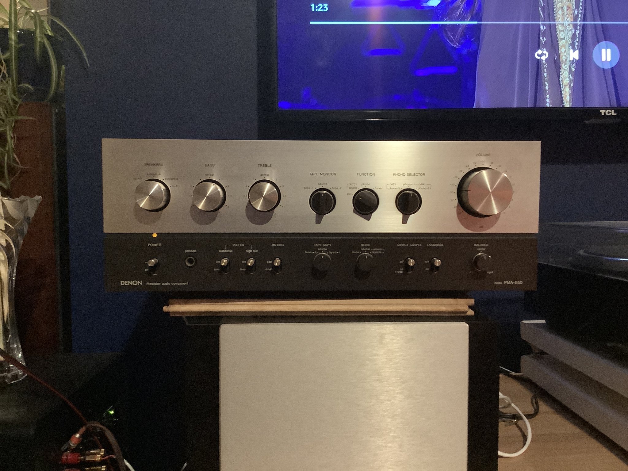

Last week I found a long sought-after Denon PMA 850 on eBay “for parts, not working” for a fabulous price.
Some contact cleaner and poking about and it resurrected itself. I’ve been using the Iron Pre on its main-in, solely as and amp, bypassing its whole integrated switchery front end (three, count ‘em, three phono inputs!) and wow, is this 45 year old (the amp, not me… I’m older still) is raising my eyebrows. A lot.
Let the Iron Pre handle things and review your amp lineup. DIY, commercial, old and new, a good signal in is a good signal in.
