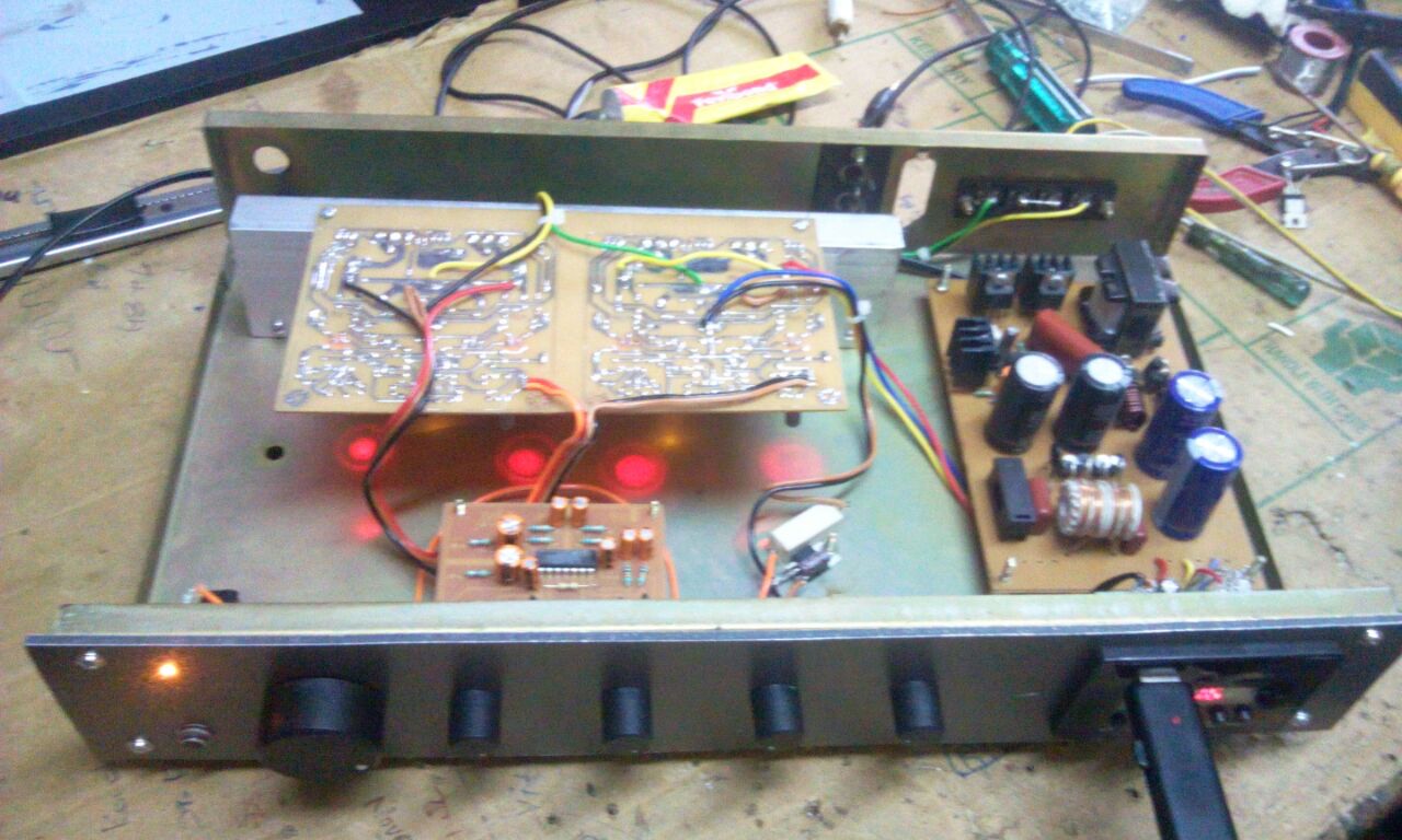

Please share all the SMPS files (schematic,pcb).🙂
Sir thimios attached pcb file download in other site
The ferrite transformer used is the EI33 , can be found in side burning soures ATX computer(dcrap) andre used.
The primary consists of 40turns of 22 AWG wire(only1wire)and the secondary consists of8+8 turns of 19AWG wire(2wires together in parrallel.
I get in 35v dc

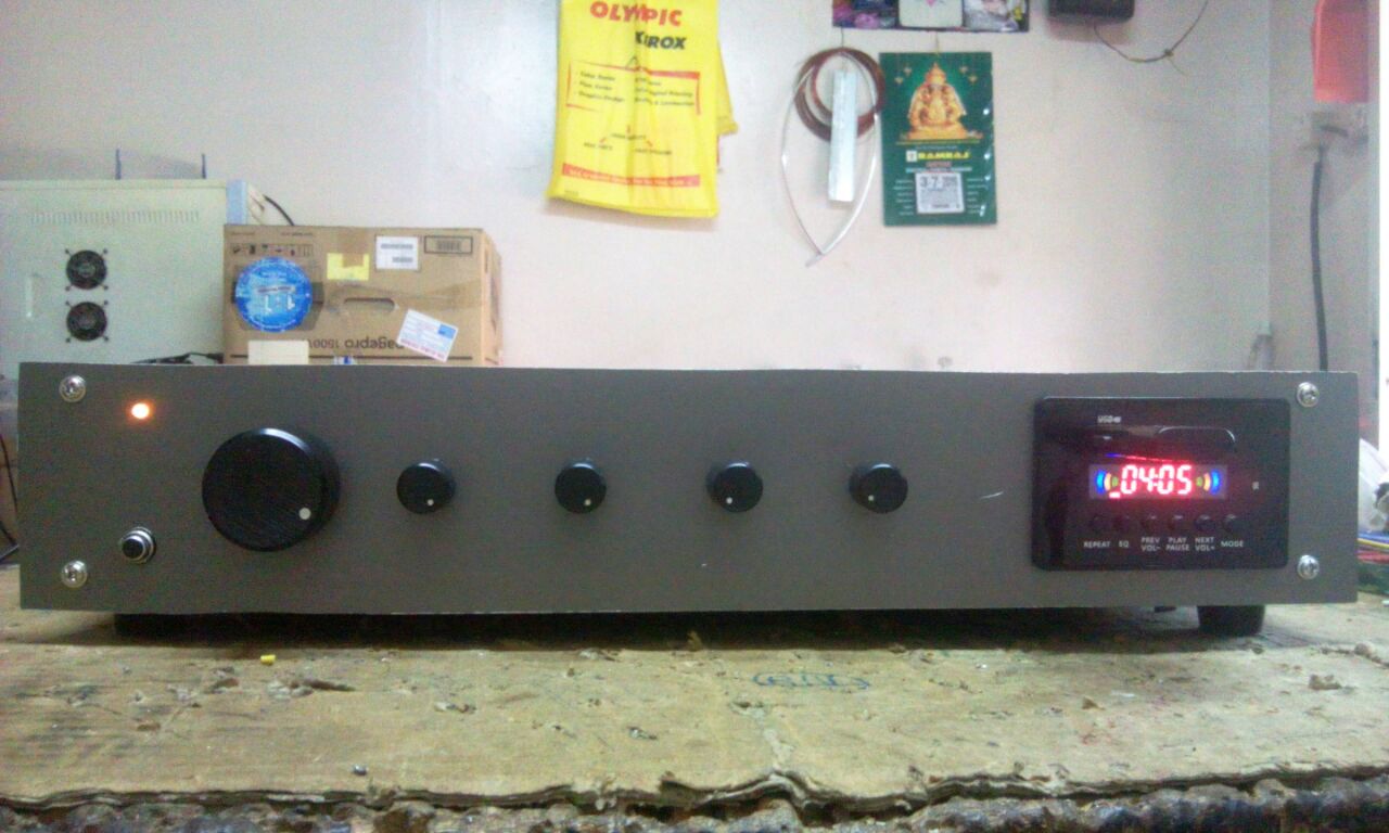

Greetings to all my vhex 1.1 in fitted diy case
Nice build! I see a digital player embedded on the right.
So, this is a media center then 🙂

Can you give details about transformer?
Hi Sownel,can you give some details about transformer winding?

I vaguely remember this SMPS from another thread in this very forum, a Brazilian amp design using this PSU (hence the portugese file names)Sir thimios attached pcb file download in other site
I get in 35v dc
