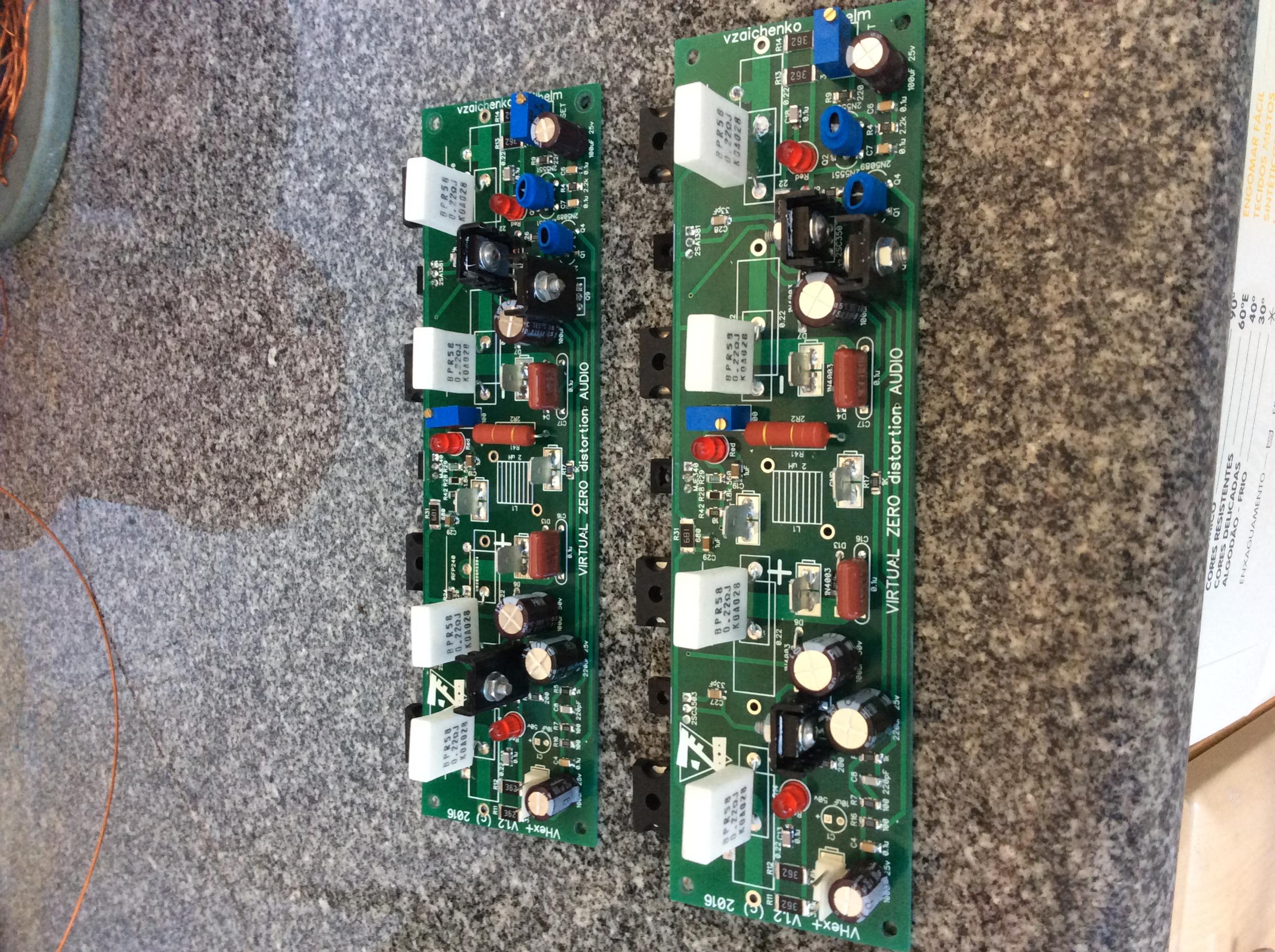

Here is my progress:
I'm still waiting for the magnetic wire to arrive.
I need to know a few things:
What is the bias value?
Where do I measure the bias?
Bias rises clockwise or anti-clockise at the trimmer?

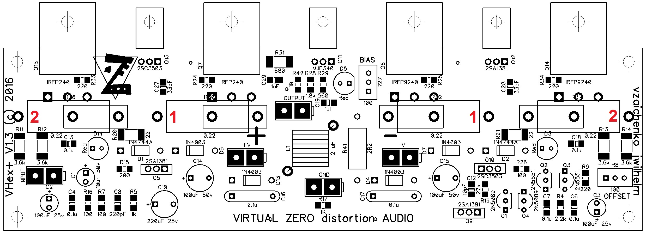

For bias adjustment, see post 270. Put DMM test leads on points 1-1 and set voltage across 0.22R+0.22R for 80mA (about 35mV). Double check across points (2-2) and should be double at about 70mV.

Bias should be around 80mA. Measure the voltage drop across a pair of emitter resistors to figure out the bias. If you are using 0.22R emitter resistors, you should read 36mV.
Set the bias pot to it's highest resistance. You have them installed in opposite directions, so setting will be in opposite directions to each other. Set the offset pot to around the center

I used some magnet wire I found in my parts bin and tested the amp. Unfortunately I have smoke in the two 10R 1W resistors at the rails. 🙁 What do I do now? While on bias starts at a few mV and then rises to about 10mV. After that I unplug the amp.
First, double check all your transistor orientation and location. With power disconnected, measure the resistance of each power rail to ground, and each power rail to your heat sinks.
It looks like you may have Q9 & Q10 installed backwards. The square pads are transistor base, which is pin 3 on a TO-126.
Use a bulb limiter for initial testing to stop smoking parts too.

1-1 and 2-2 should actually be the same voltage if the output pairs are matching.

Everything's right, but the voltage between 1-1 and 2-2 should be the same (35-36mV) 😉

I made some progress. The issue is the bias. I was starting the amp with a bias value to high. But there's still a problem: the lower bias value I get is about 89mV (trimmer all the way conterclockwise). If I turn the trimmer clockwise the bias increases to a lot.
One of my amps initially had a very high railed output and finally traced it to a cold solder joint at R20 (22R 1W). When everything is soldered and placed right, this amp fires up with stable bias and offset. Took a day an removing a bunch of transistors to track that down though. So look for suspect SMT solder pads.
@vzaichenko and jwilhelm: sorry I messed up that 2-2 probe point for the bias - so thanks for catching that. I remember there was a point where the voltage was doubled, imagining it?

Many people recommend measuring bias across a single emitter/source resistor, which would be 17-18mV. Valery's recommendation is across two emitter resistors, which doubles the value.
