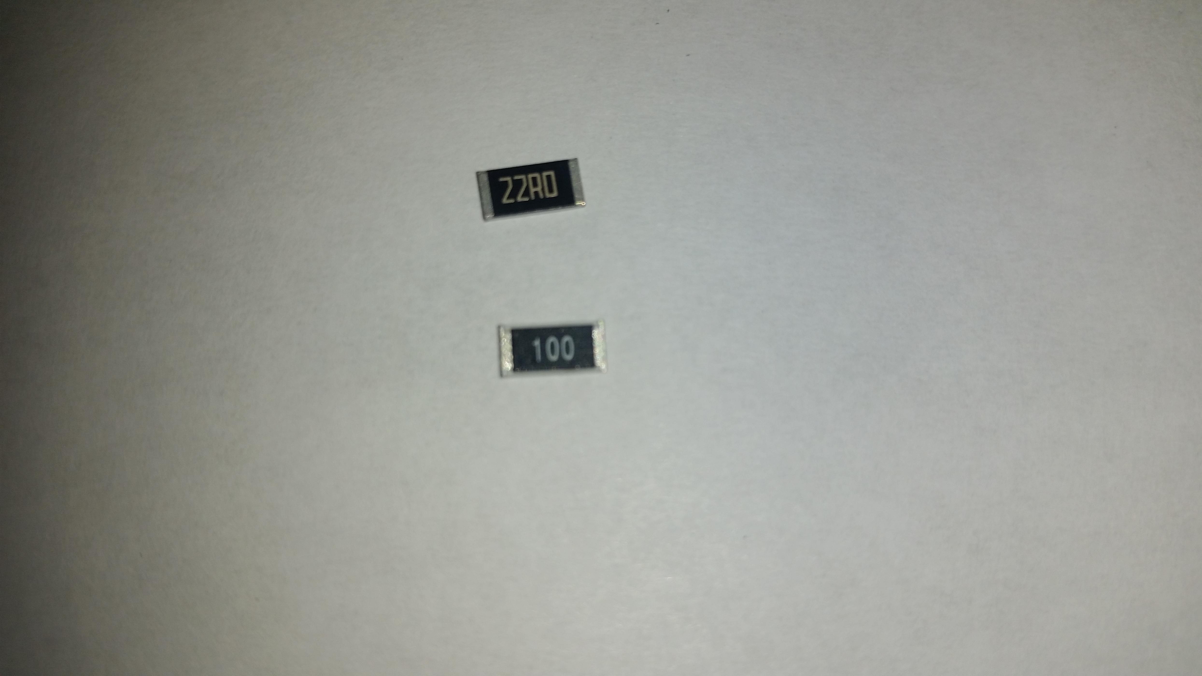

Mouser sent me 22R 1W smd resistors market on the bag label as 220R and 10R 1W marked as 100R. The markings on the parts and measurements indicate the correct value, 22 and 10 ohms. I'm going to measure all the other resistors. Unfortunately, I don't have equipment to measure the small pF capacitors and they have no markings on them. I'll have to trust Mouser...

10R SMD marked as 100 the last zero=0 zeros
22R SMD marked as 220 the last zero=0 zeros
There isn't really a standard for manufacturers, so it varies, but 220 normally means 22 ohms. This would be equivalent to red/red/black stripes on a through hole resistor. I have some Yaegos here that are marked 22R0. I have other Yaego resistors that say nothing at all on them. I have some Panasonic 10 ohms that say 100 on them. There's no real standard and everything changes again when you get into precision resistors.
When in doubt measure them with your DMM. 220 may be a 1% 22 ohm resistor. 220R is 220 ohms. I order my SMT's from Digikey and they have been 100% correct so far.
