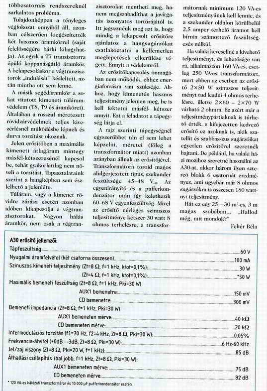

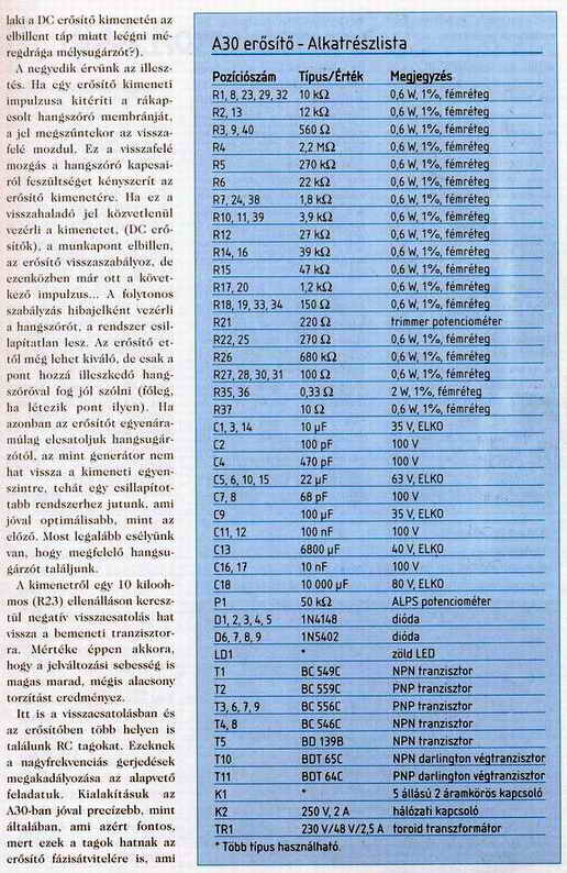

the first part:
The tube like ss amplifier (This is hard to translate, hungarian joke)
HTA-30
Untill today we only discussed valve amplifiers in our magazine. But today we want to show You one solid state amplifier, which topology looks as a valve one. With this is legendary amplifier, we want to explain how we can get romantic valve sound with transistors. The amplifier was planned by Richard M. Hay, who also planner of Radford valve amplifiers. The first version of the amp. was the base of the famous Nytech amplifiers, and receivers, and the popular Ion Systems amplifiers. The current version very close to the Obelisk2, and with some more output devices, higher voltages, and large PSU you can get the MA 400 monoblocks as well.
I hope that we can give a "secret tip" for every DIYers, to get good sound with cheap parts.
How the A30 amplifier works?
This is the promised amp! The A30 amplifier. I think we caused a disappointment for lot of readers. The output power is only 30W/8ohms, there is coupling capacitor at the output, and there is no symmetrical PSU, and there nothing special in the schematic.
OK, what is the problem?
This was the first part.
Sajti
