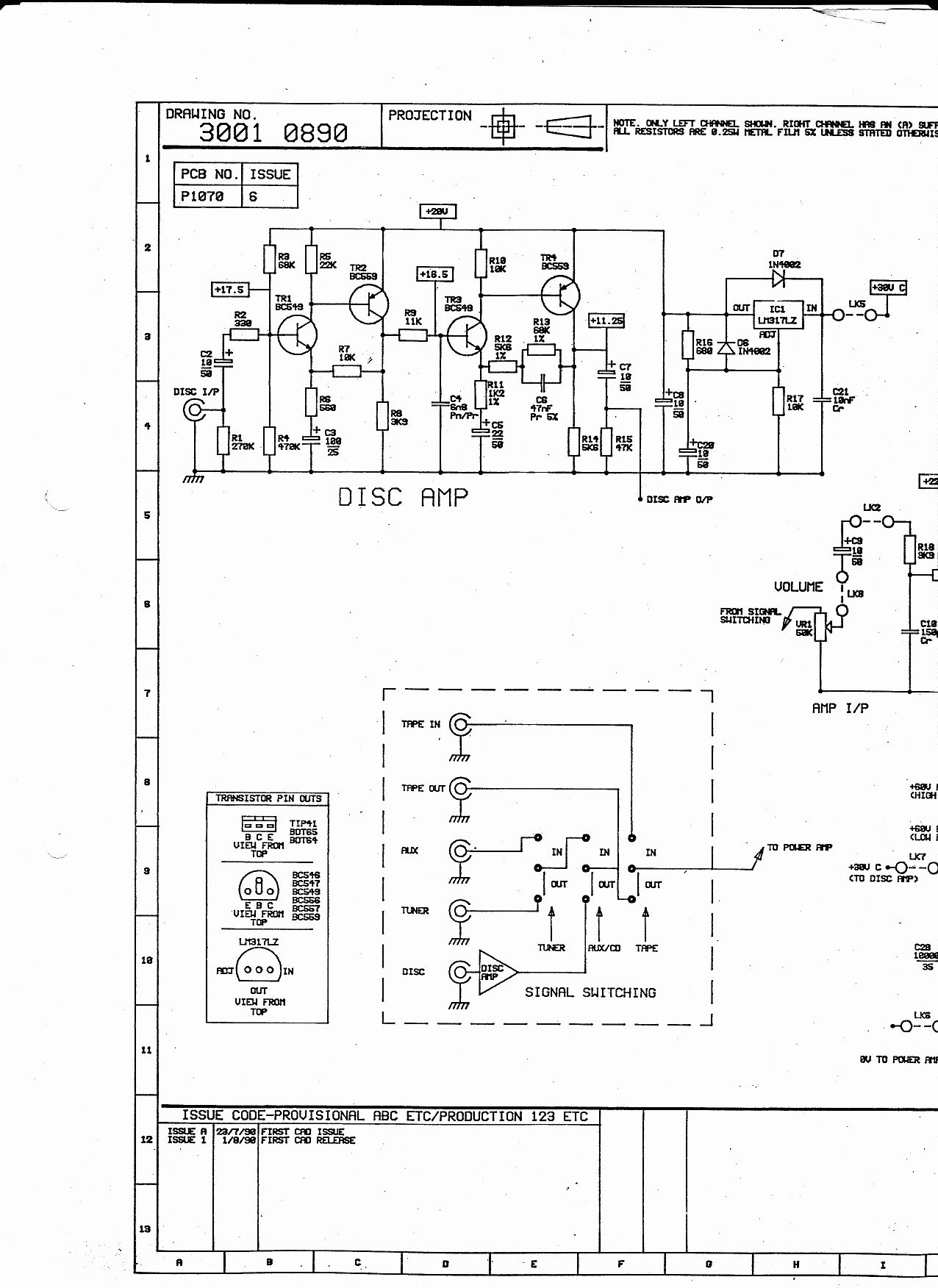

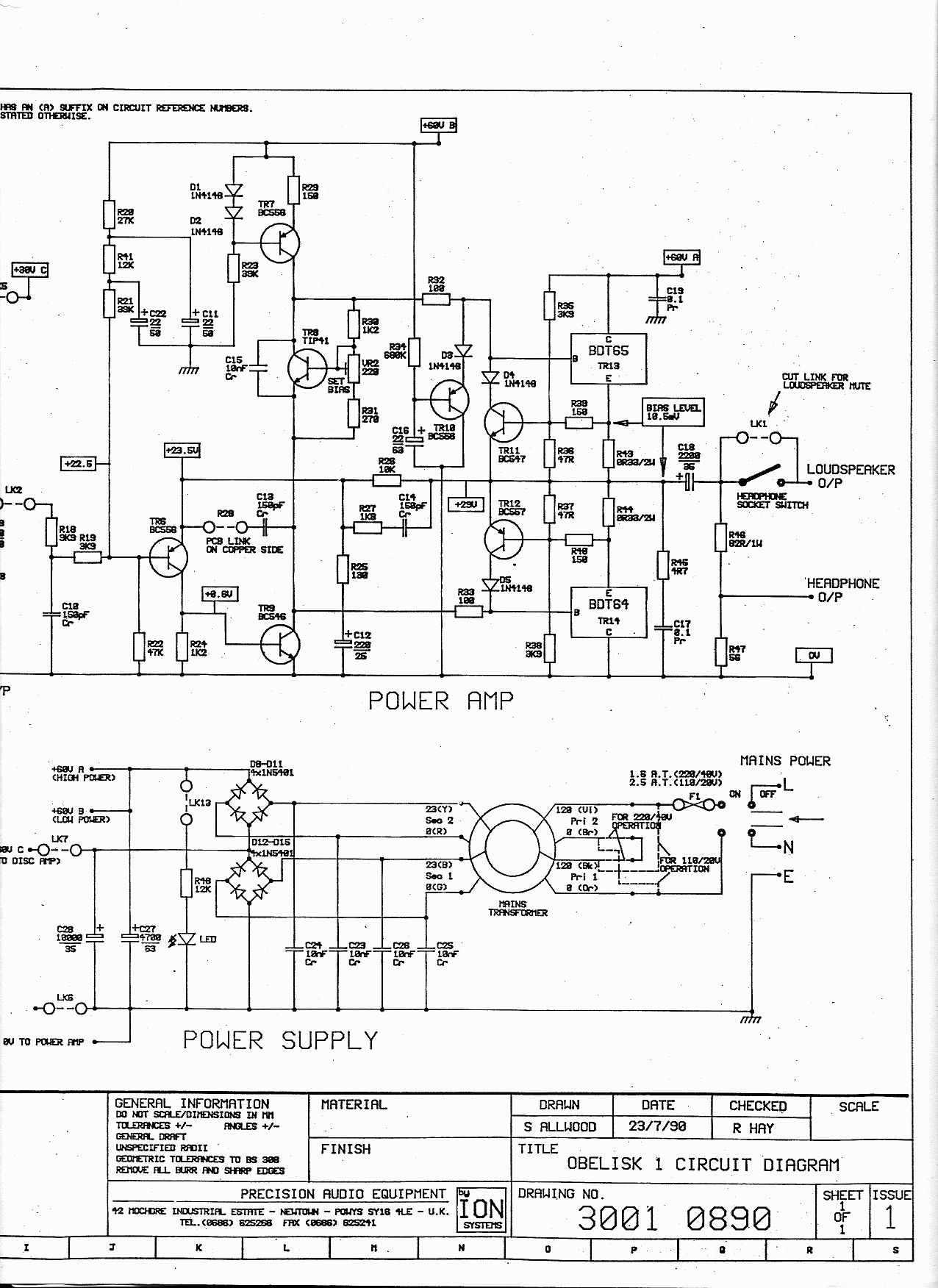

Hello, I'm the lucky owner of an Obelisk 1 amp, yesterday, due a problem with some connector, I've opened it and I discovered that it has an all discrete phono stage (infact I noted that the phono stage sounded pretty good...). Since I want to change some caps in way to improve it, I ask if someone outside here have the schem... many thanks
Al
Here we have a nice little passive/active mm-stage - when modifying keep an eye/ear on the capacitors C3 and C5, not only on the signal coupling devices.
