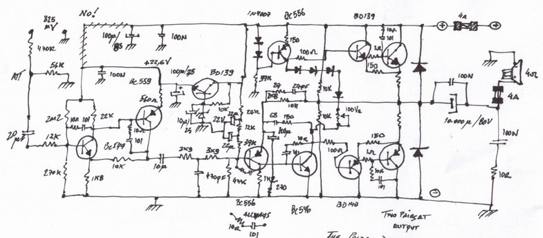

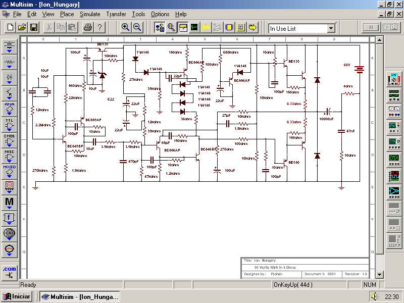

Palesha, thank you the picture and the words:

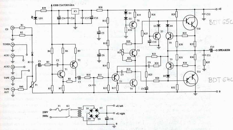

The amplifier is really 30 watts into 8 ohms... and has a lot of protections on it...i cut them all to test without.... in 4 ohms can reach 100 watts in simulation (cannot trust too much such things!), and simulation cannot say to us the sound quality too.
My modified Sony... and a lot of other brands... a have a lot of schematics here, almost the same, with many brands....seems to be easier to construct... i cannot compare, because the Sony modified i am hearing every day, this one only simulated... cannot compare...no honest comparison...have to assemble to hear... a have a long strip waiting for assembling.

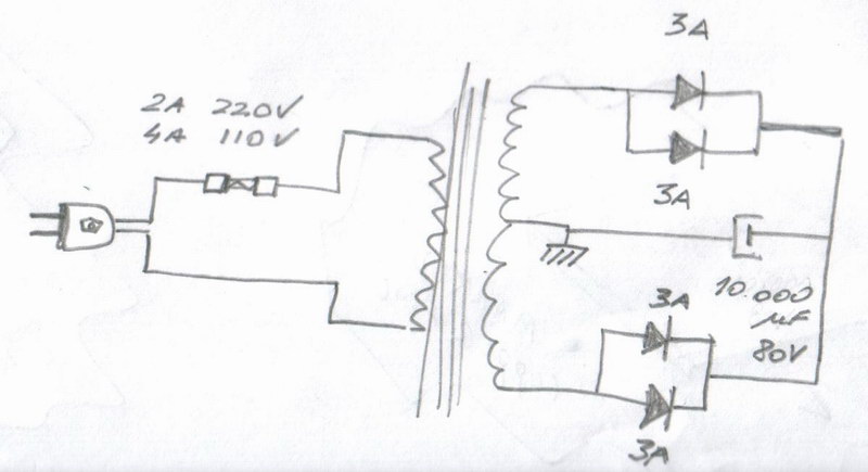

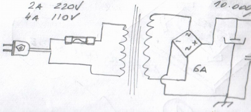

Now i will put for Roberto, from Italy, the informations to construction the modified Íon.

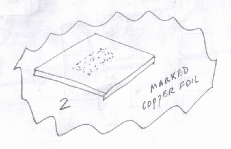

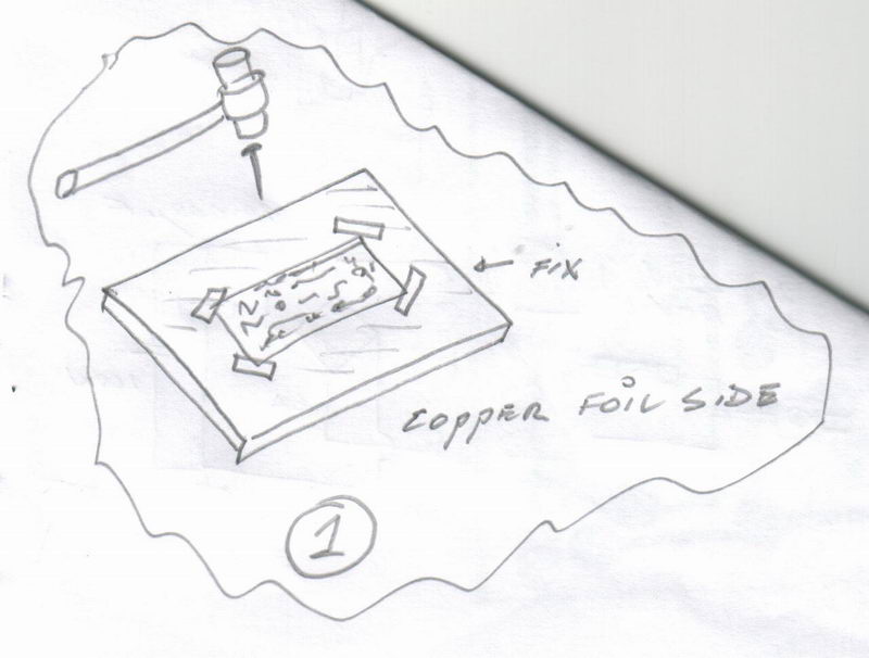

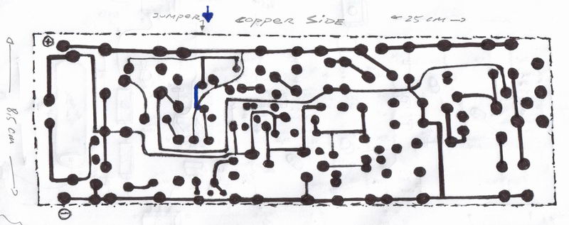

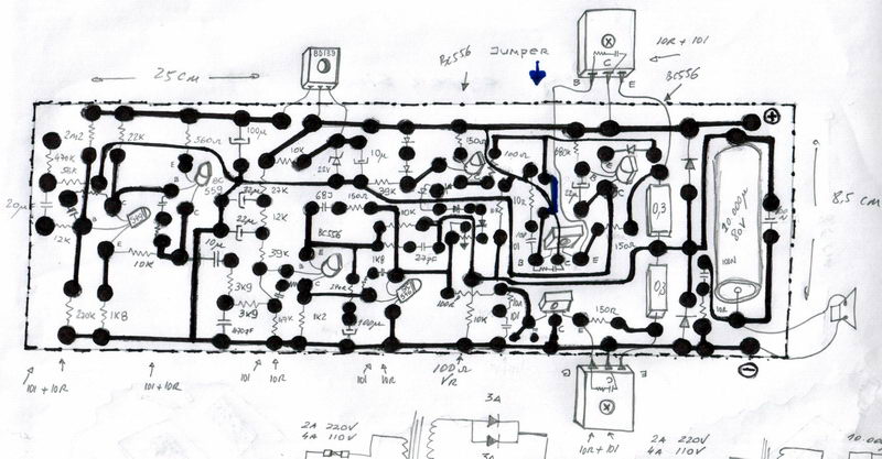

The last scratch you see as the board is transparent.

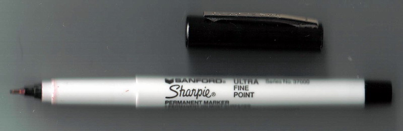

This one is only the copper side...make a copy, cut with scissors, fixed on the cooper side of the phenolic or fiberglass board, and with a hammer, and a thin point metal marker, hit it without power... small hits, only to put a week mark on copper metal surface... those markers, will be used to reference and center the machine to drill the holes, and last thing to do is to paint circles around holes, and taking a look at the cooper side scratch, connect the lines together in your "in construction board".
When finished, give a triple check!
If checked and good work, put it on "Percloreto de ferro", Iron Percloret, or other material you use to corrode copper in your country, them, remove the "non painted" copper because ink will protect the painted places against the acid atack!... when finished wash and polish with sponge, or soap with sand, some week abrasive material, or use a very low grain sandpaper.
I always, put solder on all the copper to protect against weather effects... solder forms quick an oxide layer that protect the solder point and the copper.
If you like, when assembled, adjusted and tested, clean copper side with thinner, and pass on it a fast varnish. Check if varnish is conductive or not...normally they are not!

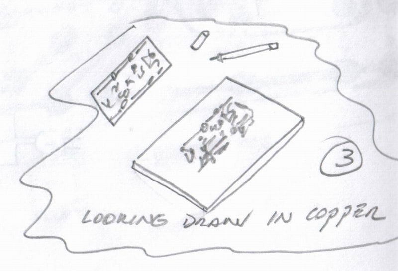

Looking at the scratch, and already referenced
Reference by holes drilled or marks on the board, small depressions...hit week please, if not board brokes.
Now you take a look in the scratch and connect with marker pen the points together.... draw the strips.

Remotion of tr6 made no difference!
In simulation, no difference, remotion of TR6 and all their passive elements that is working together, condenser, 680K resistor, diode and transistor itself where removed.
No change, so, may be only de-thump circuit.
This way, circuit is becoming simpler and simpler... if people said already good with the overcurrent protection (i always cutt them out), imagine what sound will give without those problematic circuits.
I prefer stone age method.... transistors in big quantities, with power and dissipation to suppott a short circuit in output, transistor excited maximum audio, for the time we need to perceive that sounds disappear, removal of soap under shower and go to pull outlet.
Here in Brazil we have 3 minimum shower a day, because of temperature high.... with soap and shampoo.... daily... this way, this time is important, because you switch on your equipment when arriving from street and go directly into the shower.
