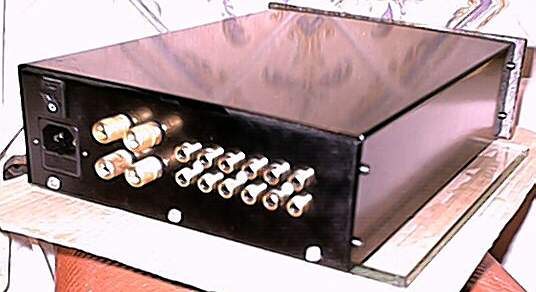

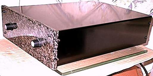

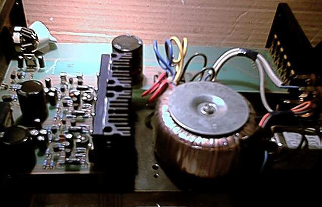

Ion pics
Hi!
Here are some pics of my amp. Sorry for the bad quality, but my camera is not the best.
Lohk!
I wrote: "The schematic is a version of the Ion Obelisk." It was a kit version from Heed Audio. It is a hungarian company and the owner: Zsolt Huszti is the one of the most famous audio guru in my country. They was building the Ion Obelisk in the early 90's, and afther they made a KIT from it. You could share your shcematic to us to see what is different beetween them.
Destroyer X!
Nice work you did with the simulatins! Here is the time to build one for your self! It is easy and cheap and big fun. The sound will be very musical.
Greets:
Tyimo
Hi!
Lohk!
Destroyer X!
Greets:
Tyimo

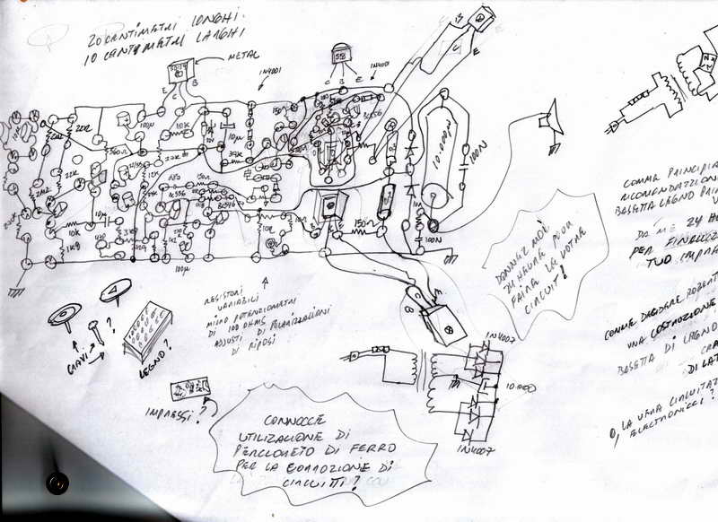

Welcome Mr. Roberto from Italy, he seem to be a beginner and he want to construct Mr . Polzac Zoltan amplifier.

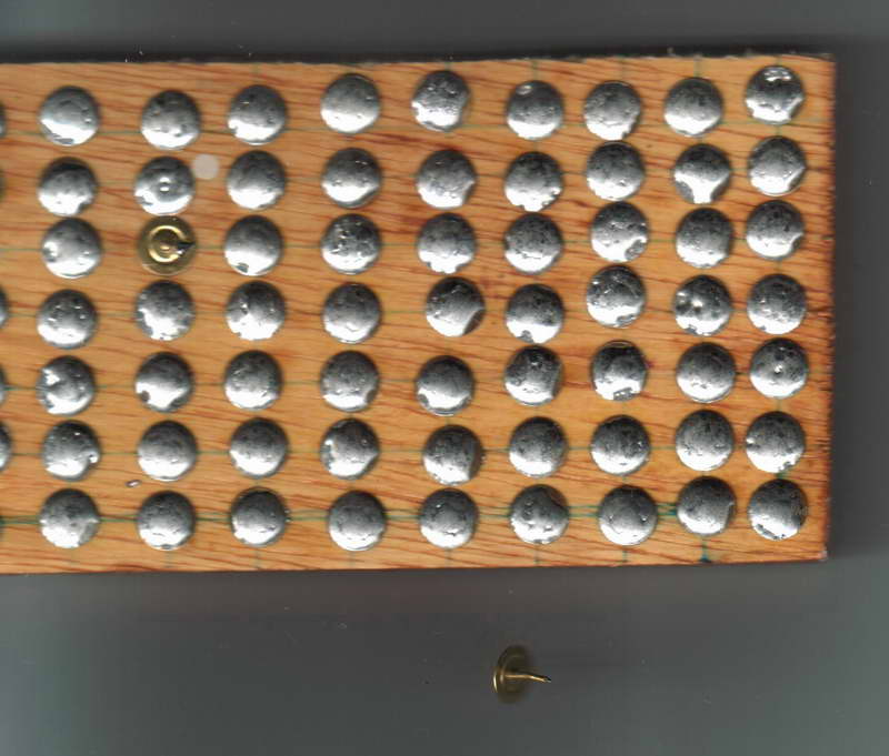

You want a schematic, this one is the schematic....i put as a paint image...if not clear, i can make one other better, you only need to ask... them i will do happy!

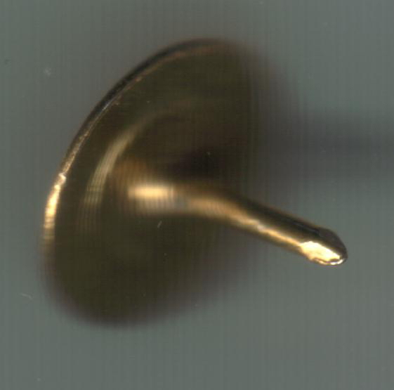

I need to know if you really a beginner or if you have some experience using boards.... as how to paint it, how to corrode it... do you use Ferric Percloret (Percloreto Ferrico) or what you use to corrode copper?
Do you like to assemble in the copper side or you like to make holes and solder the other side (more difficult, a little bit complicated)

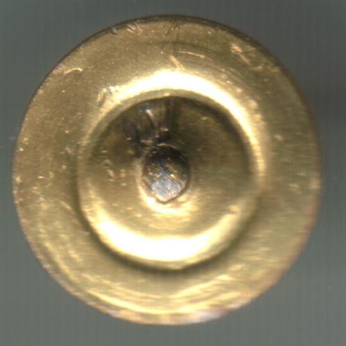

Do you like, as a beginner, to assemble first time in a wooden piece with cooper pins? the ones we use to fix advises in school.
They accept solder very well... and easy to see and solder and revise.... also big, enormous to see better... as a first, i recomend you to do this way.... can avoid frustrations!
But if you are skilled, i can do a board for you... i make them only seeing, make it fast... and delay to correct and check it.
You can see first scratch... and more informations about assembly in wooden base.
