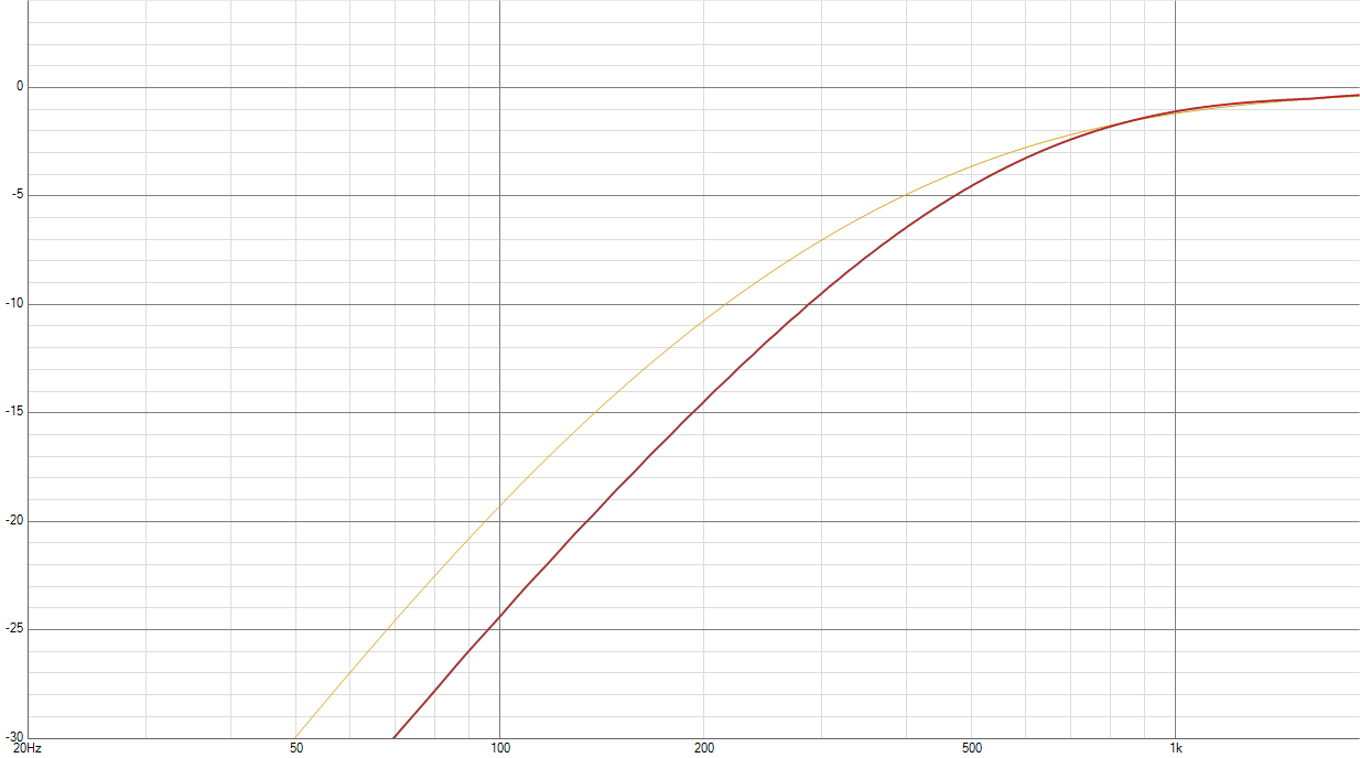

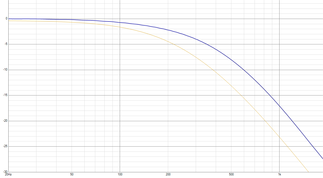

Each of the two drivers is affected by the baffle, each in more or less the same way. When you filter each you would be best to consider the effect this is already having, to subtract this from the filter you are adding.
To make this easier to visualise I ran a sim.
[I used 6dB difference to keep things ideal, you chose 4dB which is more practical. The difference is not clear cut which is why I avoided using 4dB for the sim.]
What this shows is what each driver response should look like (darker trace), vs the amount of filter effect required to achieve it considering the baffle effect. Eg: The first (woofer) plot shows that you need to cut more to compensate for the rising response. This can mean using a larger inductor, aiming for a lower cutoff frequency than first expected.
