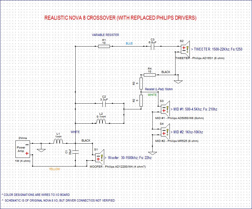

Eyes glazed over after re-reading this whole thread...I am refurbishing a friends old Scott 188T three ways. 10"/5" CTS, 1" Phillips. My question is about the tweeter leg connection point in the crossover. Some say it should come after the mid cap and others have all three legs in common. Amplifier will be ordinary receiver. Posts 178 and 342 show variations on the first approach. Discuss? Irrelevant?

Just got thru reading this great thread. Thanks Allen and all for the great information. Hope I could ask a question about an old Realistic Nova 8 crossover. My dad bought me a pair of these for me in the mid 70s, and a few years later I replaced all the drivers with top-end Philips drivers, with the intent of redoing the XO, which I never did (ah, the 70s...).
I recently got them out after 20+ years and recapped them (with original values), and was planning on just restoring the cabinets, but then thought about checking out the XO first.
Have you seen an XO design like this before? The schematic is right, but I cant verify the driver connections. One thing I would like to verify is the polarity/phasing of the drivers. It looks to me like the woofer should be reversed so the mids are reversed and woofer/tweeter in phase?
At some point I want to take all this good info and redo the XO, but should I scrap this and build a new one, or could I modify this old design? FYI - these guys actually sound quite good as is, but I know they can sound better.

This crossover does look a little unusual. This is because in part it is a series crossover.
With a series crossover (eg the image below), a second order filter can be made with an inductor and a capacitor. Then one driver, say a woofer connects to the filter in the normal way, and the tweeter uses the filter upside down at the same time.
In your case the woofer and midrange(s) are in this configuration, meaning L1 and C1 are also responsible for cutting the lows from reaching the midrange drivers. The tweeter takes its signal from the same place as the mids, but its response is likely more the result of R1 and C3 than on C1 and L1 because it covers frequencies away from their effective band.
The series crossover has certain benefits. Naturally it saves parts but, it also has the quality of reducing the crossover sensitivity to impedance variations in some speakers.
In your crossover, C2 and L2 make a notch filter (a bandstop filter) for the midrange. This is designed to suppress a region around 8.5kHz. With new drivers it becomes uncertain whether this is still needed. You could connect a clip lead across them to see if you hear a difference. You could disconnect the tweeter first to make the difference more obvious. Possibly you'll want to consider a larger inductor in place of the two components, low-passing the upper midrange.
The midrange level is easily adjustable. The tweeter level can be changed through the resistor. When you increase this value, you also lower the tweeter crossover point. This can be countered by changing the capacitor value, but for small changes it's up to you.
Another option would be to use an L-pad on the tweeter. Normally these are set to a certain point and left alone, they are not meant as treble tone controls. However as you have new drivers you will need to find the correct level for the tweeter and mids.
Many thanks for the reply.
So if the tweeter uses the filter 'upside down', does that mean the current polarity/phasing of the connection is correct? Also, R1 in my diagram is actually a 10 ohm pot (same as R2/R3) used as a variable resistor (side/middle pole). So varying this changes the XO point and not just the level to the tweeter?
So is the phasing for woofer-mids-tweeter ( - - +) correct?
I'll test out removing the notch today and see how it sounds removed.
BTW - the original XO points for this were 800 and 5K.
The other mystery here that I thought I had bought 8 ohm woofers when I replaced them, and they are stamped on the magnets "/W8" Philips 8 ohm designation, but both these measure 3.6 ohms. (Total box DCR is 4.6 ohms). The woofer has a fairly broad range (30-1500hz) - with this series filter, do I now need to change C1-L1 to compensate?
Thanks again, I lost all notes to what I originally intended on doing with these - that was a long time ago!
Changing the polarity of one driver will flip the phase by 180 degrees in any case. It is fair to assume it was set right originally.So if the tweeter uses the filter 'upside down', does that mean the current polarity/phasing of the connection is correct?
The series connection should give a result approaching second order, which more often likes a reversed polarity. I can see the woofer has its positive connection attached to the positive output of the amplifier, and vice-versa for the midranges.
Beyond this, the phase may wander. If you are dissatisfied trying to get the drivers to blend and have tried both polarities, your next step is to try to blend the response slopes. Can I assume you have them from the manufacturer?
Presently, it is (+ - +).So is the phasing for woofer-mids-tweeter ( - - +) correct?
Yes. The reason is more to do with the first order crossover. It may not sound obvious and may not be a problem.Also, R1 in my diagram is actually a 10 ohm pot (same as R2/R3) used as a variable resistor (side/middle pole). So varying this changes the XO point and not just the level to the tweeter?

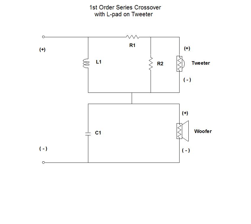

The following is only a suggestion. It may be of interest to use an L-pad instead. This way you could vary the level without the frequency change, and there would be a reduced response variation in general, as you do. This would also reduce any response bump introduced by the tweeter resonance impedance peak.
So, how would you decide which setting of the potentiometer works best (so that you can decide this value works well with the fixed capacitance, when you remove and replace the pot..), because when changing the pot it also upsets the level and makes it hard to decide? Maybe it would be easier to vary the capacitance after removing the pot from its original location and configuring an L-pad.
In your case, the output of the woofers is likely to be reduced at its top end around the crossover. Reducing the value of L1, or increasing C1 are also going to affect the mids. Maybe the sympathetic nature of a series crossover will be partially self correcting. Maybe your ability to change the mid level is fortunate?woofers ... measure 3.6 ohms ... do I now need to change C1-L1 to compensate?

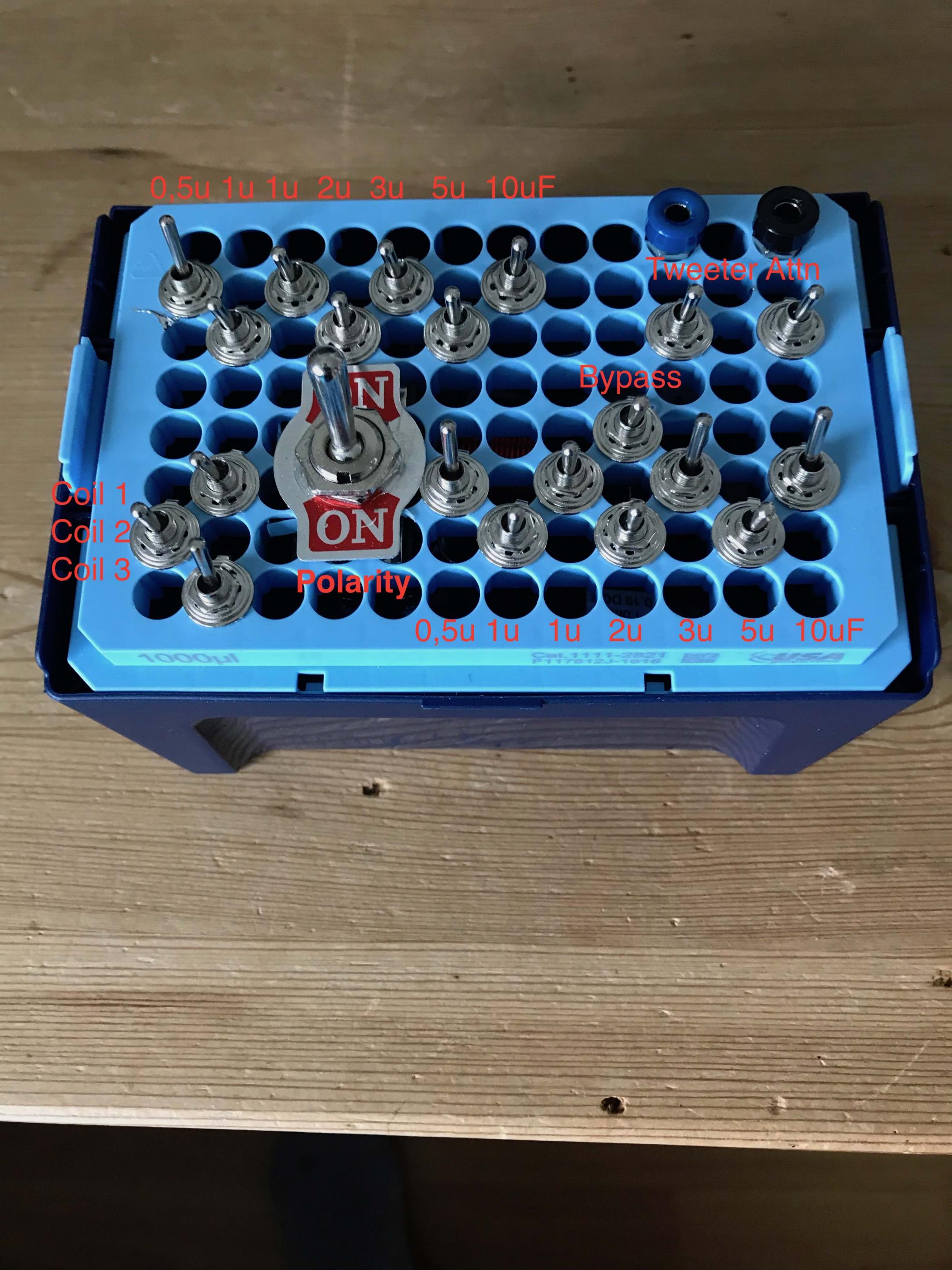

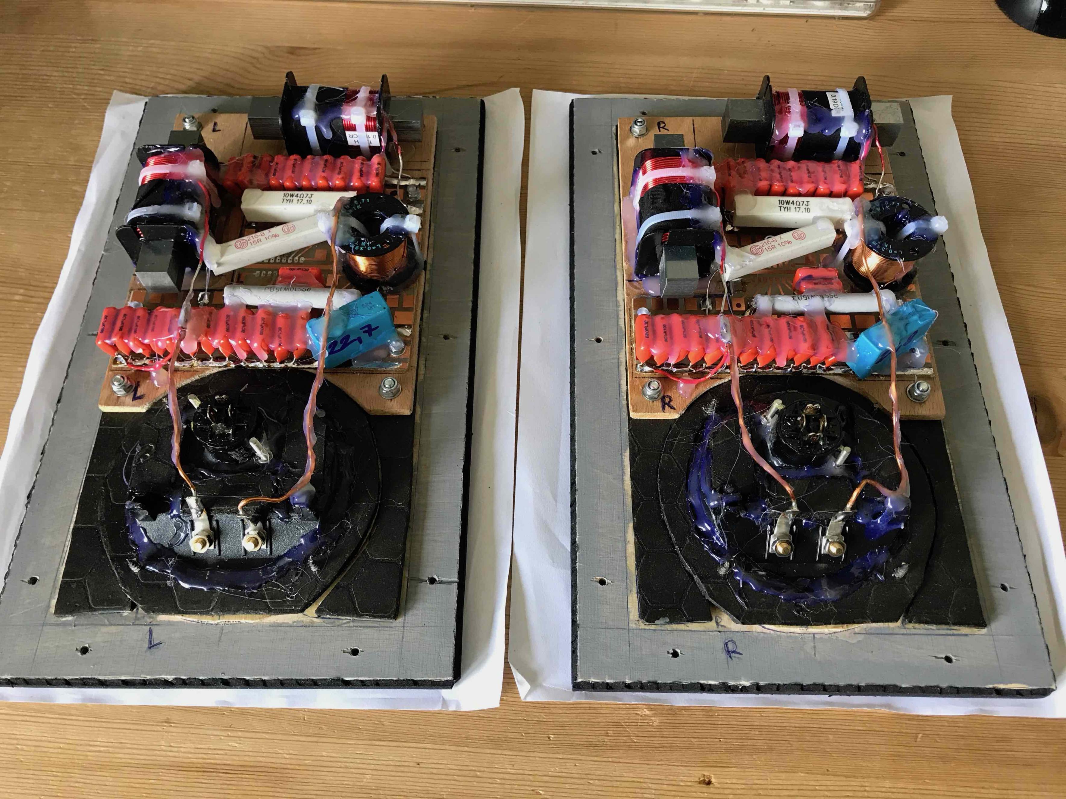

To help myself and shorten the developing time I decided to make kind of universal crossover and play with parameters live while listening.
Inside of blue box was hidden 12db or 18 db adjustable high-pass crossover for tweeter with attenuator, polarity switch and choice of 3 different coils… each capacitor bank could go from 0,5uF up to 22uF… in short I could emulate in real-time and listen to the effect.
I have to say it was revelation as you could accurately fine-tune without guess work, but I did not measure final result. This will have to wait until I buy proper microphone.

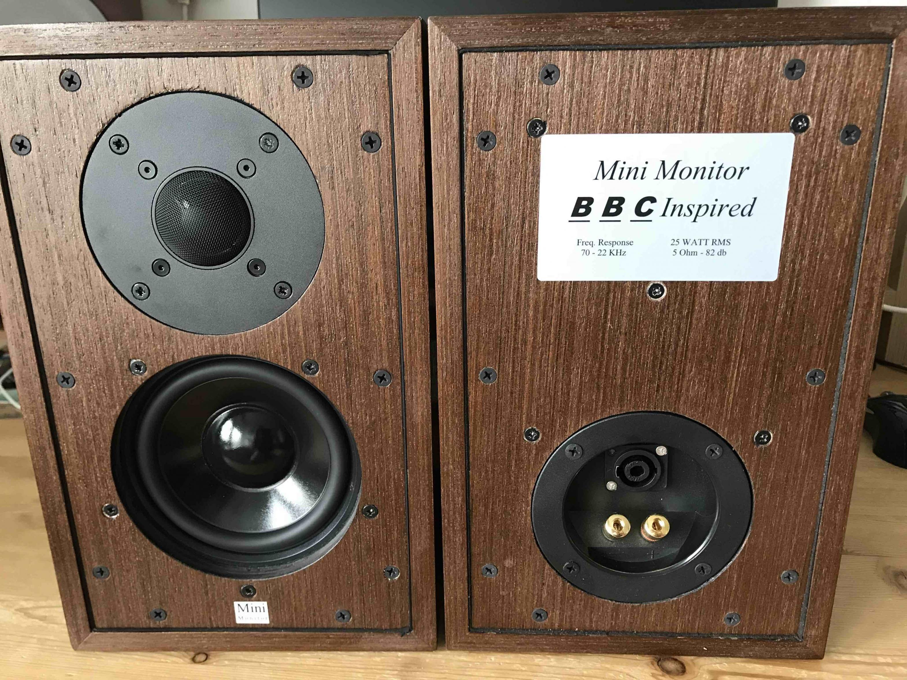

Mini speakers that I worked this time were 2-way closed box design inspired by BBC Research done in the 70’s designing small monitor speakers for broadcast. I did not copy any of drawings from LS3/5a, just followed designed guidelines and choose myself off the shelf drivers I could afford.
Mini monitors are based on Visaton W130S woofer and Dayton Audio RST28A tweeter as the best candidates without breaking the bank.
I finally came to conclusion that 12db crossover sounded best all-round but 18db was a tad more compressed in comparison. Point here is that you would not have idea how what sound unless is accessible on flick off a switch.
Still, the work done on software program was crucial in finding sweet spot to start with, especially low-pass part of crossover, so once I settled on low-pass, I further spent time with variable high-pass to great delight as you could hear every adjustment and spend some quality time in fine tuning and experimenting.
I could post drawing of crossover if there is interest, for time being just a couple of photos of the speaker and adjustable high-pass crossover.
