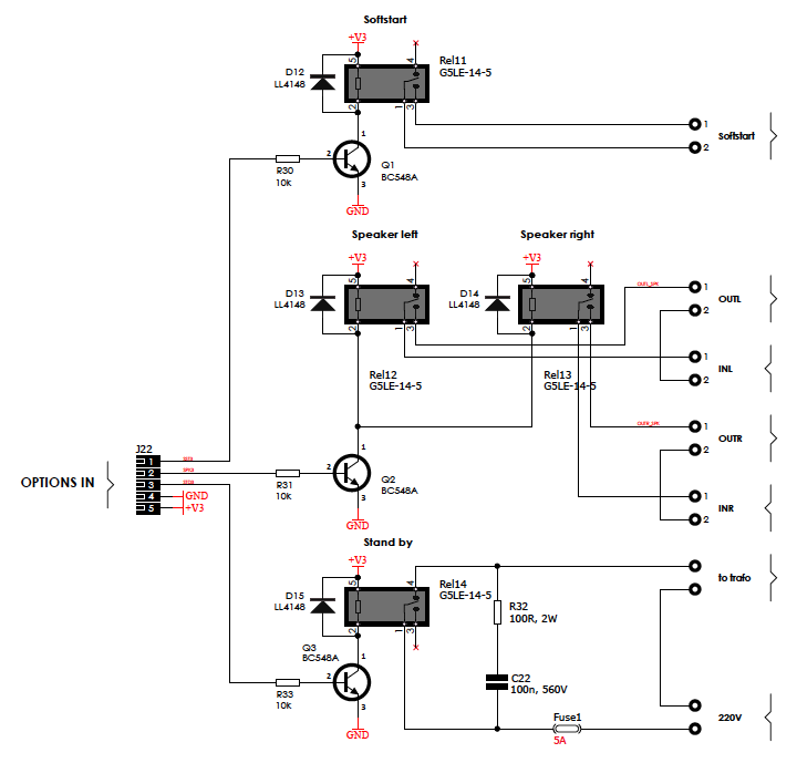

The soft start and speaker relay contacts are closed when the controller is off and open when the controller is on. Anybody else notice this?
We are going to check/correct this.
Tibi

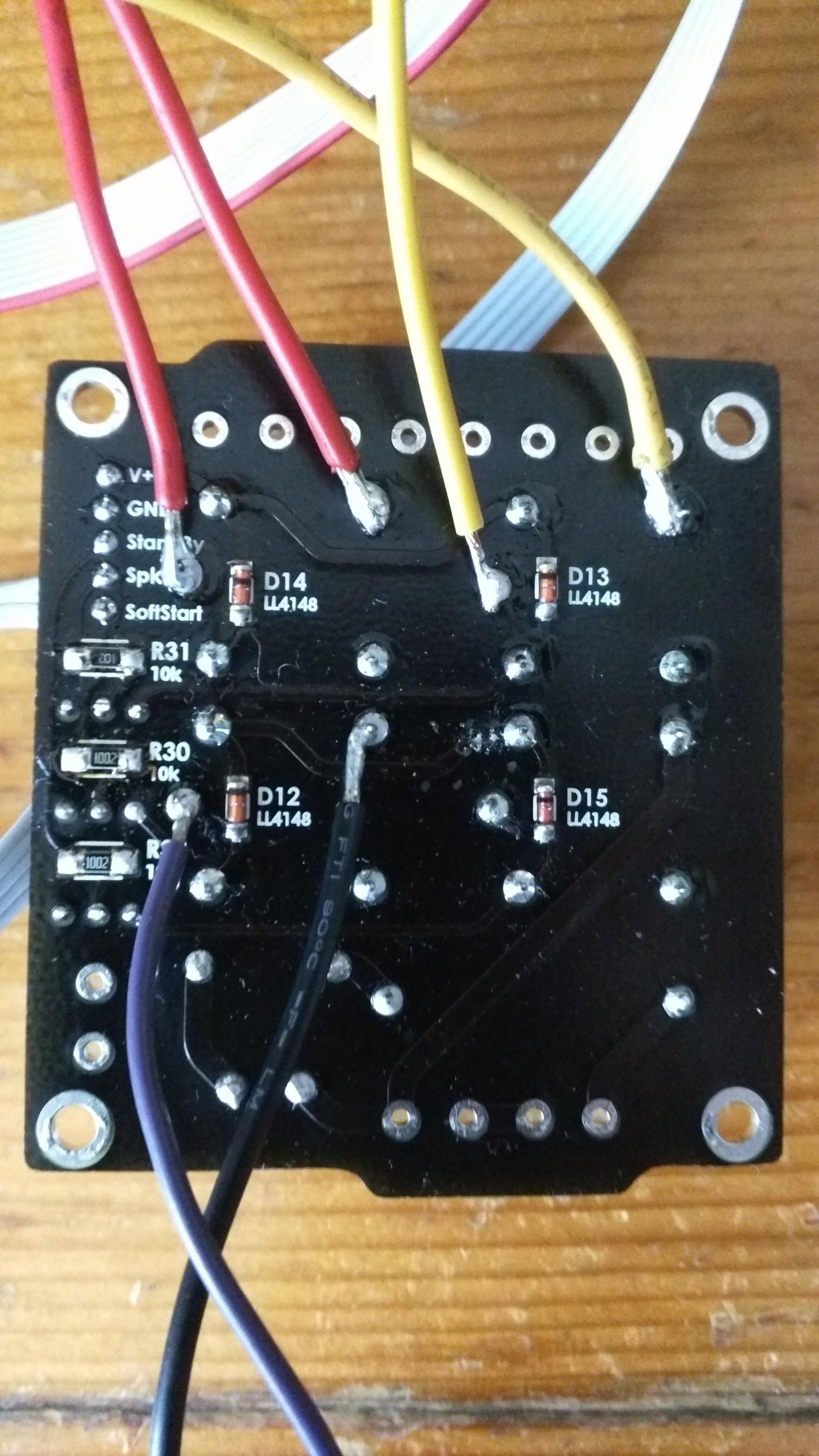

Sorry for that , I can confirm this is a mistake / bug .
It can be corrected from firmware but for those that already purchase and do not have experience / an AVR Atmel ISP cable here is the quick fix in the photo attached - use wire connected to those point of relay (yellow for the left speaker , red for the right speaker and black for the soft start connections)
Those wire attached must go direct for connection to / from speakers and to / from soft start and do not use block connection terminals from board with relay which must be left unconnected .

I am using the Maya in a Preamp/crossover. I planned to have the Maya's power relay board turn on the crossover. When I hooked up the crossover Transformer (15v) to the Maya power relay there were problems. It did not work the way I expected. When the Maya was off there was still 5 volts coming into my crossover power supply. When the Maya was on the crossover power supply was not working properly. This was caused by R32 and C22 (see circuit diagram). I removed R32 to eliminate the RC bridge. Now things work as expected but I wonder what is the purpose of this RC in the circuit?
The role of R32/C22 is to avoid a flame between relay contacts when this operate. That relay should handle high currents for a wide range of amplifiers.
You should not remove these parts. You may adjust them. If you are running a low power device, like your preamp/crossover, than reduce the value of CV22 in 1nF-10nF at min 300V ac.
Tibi
