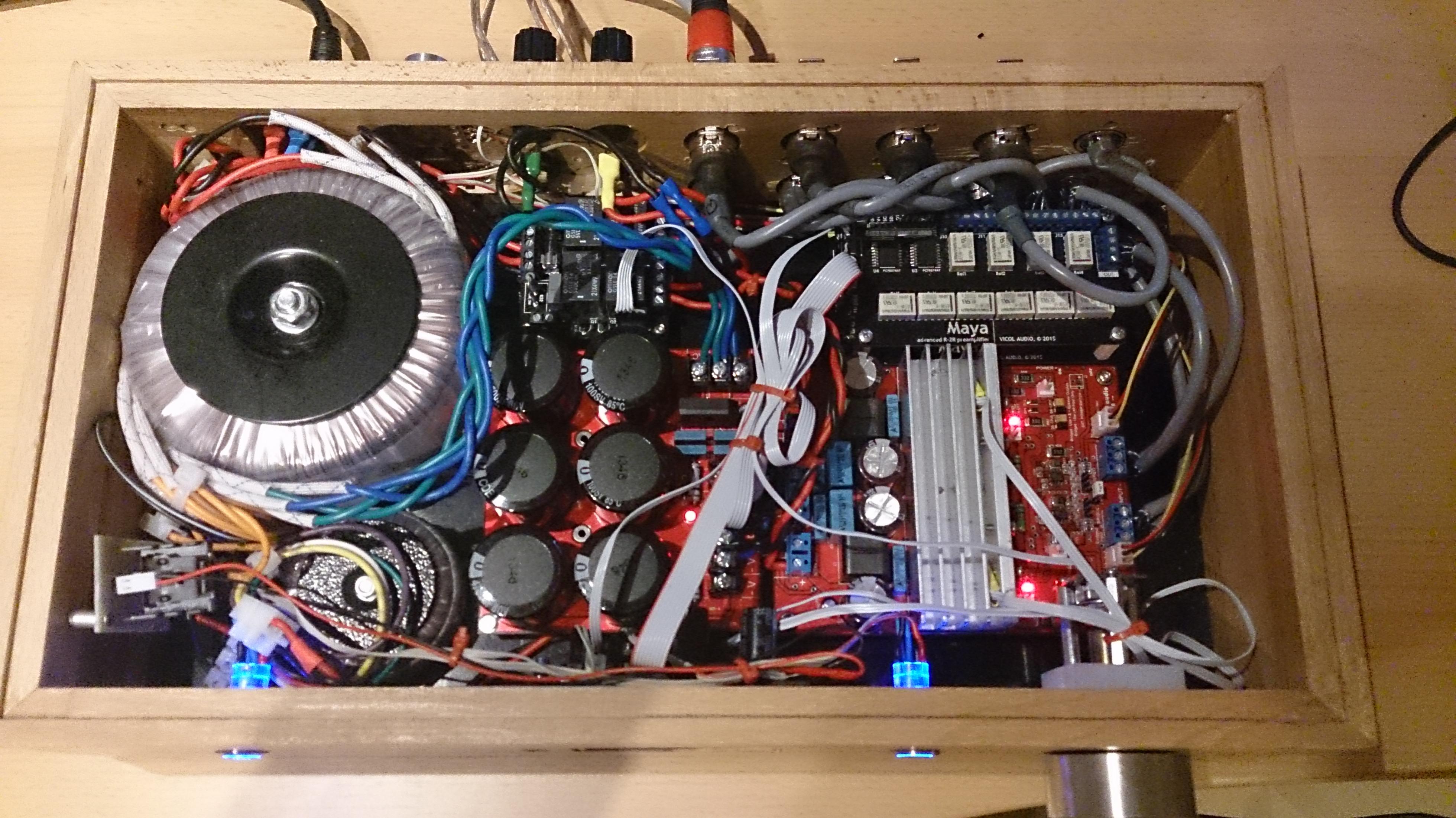

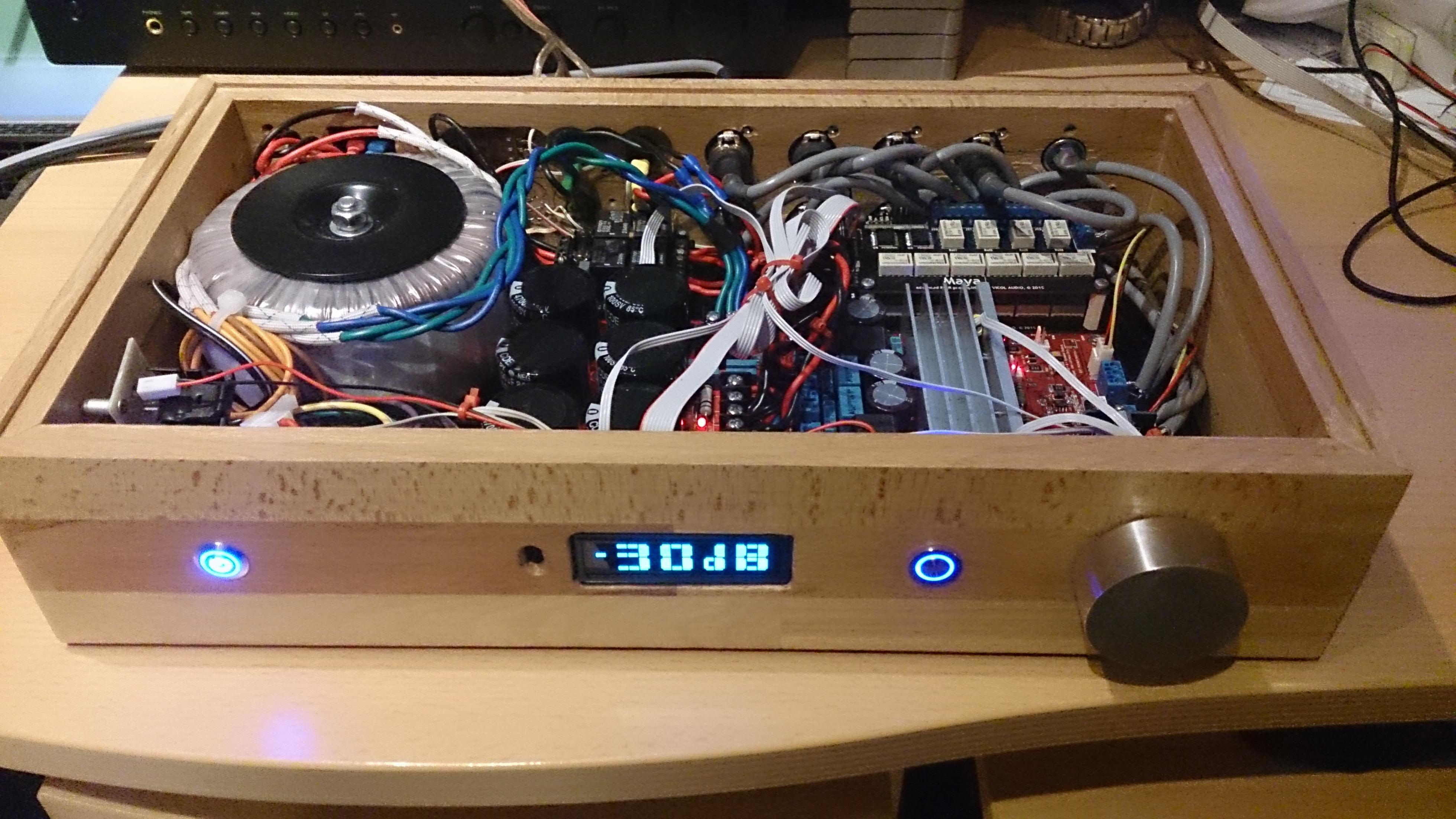

Finished amplifier with Maya control
After some problems at the start with the temperature sensors, I finally finished my little amp.
Thanks to the support of Tibi and Danzup I was able to find and resolve the problem. After replacing the sensors it's now working without problems.
I must have damaged them somehow. Maybe it was ESD.
Anyway I just wanted to say thanks again. Especially to Danzup who even wrote two firmwares in the attempt to find the problems cause.
I enjoyed listening to it for 2 days now and am very pleased with the result.
I'll go back to listening.
Have a nice day everyone 🙂
