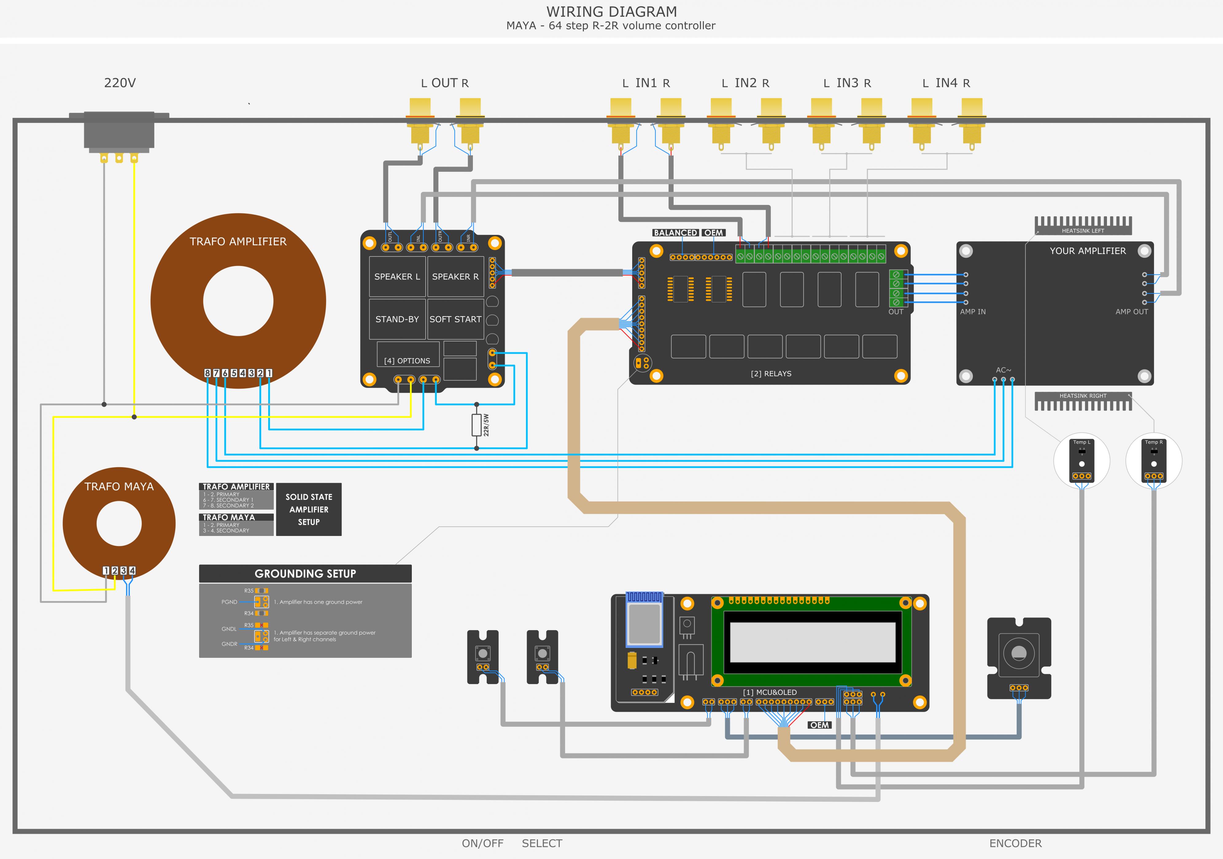

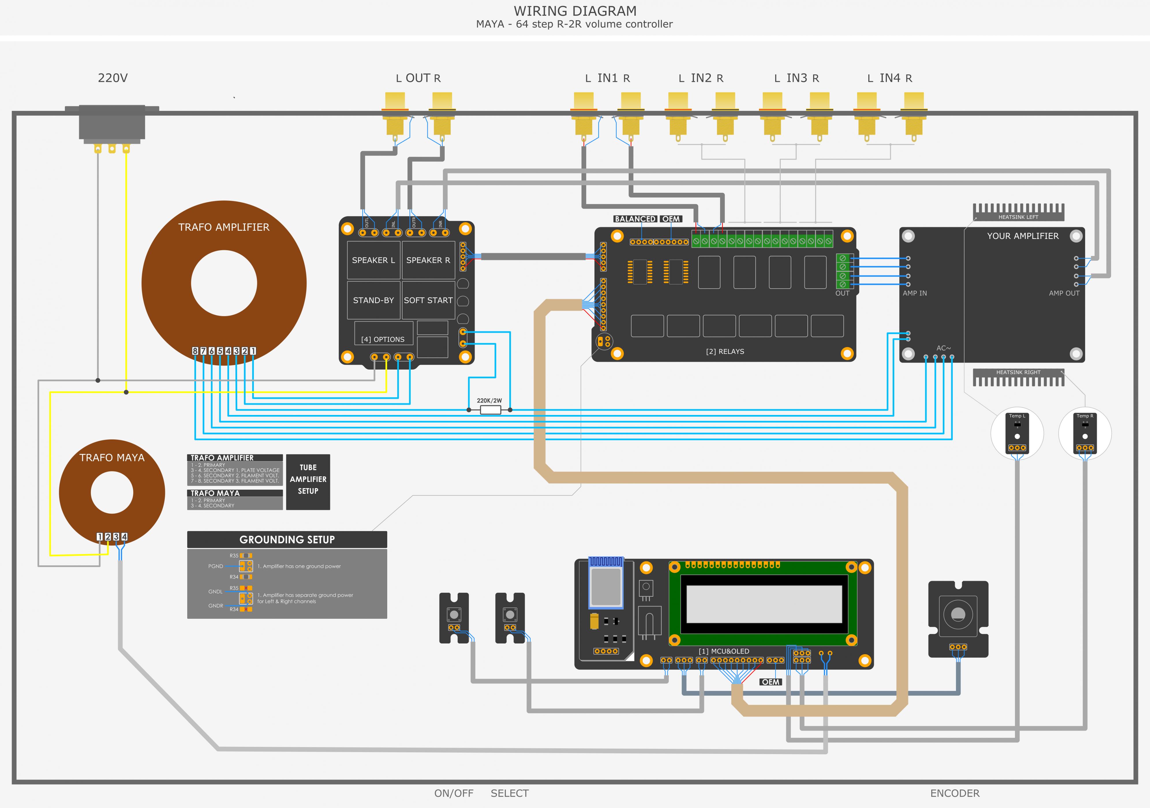

An update document on how to implement Maya on a solid state amplifier and on a tube amplifier.
Tibi
