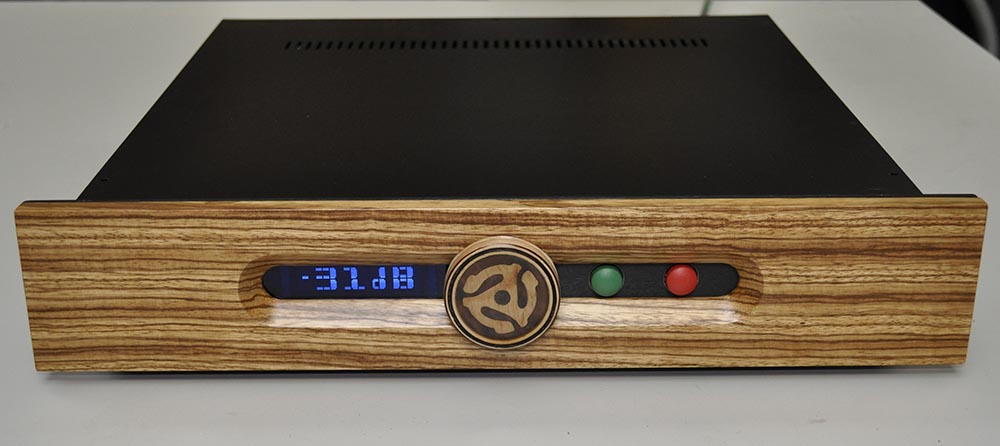

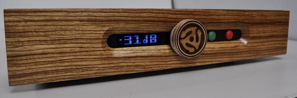

Here are a couple pics of my Maya implementation.
Would any knowledgeable folks here mind taking a look at my Front Panel Express FPD file to help me verify if I have it laid out correctly? It is very similar to the builds done by Lemon and Plan.
That looks great! I really need to learn to work with wood better!
KC
