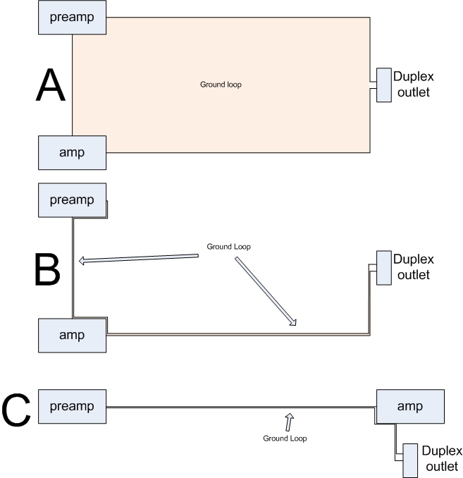

Perhaps, problems would be lessened if the amplifier is built with an AC outlet for source/preamp.
Yes, I agree.. But convince the high end guys to do that...😱
Here's something I put together in dec 2008.
A is the normal setup. edit: it is extremely susceptible to externals, as well as haversine.
B is what happens if you arrange the power of the source to strafe the amp, and you wrap the IC's around the preamp cord. Note that you've removed virtually all the loop area. edit: the loop would be capable of trapping external flux. Note that there is still the preamp ground to amp loop formed that will still couple to the amp haversines.
C is the closest to what you said. edit: It minimizes the coupling from the amp draw to the ground loop. Your suggestion goes one step better than this diagram. as an additional note, this is the setup I used to run 125 foot unbalanced lines from a balcony to a stage.

It is not the responsibility of the IC to decide which path the return current is supposed to take. It's purpose in life is to get the signal to the amp.
It is the function of the system to prevent intrusion of error, and exclude any errors that make it past the front end blocks..
The primary issue is how to keep external signals from getting into the input along with the music. Twisted pairs, coax, balanced are all techniques designed to reduce intrusion. However, implementation of them always has compromises.

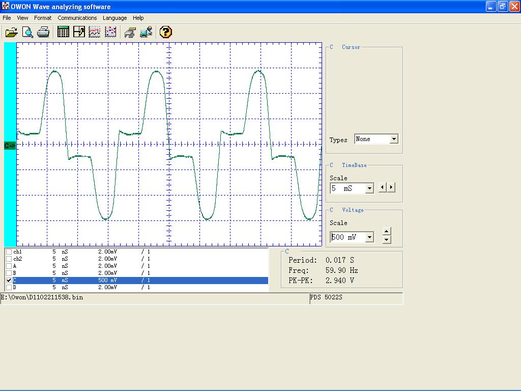

Openings, openings... Haversine = 1/2 Sin Squared of (x/2)
Attached is a real picture of the current draw... not a haversin!
That's all I could find, dude...take it up with the author..
What you posted is the primary side of the transformer, what shows up at the line cord. The paper I linked to was full bridge on ac line, I described the depiction as that on the bridge side of the xfmr...
What the heck is that spike, leakage inductance?
