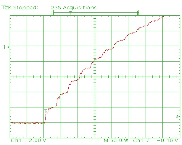

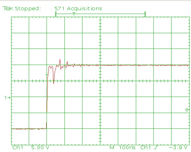

Maybe I could contribute with some illustration here?
Some time ago I have stumbled on this same effect, while trying to illustrate to my collegaues (physicists..) the need to terminate well their link to a detector.
The first shot is a 10V step signal from a 50ohm signal generator into a terminated 50ohm line. The rise time - dominated by the generator - is ~5nsec.
So this is the "intrinsic" speed of the system.

The oscilloscope is showing what is going on at the receiving end. If I lift the termination there, that is the new configuration is:
generator -50ohm back term. - 50ohm line - 1Mohm osc., that is, at the receiving end there is full reflection of the incident wave, then we will see 10V incidental step +10V reflected wave = 20 V step as a net result on the screen.
Plus some reflections coming back from the not fully perfect termination at the generator. The rise time is still less then 10nsec.
The 50ohm line is ~3m long which equals to 16nsec propagation delay. Full trip is 32nsec.
The generator produces the 20V step into the following series system: it's own 50ohm series back termination, the 820ohm resistor, the 50ohm line impedance.
The net current flow is: ~22mA.
Up to now everything is real, resistive, so at the 50ohm line we will see an instant 22mA*50ohm = 1.08 V incident wave step.
Like before, this ~1V incident wave at the other, unterminated end (shown by the scope) will show up like incident + fully reflected wave, that is, a 2V step.
Now this reflected 1V step is traveling back on the line, and gets reflected on the ~almost open (870ohm), transmitter side, and everything restarts again.
This is the mechanism which gives those 2V steps mounting always higher, at each 32nsec periods. Obviously, the initial clear steps are getting "dissolved" later, by the cable losses, by the termination losses, so the height of the steps are decreasing with time.
You can see at the start the waveform looks just like the #925 one, except smaller magnitude due to the 870/50 mismatch. Each full bounce increases the amplitude, but by less each time as some signal gets lost in the back termination.

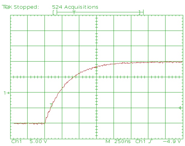

Alternatively, calculate the capacitance of the cable. Then calculate an exponential rise from a CR formed by that and 870R. The result should roughly follow the last picture, but smoothly without the steps.
Also, think of the power stage configuration: It's true that at DC the output impedance is very low, but it rises fast either because of negative feedback, or, with tubes, the output transformer leakage inductance.
The receiver end is badly terminated because of the speaker inductance, at high frequencies. The line impedance is even lower, so nice mismatch is guaranteed.
And yes, DF96, it can be looked upon both ways: lumped element approach or this, t line approach - as You cleared it up with John.
The step height is a result of the reflected amplitude. As the wave bounces back and forth, the reflection coefficient will determine how large each step will be. If the reflection coefficient at the load is -.9 and the source is -1, the first bounce will be 90% of the signal, the second 81%, third 72.9 etc. Yes, cable r and losses will also come into play, but for audio stuff, I'd not consider those at first run.
Yes. For the setup he has described with the 870 resistor, the cable capacitance will dominate the line so a simple RC calc will suffice.

Actually, not exactly. For the example you gave with the 820 ohm series resistance at the generator, there is indeed 22 mA available to charge the line, so a simple RC is essentially good to go.
For a speaker on the other end and a zero impedance source, the simple RC will be inaccurate. When the system has settled down, the load defines the current and the voltage in the line. Not the generator impedance.
The only way to model the system with good accuracy is to break the t-line into many RLC elements. If for example, you use only 1 R, 1 L, and 1 C, you get one result. Use 2, it changes. Use 100, you get much closer to what a t-line will do. But most importantly, you build into the model the line current, line inductance, and line energy storage. I stress the inductance part only because a low value load forces the line to have far more inductive storage than capacitive.
I also use the t-line model to easily include the physical dimension of the line.

I seem to have lost track. Are we still talking about analog audio interconnects and speaker cables? Both of which have bandwidth limited signals or are we talking about signals from an audio point of view that are almost step functions?
An excellent question.
I use an infinitely fast step function. This allows a clean understanding and testing of the system response. As you point out, this is certainly not what occurs in an audio system.
However, using the infinitely fast step in any analysis will provide an ideal settling time. That settling time using such a waveform will give the absolute fastest response the system is capable of with ideal components. Once we start to introduce reality in the form of components and signals, the system response can only slow down....never speed up.
So if the "high speed" system response is 10 uSec for example when the load is mismatched to the cable by a ratio of 100 or so, reality will be even slower. How much slower is unknown given the real components we must use.
It's just a tool to provide level of effect. If it produced pico or nano level times, then it is not necessary to proceed any further.
