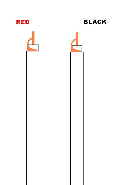

Ok, folks. 96 pages is a helluva lot to go through so I'll take my chances and hope nobody has been writing about UBYTE-2 speaker cable by Thorsten Loesch in this thread. I've got my self a piece of AIRCOM PLUS which should, at least according to Thorsten, be perfect for the purpose. Now, I've couple of questions that I'd like to get answered before I go hands on with that little project of mine.
First, I'd like to have it confirmed by some independent source, like you guys here 😉, that a cable set up like this really works as prescribed. Thorsten Loesch is well renown within HiFi community, especially in the UK but it never harms to get a second opinion.
Second, how much of the UBYTE-2's properties would be lost if I skipped cross coupling the coax cables and just run them "plain" as seen on the image below? Ie just connecting the shield to the inner conductor.

I believe by cross connected you mean each amp and speaker terminal is split between one shield and the other's center?
That configuration reduces the overall cable inductance by reduction of external field. It's just another tradeoff between L and C. Remember, for cables, the LC product is fairly represented as a constant...it is exactly represented as a constant only for pure coax and wide stripline constructions.
To actually calculate the inductance, you need to know the resistance of the core and shield. Then, one can calculate the system inductance as a sum of the coaxial inductances plus the external parallel wire inductance. Note that if the core and shield have identical resistances, there will be full cancellation of the parallel wire field, leaving only the two coaxes in parallel operation.
Your re-drawn configuration will not cancel any inductance at all, and the inductance of the cable will be easily calculated using the terman equation, that is the same as a zip wire. It would be exactly like a pair of conductors of equivalent guage.
For either case, I'd still recommend twisting the two together to keep the inter-conductor spacing as low as possible.
As for audibility, I've seen no test data to indicate differences which were discernable in controlled listening..so I cannot say what the functionality will be..just the science man....nuttin but the science..

96 pages might be a lot, but at least you could check out the heading, it says "..lies about interconnects", not speakercables.
All conductors will "conduct" more or less, but a tiny coax (like all other tiny conductors) will kill the dampingfactor or the amps ability to breath, like a restrictor on a racecars carburator kills power.
No part of any signal should ever run through shields like this, only single massive conductors if you want it to stay clean.

By cross connected I mean exactly what you wrote, each amp and speaker terminal is split between one shield and the other's center as seen on UBYTE-2 page I linked to.
What I really want to know is whether I need to go the lengths Thorsten's proposing or if I can get away doing it "my way" as seen on the image I attached in order to get an equal end result ie providing myself with a reasonably good speaker cable. I'm aware that my configuration doesn't make any contribution when it comes to reducing inductance or capacitance or resistance for that matter it's just that it's so much easier to carry out practically. No need for soldering or crimping or anything of that kind. But if you think that my configuration will worsen the cables properties when compared to UBYTE-2 then I'm ready to make sacryfice of getting my fingers burned by solder iron.
Then yout recommendation of twisting the two together to keep the inter-conductor spacing as low as possible. I'm not sure I can do that considering the thickness of the coax cables involved (10,3 mm). Maybe keeping the two in parallel packed closely together or slightly twisted will do the trick?

Speaking of people not reading what's written, I can't for the love of god understand how you can call the Aircom Plus a tiny coax.
