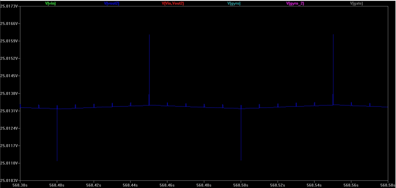

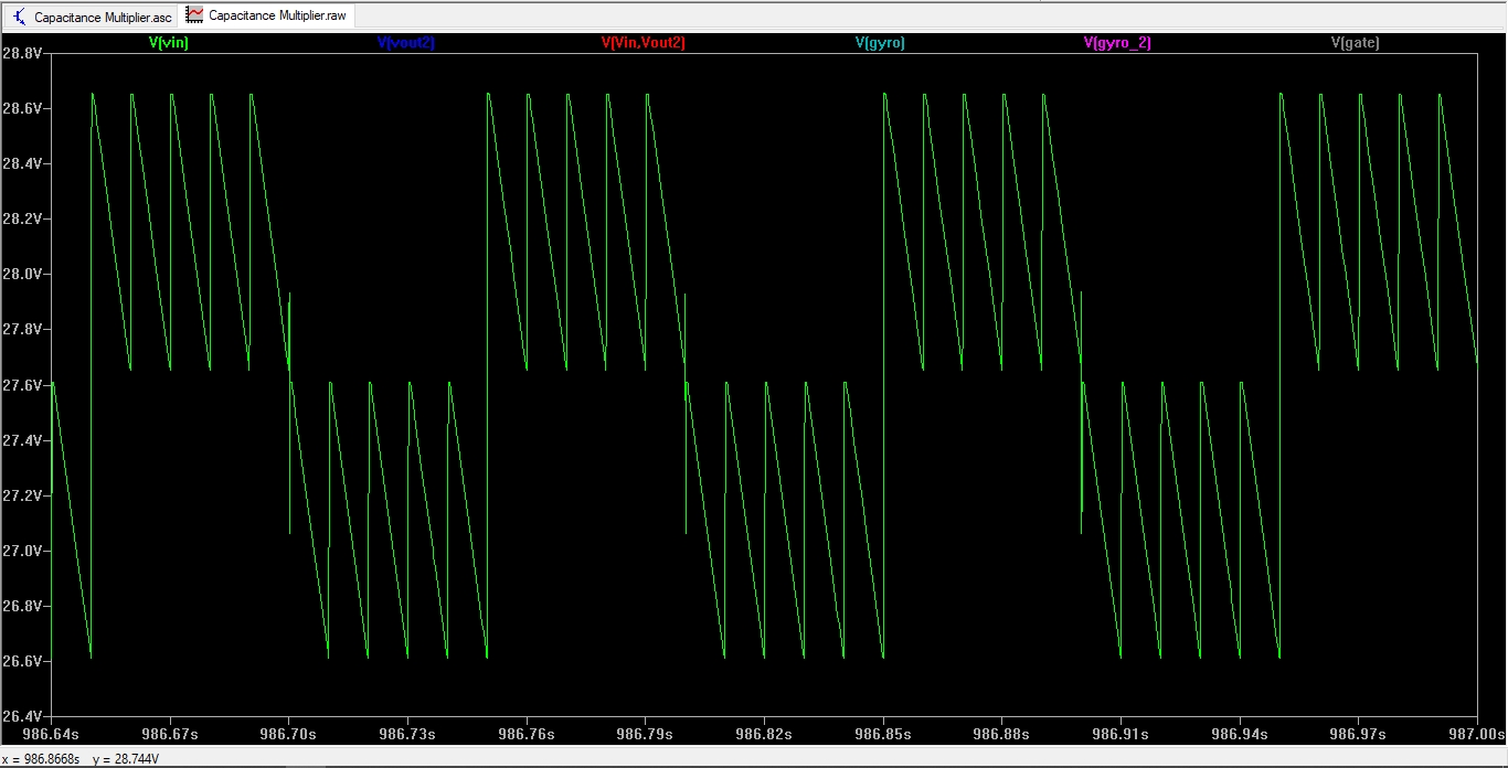

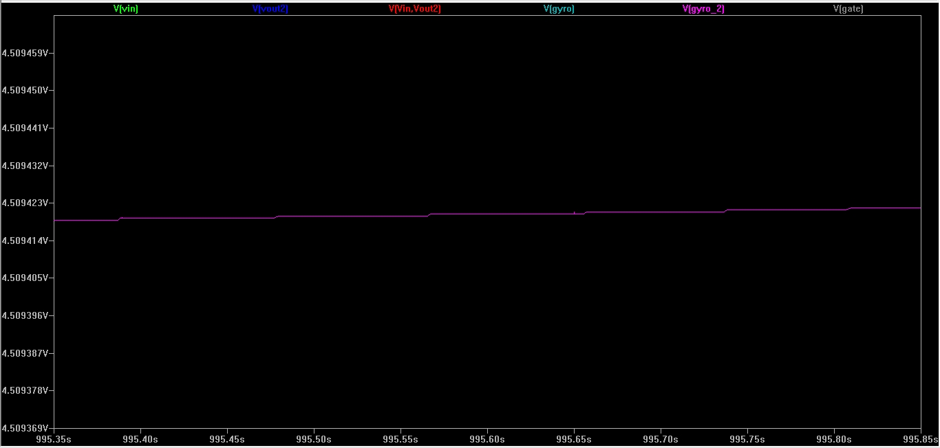

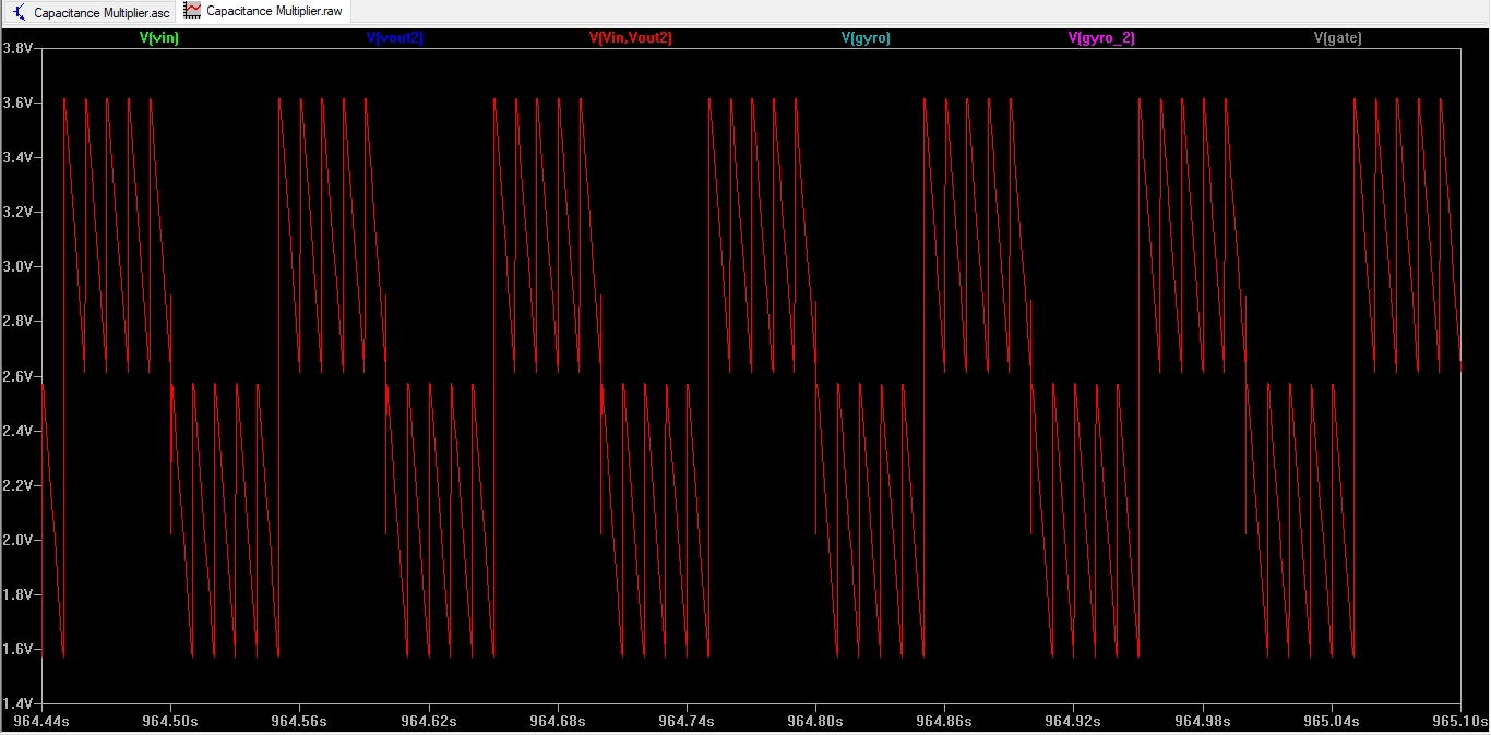

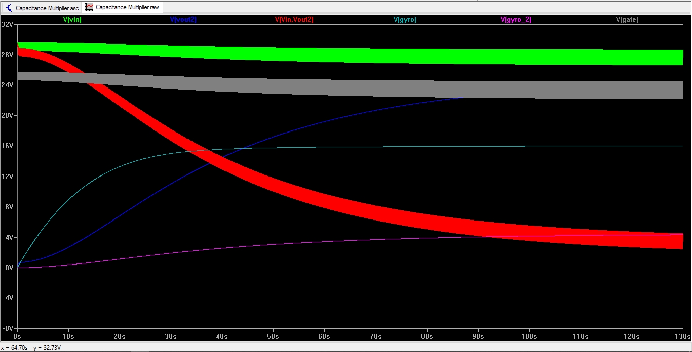

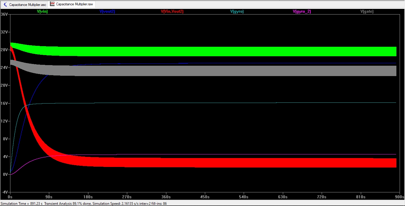

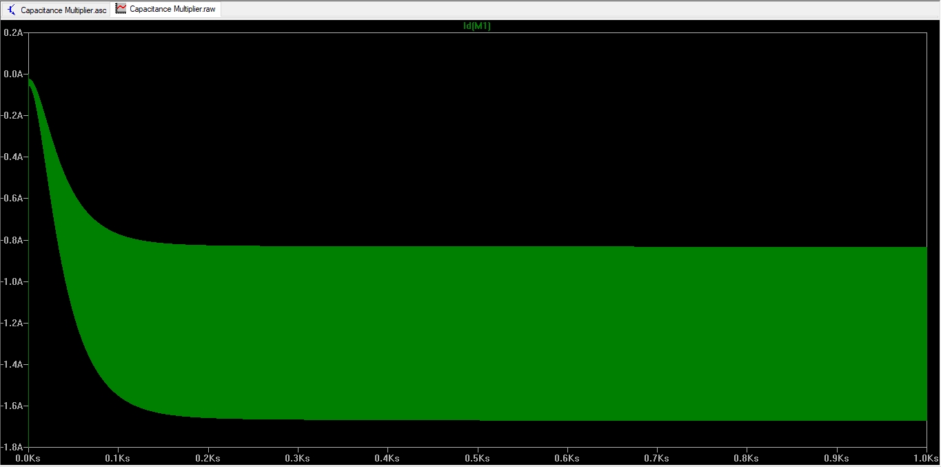

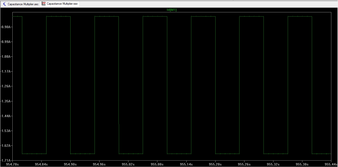

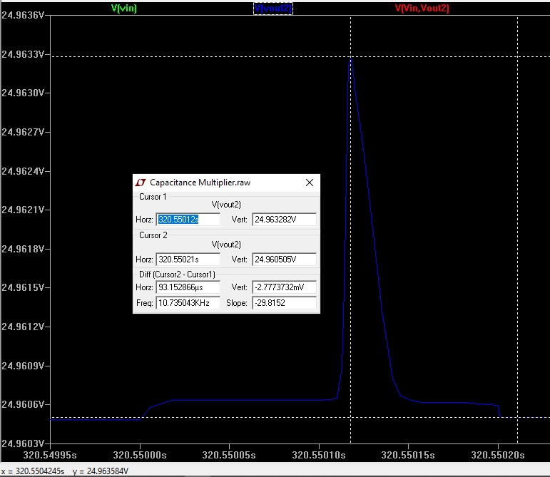

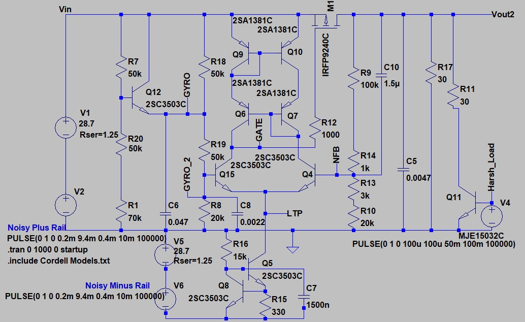

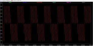

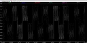

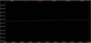

Did some reading. Learining. Experimenting. Came up with these results, in hope to modify, better the original circuit (created by Borys, from Poland):
http://iamp.diyaudio.pl/files/capm_v1_1_schematic.pdf
CapM V1.1 - iAMP - DIY way to build Your own amplifier
Here are my files, pictures. Will come back here and add some questions regarding this stuff in an hour or so. Basic questions are:
1). Can I do better?
2). What else in terms of LT functionality would I need / want / wish to test here?
3). What about FFT? Distortion? S/N? How do I approach those areas?
Capacitance Multiplier - Output Voltage stability - spike.jpg107.7 KB · Views: 94
Capacitance Multiplier - Output Voltage stability - spikes.jpg65.9 KB · Views: 88

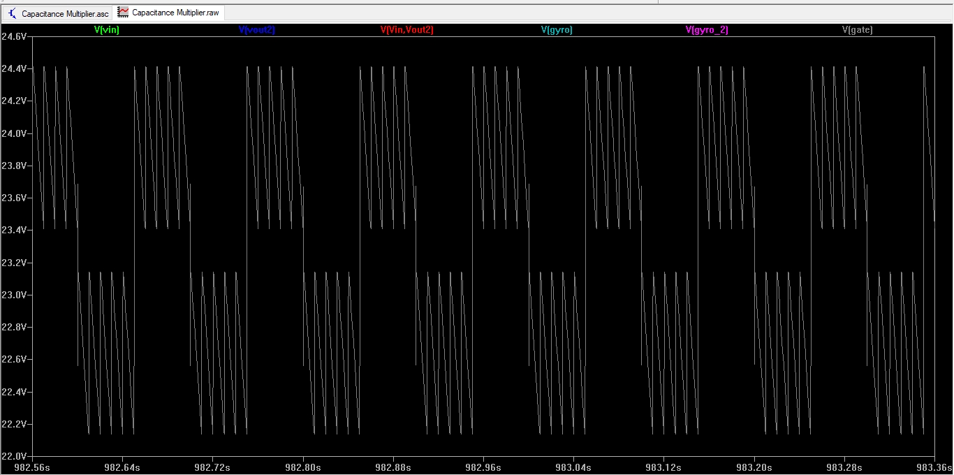

Capacitance Multiplier - Transient Analysis - Voltages.jpg133.1 KB · Views: 84
and the circuit schematic ...
I noticed that the simulation to run in full - it takes multiple minutes to finish, or at least to show the stable state. How can I force LT to conduct the simulation quicker? As in: not so much detail, but a quick general presentation of what is going on?
I seem to be blind, or do not see the differences introduced by changing the C10 'speed-up' capacitor. Changed it from 100nF to 1500nF. There "should" be some difference noticeable ... Where best to search for it?
If I were to measure / symulate the S/N, noise rejection ratio (line voltage regulation, load current regulation), is there any method where I could actually put in the "formulas" that calculate such S/N and display the S/N graphically, for example as a function of frequency?

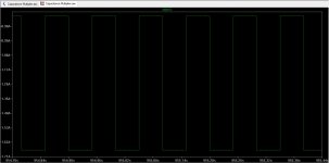

... here are two screens showing the modulated output current. Mimicking a harsh digital load (keyed transistor, switching one of the load resistors).

... Pro forma: one more thing. in order to open my "Capacitance Multiplier.asc" file,
as posted just recently, you will also need to have the referenced "include" file in the same directory. The file can be downloaded from Bob Cordell's webpage:
http://www.cordellaudio.com/book/Cordell-Models.txt
One other thing. "R13+R14" jointly constitute a "trim-potentiometer", at a pre-set position. The trim-pot normally would regulate the amount of drop-out on the series pass device.
I did not know how to present that otherwise.
Too big a dropout - and too much heat would be dissipated on the pass device.
Too small a dropout - and the device falls out of regulation, the gate voltage starts to go crazy, and the output voltage becomes contaminated with noise.
