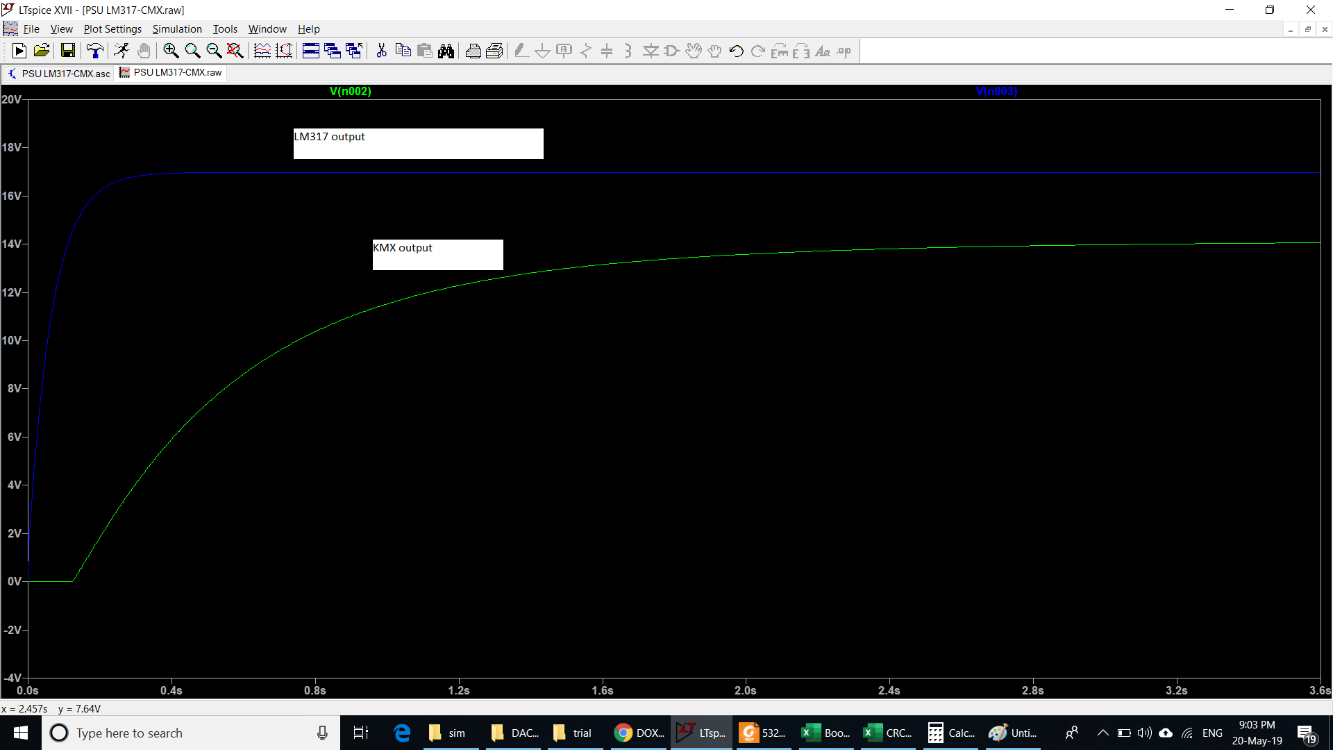

Attached is the sim of LM317+Keantoken KMX.
The KMX output voltage rises slowly to about 14V after about 3.5 sec.
Does this imply that it will minimize start thump noise in a head amp?

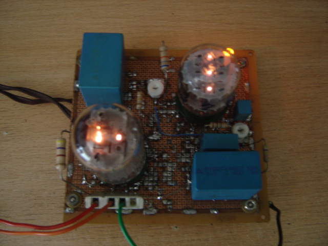

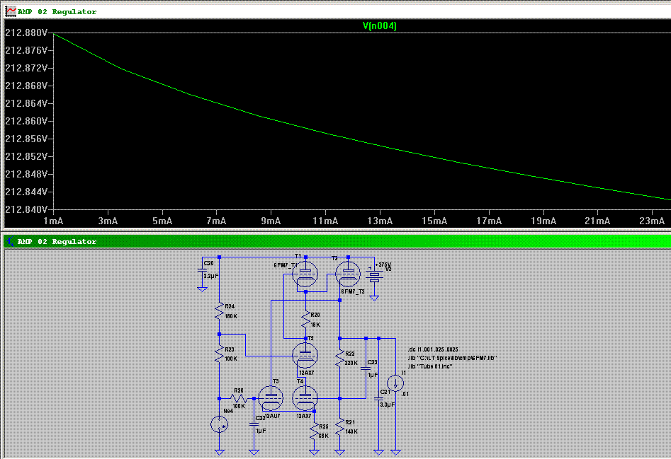

Hi Mooly and the guys here. I want to simulate a linear regulator with a 6FM7 and 6K11, properly working in real world. I would want to simulate it with some variations in the reference neon lamp (Ne4) automatically, like 75±5V and how it reflects in the performance of the device. How to do it if possible?

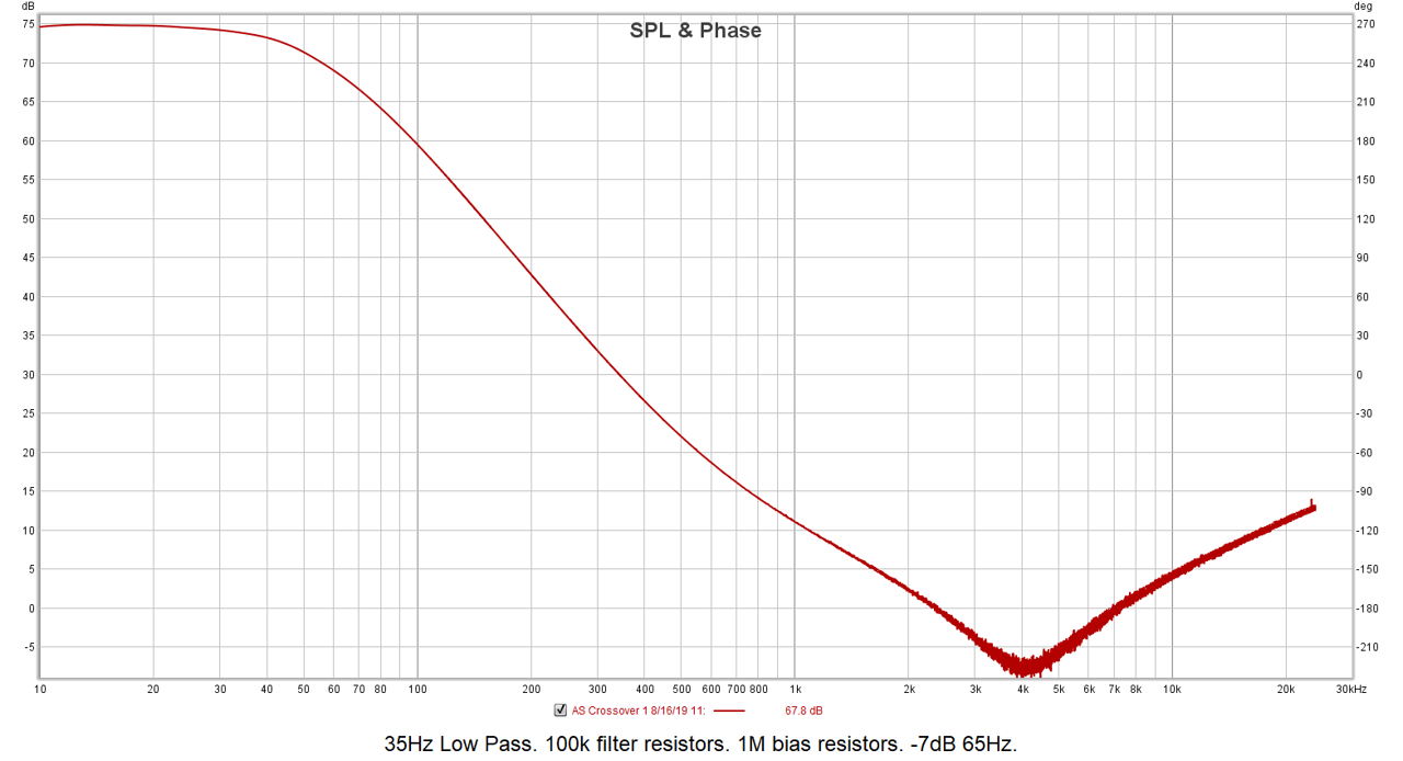

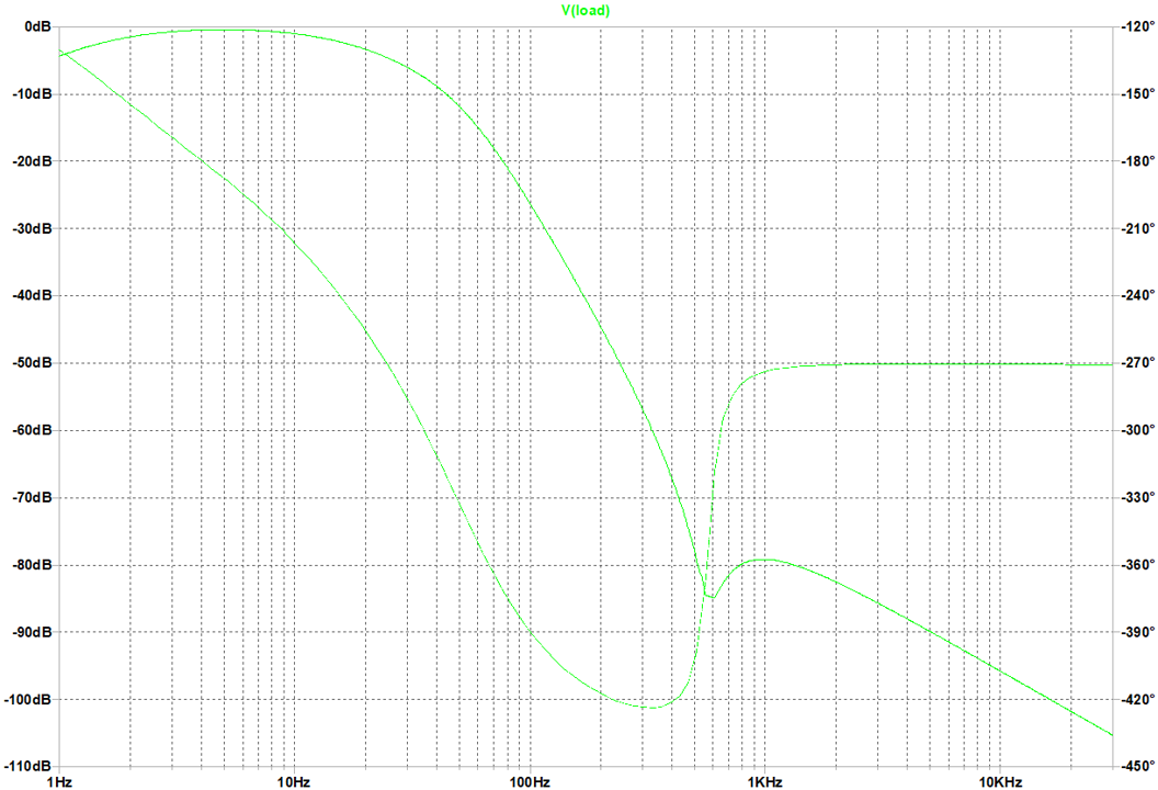

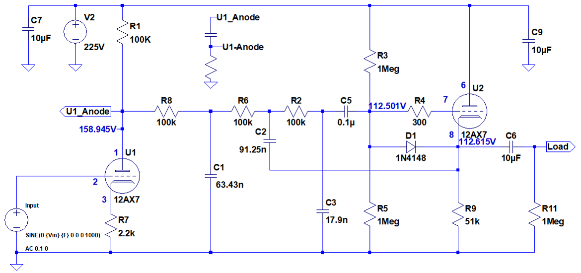

Hi, I'm changing the crossover points in a 4-way tube crossover that I didn't build. I'm having trouble getting the simulated and measured frequency responses to match. Specifically, the simulated crossover point (~-7dB for an 18dB slope) is 35Hz. The measured crossover point is 65Hz. I've attached the model of the bass filter, schematic, simulated frequency response and measured frequency response. Can anyone suggest how I might improve the match between the simulated and actual frequency responses please? I know the filter should be driven from a low impedance source but I didn't design it and I have to work with what I've been given.
Thanks!
