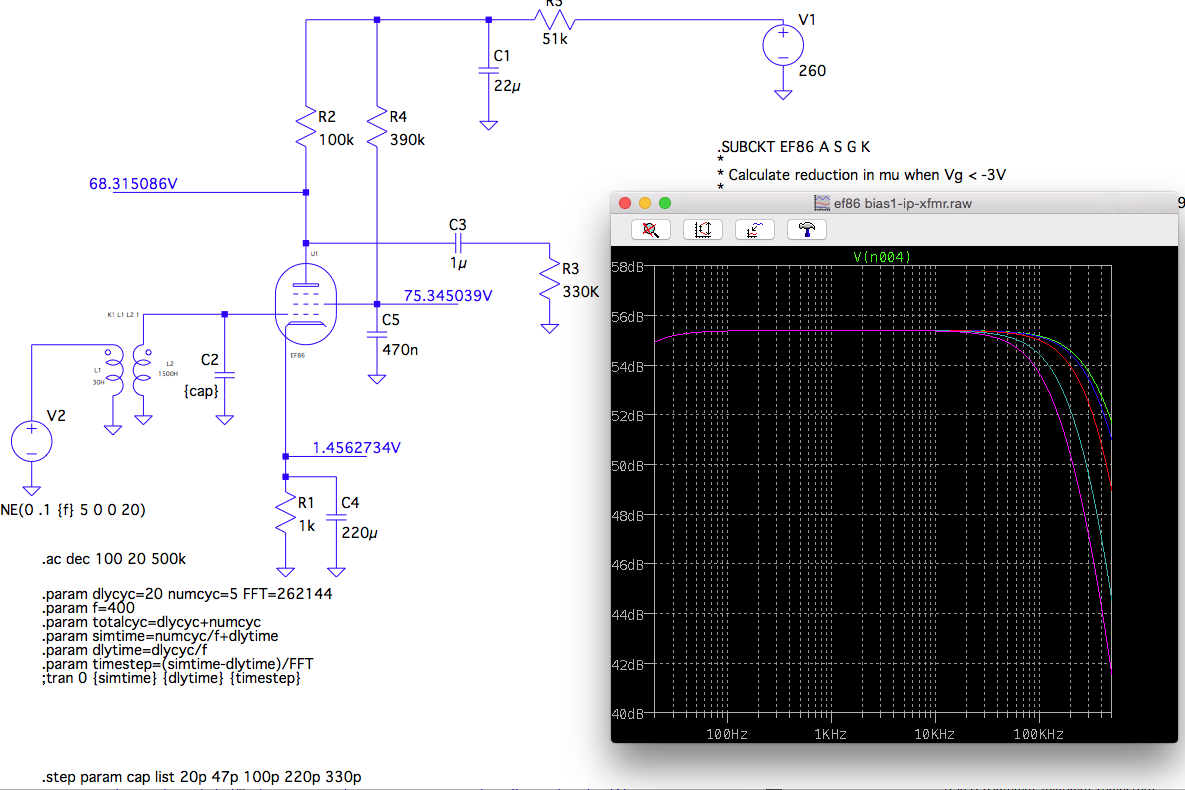

Jan and I were approaching calculations from different angles. Here's a modification of Jan's to go with post 13 I think
SINE(0 0.1 {f} 0 0 0 {totalcyc})
.param dlycyc=920 numcyc=80 FFT=262144
.param f=4000
.param totalcyc=dlycyc+numcyc
.param simtime=numcyc/f+dlytime
.param dlytime=dlycyc/f
.param timestep=(simtime-dlytime)/FFT
.tran 0 {simtime} {dlytime} {timestep}
where if not obvious
totalcyc = cycle total
numcyc = cycles to sample
dlycyc = cycles before analysis
simtime = total sim time
timestep = time step
dlytime = time before analysis
Lokks about right?

What i was troubleshooting was just newbie stuff, and the classic EE issue of when one small thing is off everything is. So I isolated my ef86 ckt, made sure small signal inout was 1, put the ef86 duncan model in the asc file and bingo. finally some love. the step cmd is darn tooting' cool!
funny that the .include didn't work

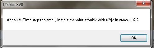

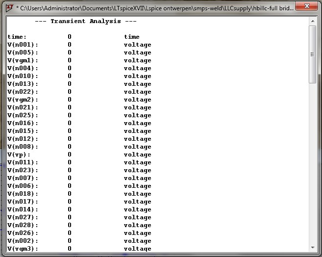

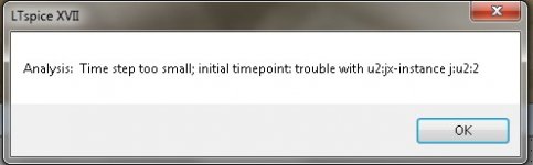

Almost all AD types of opamps like the 843 does not work, I get a error simulating and strange zero voltages.
Is this known in these models?.
regards

Keep in mind Osvaldo, you may have to change all the "^" to "**" for LTSPICE. it took me a week of head banging to finally ask about that.
