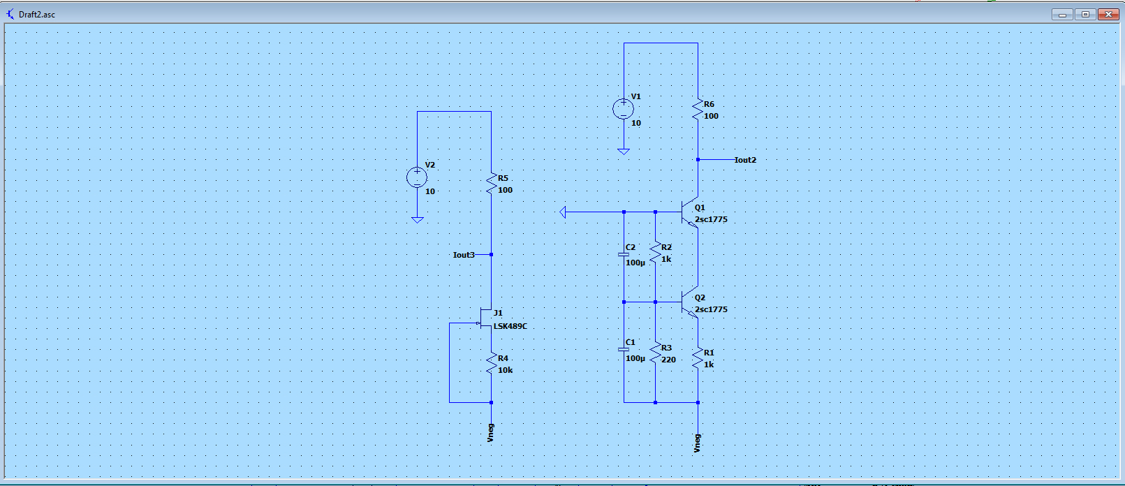

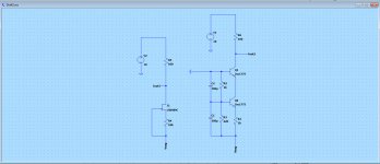

Hi all,
Hmmm ... I reckon this may have been discussed here so I hope you will bear with me if I address it again ...
As it is I am in need of measuring:
- the output impedance as a function of frequency, and
- the noise level - also as a function of frequency
of a CCS in LTspice (a couple of possible circuitries are attached to this post. Component values are just tentative).
Output impedance measurement
In order to "isolate" the output impedance I have inserted an LTspice constant current source in place of the 100 ohms resistors in the two circuitries in the attachment. As far as I can see these current sources have a 10e17 output impedance and thus (much) higher than the circuitries' own impedances. This appears to work reasonably when doing an AC analysis ... I get some curves that show a rising tendency going up in frequency. However, it would be great if I was actually able to see what the output impedance is at the various frequencies? Anyone has some ideas for this?
Noise measurement
Also, in terms of noise (current sources removed and replaced with not 100R but 0.1R in the two circuitries) I get some somewhat odd values - several millivolts up to ~1kHz when I ask LTspice to measure noise at Iout2 and Iout3 ... I reckon my way of measuring is not correct - so I would much appreciate if one of you may suggest a reliable way of measuring this noise 🙂
Thanks & cheers,
Jesper
To directly plot the impedance of the second circuit you would right click on a trace name in the waveform viewer and enter this:
V(Iout2,Vneg)/Ic(Q1)
You will get a phase and magnitude plot. If you right click on the magnitude scale, you can change between Bode, Cartesian and Nyquist coordinates.
The stimulus source should modulate the input voltage. Note that the stimulus source can be anywhere that doesn't get between the voltages/currents being probed, as for a constant impedance V/I is the same regardless of the magnitude of V.
To see just the real part of the impedance you can use
re(V/I)
For the imaginary part you can use
im(V/I)
And the Bode equivalents are
mag(V/I)
ph(V/I)
All this and more can be found in the LTspice help file in the waveform viewer arithmetic section.
If you want to plot capacitance, you solve for capacitance in the capacitive reactance equation:
Xc = 1/(2piFC)
C = 1/(2piF*Xc)
Which in the waveform viewer would be entered as:
C = 1/(2*pi*freq*(V/I))
Where freq is the instantaneous frequency variable provided by the waveform viewer for just this purpose.
Same process works for inductance.
However, this results in a plot that treats resistance as if it were a capacitor with frequency-dependent capacitance (the same is true for some cheap capacitance meters). For this reason if the capacitance is smaller than the series resistance, the plot will be wrong. In order to get around this you can operate on just the imaginary part of the impedance using:
C = 1/(2*pi*freq*im(V/I))
This way it tells you the correct capacitance.
Note that all these plots are only showing capacitance when the line is horizontal, this means capacitance is constant with frequency. A capacitance that is not constant with frequency is not a capacitor, but something else.
