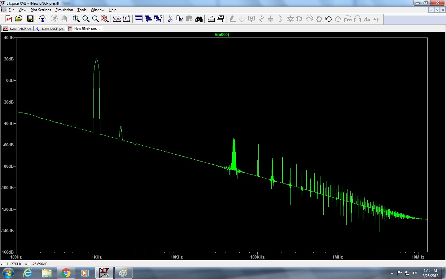

It was pointed out to me that my DC voltage source was upside down. Kind of like, "Sir, your fly is down." I found the problem. I had put the numdgt=12 and plotwinsize=0 in the transient command which Spice didn't like. When I removed it the graph came back. I've attached two more JPEG's. "FFT With" is with a specified time range.

Thanks guys, your advice helped a lot. Again. I'm posting an FFT of the preamp design. While my question isn't specifically a Spice question it arises from Spice and should be easy to answer. The run is set at .5 volt input at 1k with a 30 volt output swing. My question is this, there is a large bump in distortion at 140k. Is that distortion parasitics? And is there way to eliminate it? Or does it even need to be eliminated?
You missed this?
http://www.diyaudio.com/forums/soft...ice-iv-beginner-advanced-106.html#post5353280
Jan

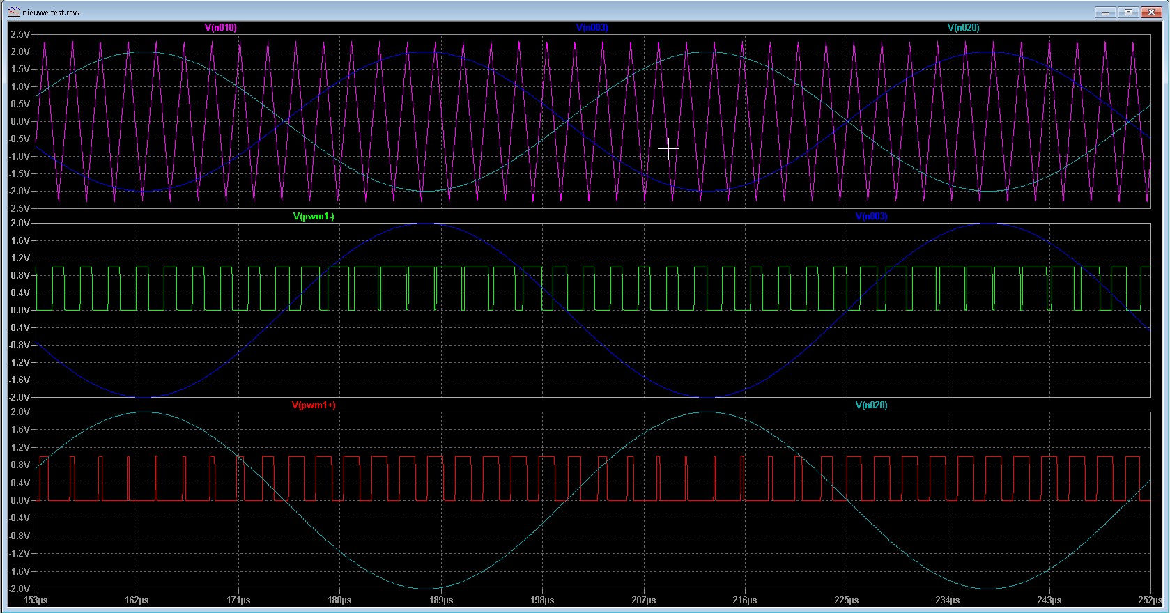

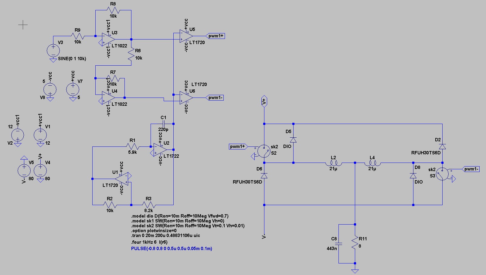

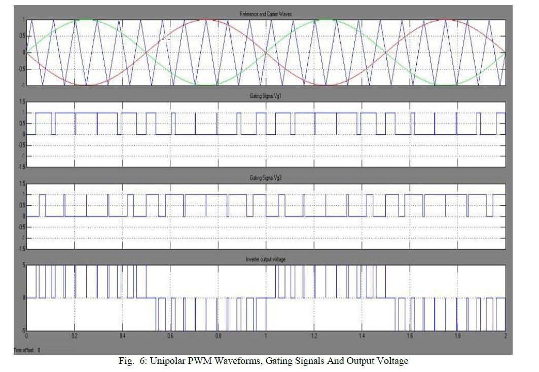

I try to model a unipolair class d amp, but it does not what I want, strange output signals for example and uge currents. looks like fases are wrong, see picture 1 and 2 for comparison. such a simple topologie and not see what is wrong, I shame myself.
maybe someone sees the problem and give hint, building schematic as with the paper, did not work, something needs to me done..
Maybe when I get tip, I see it, can be a slight small error, who most of the time is not seen. but I think it is signal input fases is wrong, putting the sinusoidal input not 180 Degree but in fase into the two comparators I get the signal you can see on pic 1 who is the right one.
i did see also some pieces where two in fase input sinusoidals but with one plus and one minus offset and placed inside a triangle is also used. mucho possibillities, but can it be simmed.
thanks.
