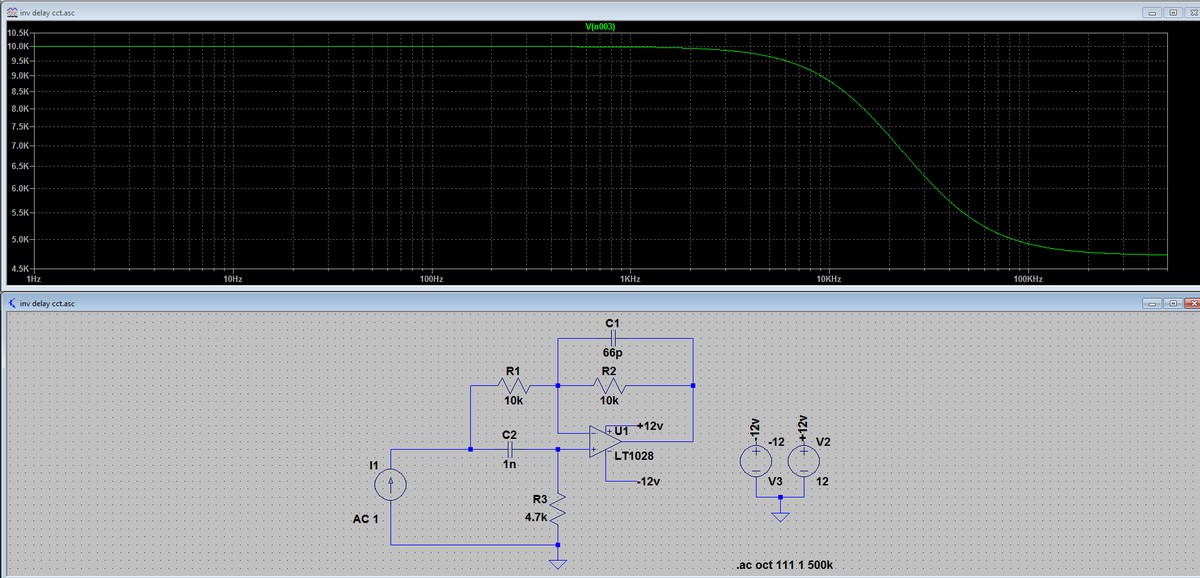

Make your .asc file available, that will ease the discussion.the methods in posts 1096/7 give the same results for input impedance, however the results alter with the opamp used i.e. LT1028 13k2 at 100hz and 3k9 at 100k, whereas for a "universal opamp" I get 20k at 100hz and 3k9 at 100k.
I have my strong doubts about the OPA differences that you mention.
That's correct and since you seem to know this, look at the specs and correct this for the circuit that you use.I thought the circuitry used would define the output impedance....
If you want to really measure it, measure the output voltage V1 without load and V2 with load resistor.
Output impedance can now be calculated by Zout=Rload(V1-V2)/V2

is this it?Make your .asc file available, that will ease the discussion.
ctrlx, you have your -12V wrong. You have it set as -12, with the + to ground and output from the -. You have to either flip it over so - is to ground and output is from +, or change it to 12V without the - sign. Basically you're making it negative twice which cancels out and makes the output +12V.
Exactly, that's it.😀
And as a free service, I have calculated output impedance for you:

Thanks guys - the psu was the problem, I changed v3 to 12 (from -12)
the input imp is now 10k at LF and 4.7k at HF
With the circuit now working properly, I also can see the load placed on the opamp (opamp Vout/opamp Iout) which is 10k for all frequencies... adding an additional 10K load increases the overall loading to 5k (as expected) (both tests done using voltage input source)
can you give me some more detail regarding the output impedance setup?
If you're using the current source method just move current source to the output and ground the input.

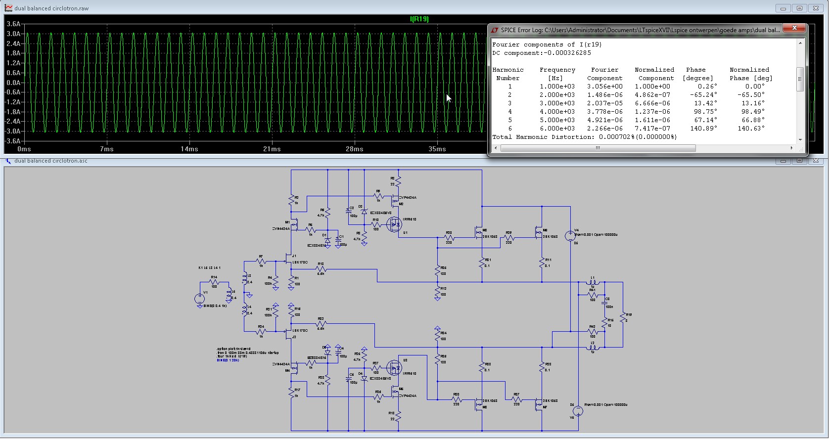

Hi All
I get a hanging sim, jumps just between defcon 1, 2 on 15 procent, maybe oscillation in the amp, but these did wel a while ago, I have a tread of also, it is a circlotron.
Maybe someone now what happens?, maybe I do have a wrong setup.
I have found that the 32 bit old version do well. after look at it, it seems the standard setup is different in the 64 bit version, alternate is there normal, setting it also alternate it did work.
regards

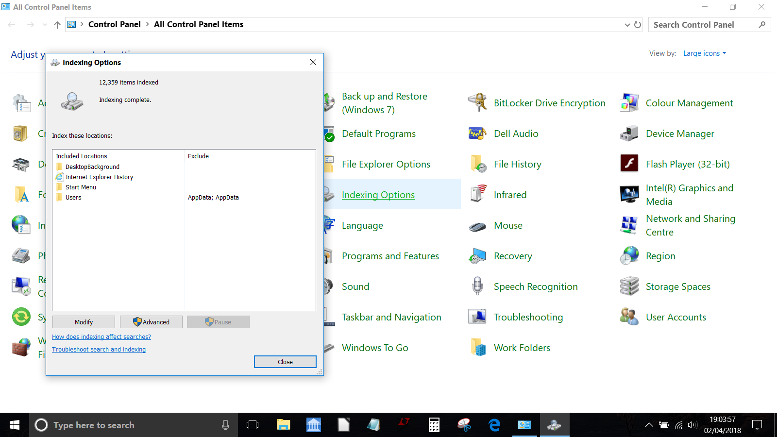

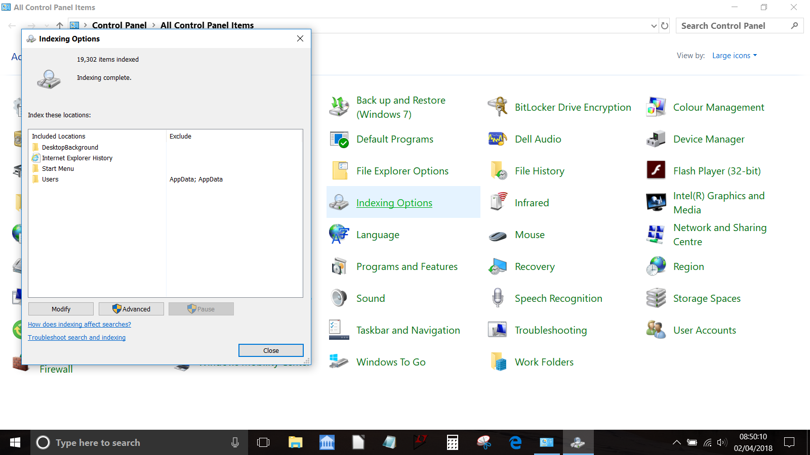

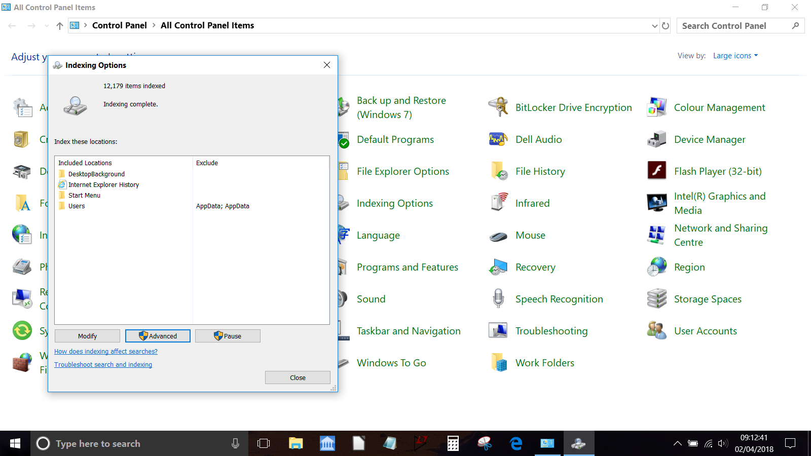

Is LTXVII causing an indexing problem ?...
I've noticed that my indexed files keeps growing and growing. This behaviour has been going on for months and I suspect LTXVII might be the culprit with its duplicate lib files appearing in documents and the program files.
I checked the number of indexed files this morning and it was over 19,000 in size. I get W10 to rebuild the index and sure enough, that total drops by over 7000. Now, through the course of the day the total is slowly increasing again. It will take a week or two (or three 😉) to get back to where it was. That number of 7000 or so seems to approximate to the number of items in the documents .lib folder, at least that is the number of items I see clock up if I copy the folder to a USB drive.
