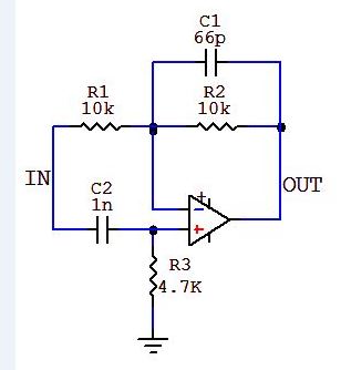

input impedance, output impedance and loading on opamp
Z=v/I...
but which node voltage and current to use to get input impedance, output impedance and loading on opamp?
when should I use a voltage source and when a current source (orientation?)
The component values of the above circuit essentially make it an inverting amplifier with a gain of -1 within most of the audio band.
You can use a current input source to simulate an I/V convertor but not with that basic configuration.
Just the way you have the opamp configured. Its an inverting amp at DC and low frequency. At higher frequency the 1nF starts to allow the non inverting input to alter the whole phase relationship of input vs output.
An I/V convertor would use a current source and that would feed directly into the non inverting input.

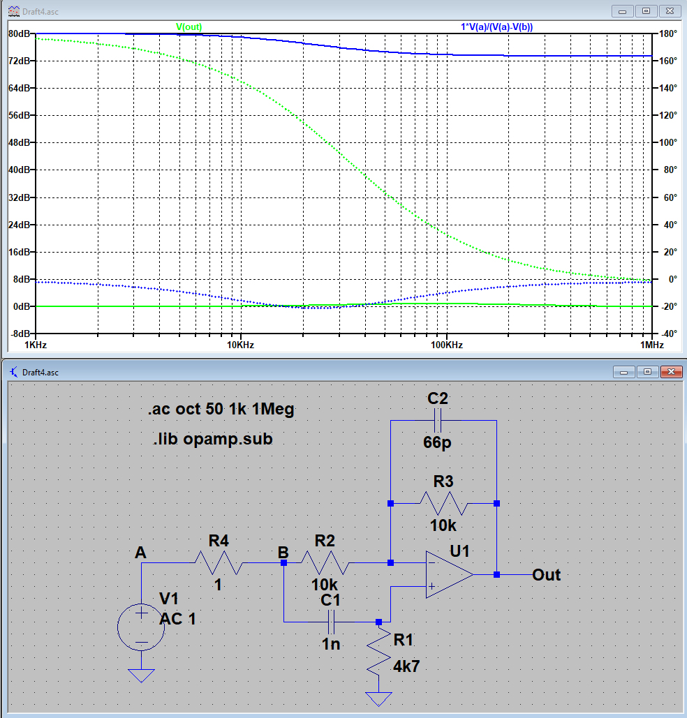

To find the input impedance, just place a small resistor in series with a voltage source.
Zin will be R4*(Va)/(V(a)-V(b)).
In this case the impedance starting with 80dB or 10K at 1 Khz and ending at 73.44dB or 4K7 at 1 Mhz.
Output impedance is depending on the OPA used and can be found in the manufacturers specs.

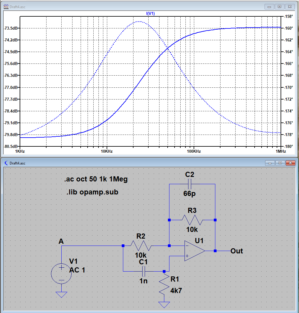

The other way that is even simpler, is to measure the current supplied by the voltage source, however this only works when the voltage is 1 Volt.
You have the same readings now, -80dB and -73.44dB, translating again into 10K and 4K7

Try it this way: replace the voltage source with a current source (flipped so the arrow points up) set to 1A AC , do an AC analysis and measure the voltage at the current source, then right click on the DB scale at the left of the graph and change it to logarithmic, you now get a reading directly in ohms.
the methods in posts 1096/7 give the same results for input impedance, however the results alter with the opamp used i.e. LT1028 13k2 at 100hz and 3k9 at 100k, whereas for a "universal opamp" I get 20k at 100hz and 3k9 at 100k.
