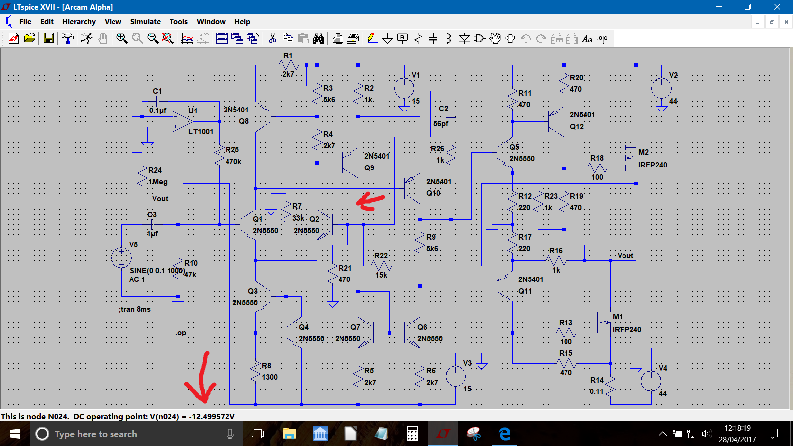

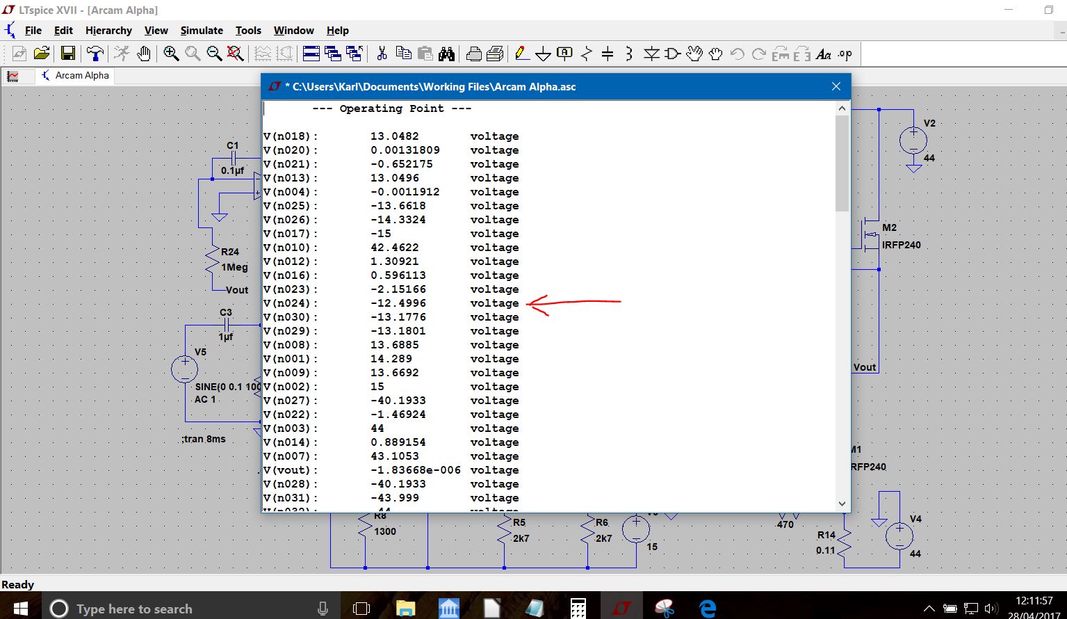

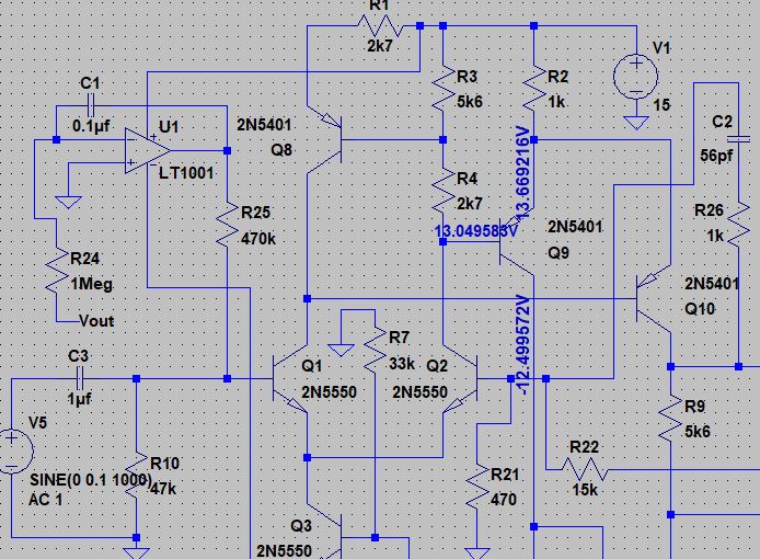

LT XVII anomaly
Would you call this a bug ? Its a simulated circuit of a commercial amp.

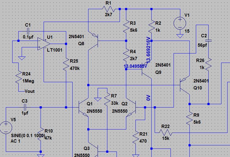

When I run a .op command and look at the voltages of Q9 they are correct. When I hover over the nodes they display correctly, but when I click to attach the voltage I always get a 0V for Q9 collector. If I then run the sim again, Q9 voltage repopulate correctly.
In fact it gets even weirder. If I run the sim from scratch again and this time attach the voltage to Q6 and Q7 base I see the correct voltage. Now click Q9 collector and the attached voltage is zero again but now it changes Q6/7 back to zero.
Odd.
(all default library models so should run straight off. Haven't tried LT IV as I haven't got it installed on my later PC's)

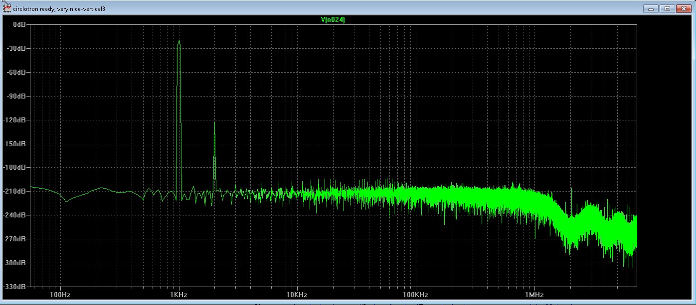

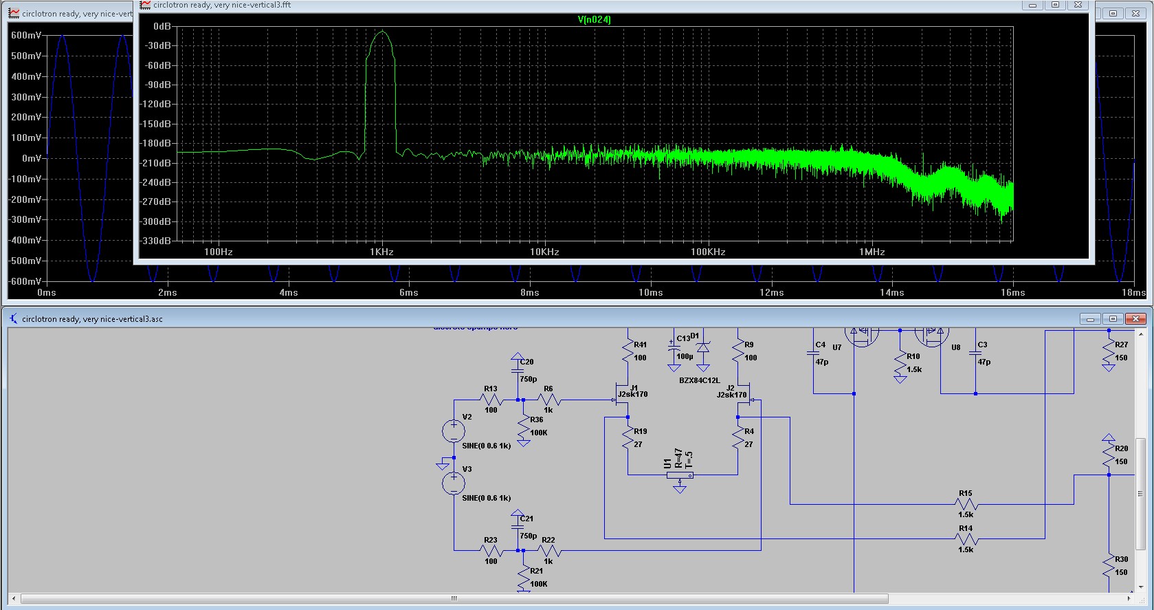

As you guys are real ltpspice specialists I have a question about distortion, I have discover that the voltage source has also high distortion, and so I do not now what amp has, is there something adjustable there? to get clean source.
thanks.

Taming LTSpice Distortion
You need to add two things:
1. the following statement as LTSPICE directive (without quotes)
".options plotwinsize 0"
2. Make sure that your max time-step is not more than 1/1000 of the period of the wave for which you measure distortion...e.g. for 1 kHz sine wave, make max timestep 1e-6
That should get you there.
Thanks I did try and it works, however the second harmonic stays higher then the rest on the voltagesource, but it is much better.

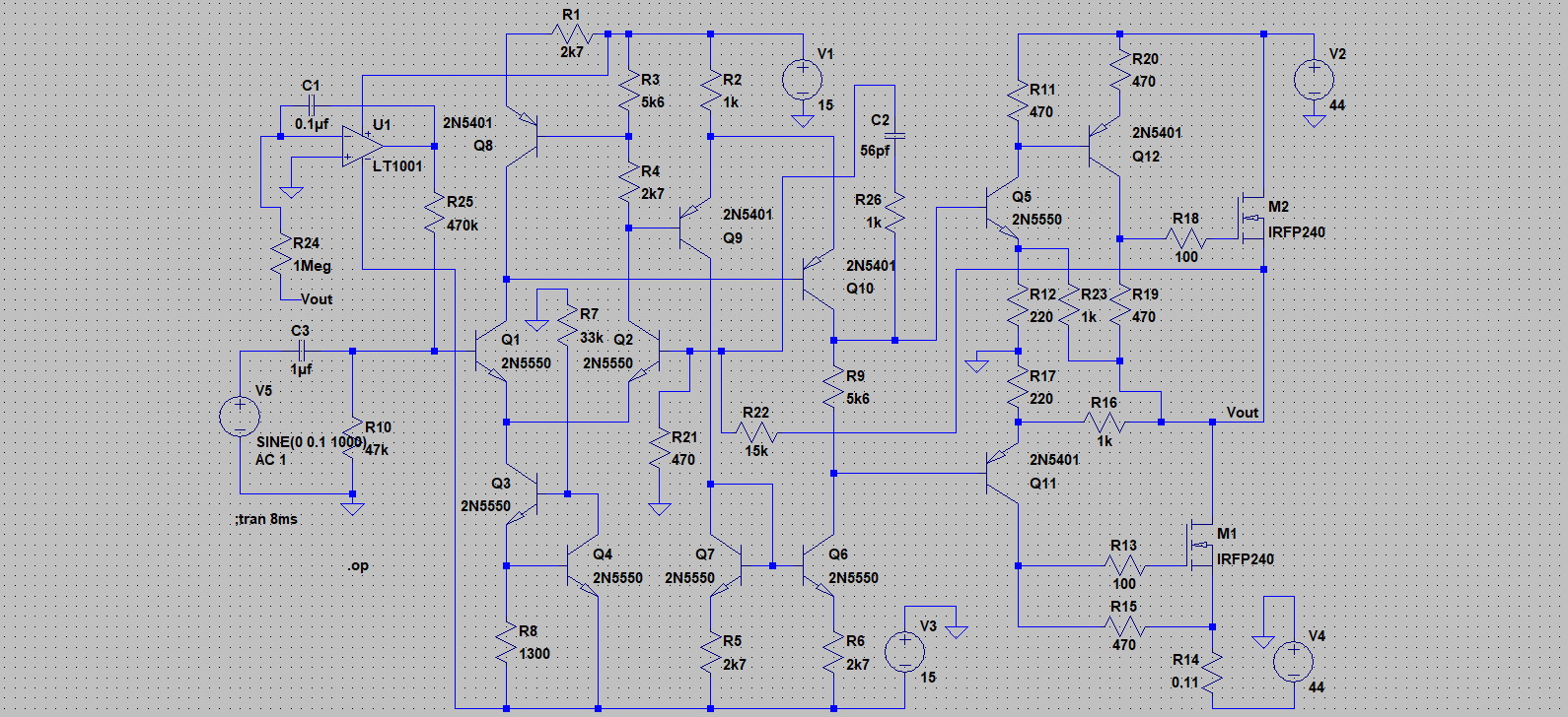

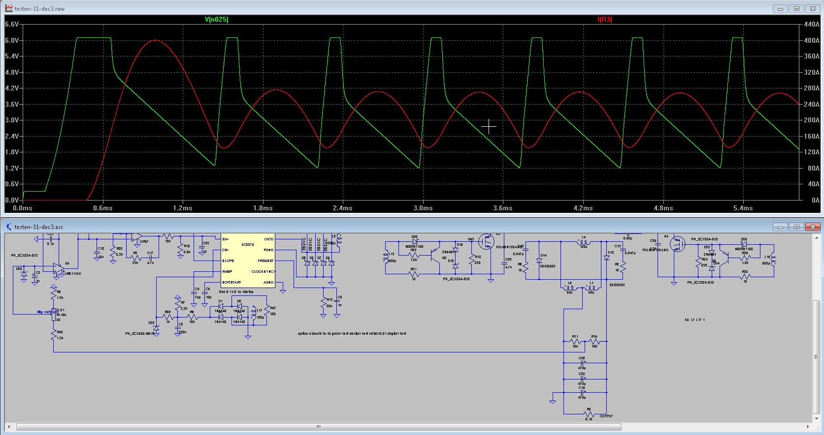

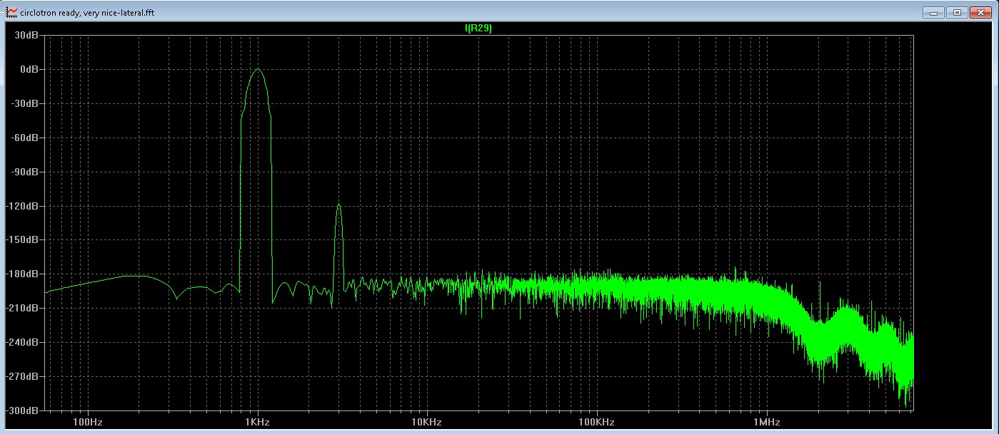

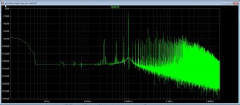

I get this when I do try that, it is however considerable better. picture two is a inverter smps, I do see the feedback give a changing line (red) while it needs constant voltage, I have for test drawn a existing voltage feedback who normally keep voltage straight, here in sim it do go up and down between 120 and 180 amps, it is shure becaue of the simulation, maybe it sees a kind of resonance in feedback line, while in realtime it works perfect giving a straight stable output voltage. Maybe LTspice is not suitable for smps simulation and do I need a other wone like tina or such.
Thanks for the help, so I learn also the tricks from ltspice.
regards

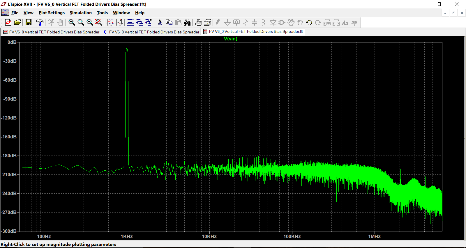

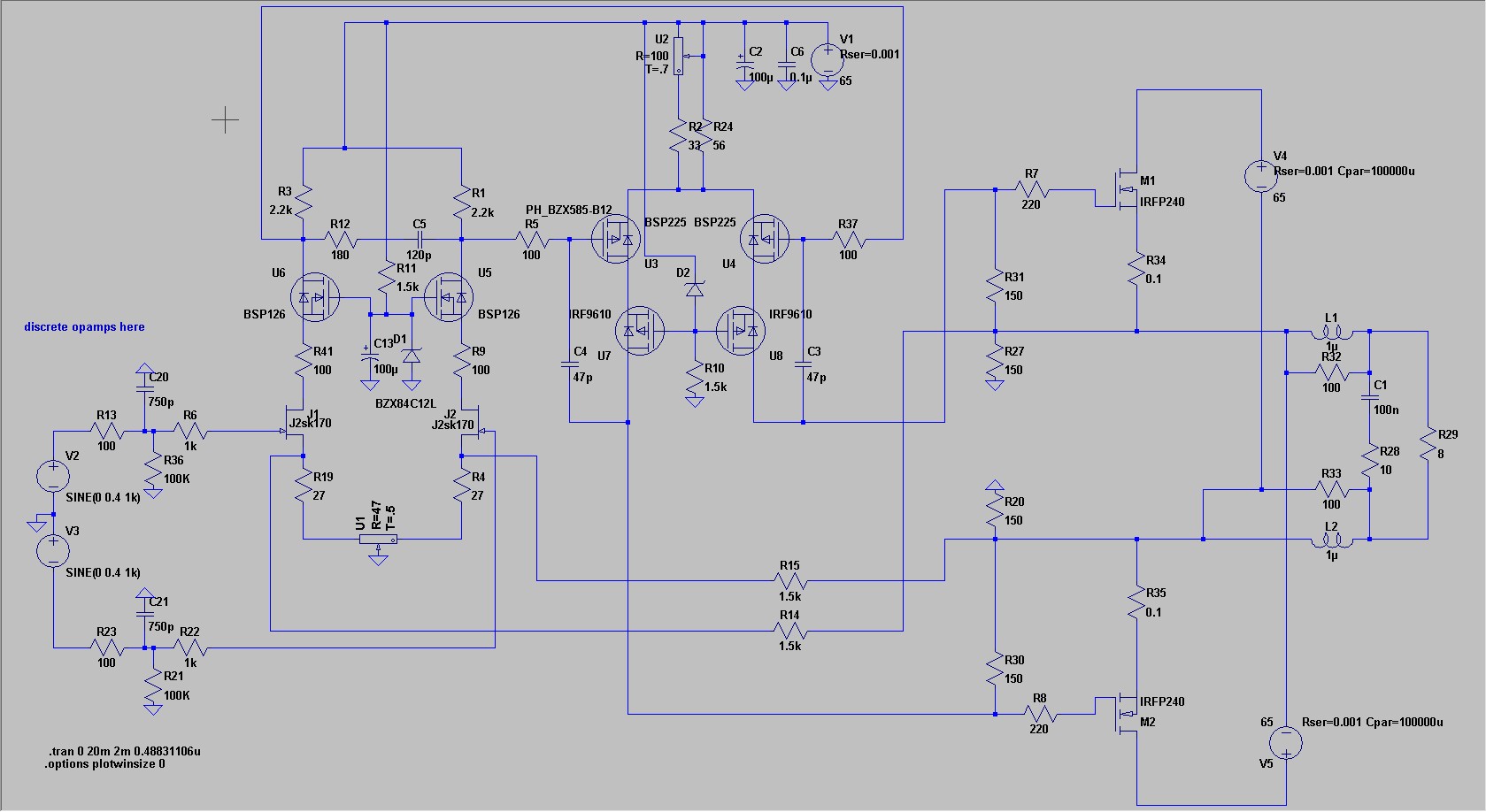

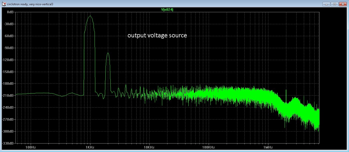

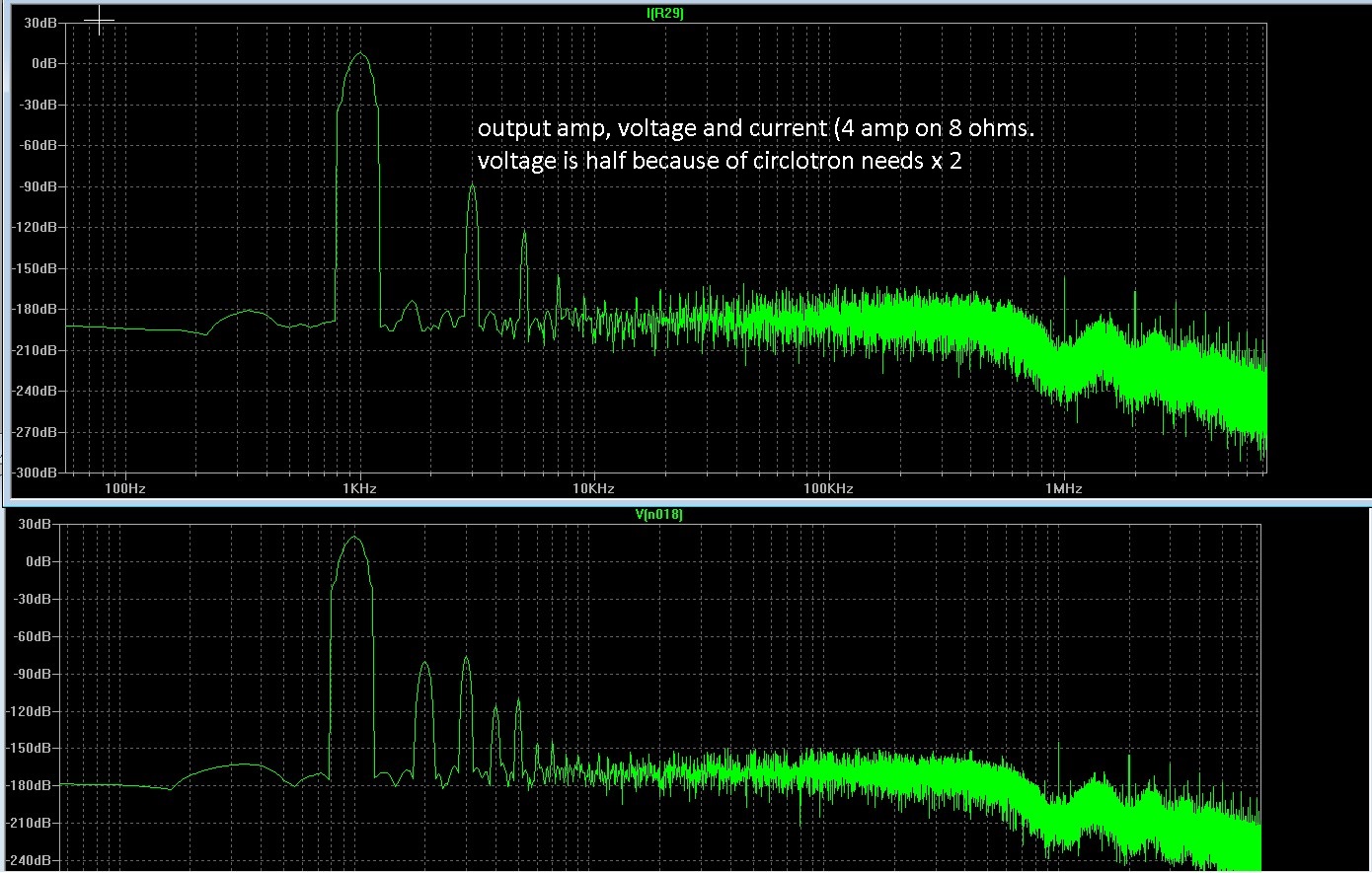

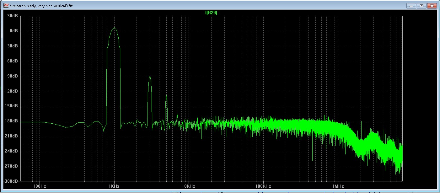

I have found the reason why, also the setup keantoken give did help a lot, I have put a extra voltage source and put the middle on ground to make a diff signal.
That did the trick so it was serie impedance problem, again something learned thanks.
pictures are input and output amp, last picture is output with 1.2 amps in the load, the other where higher ouput current and more distortion, however only uneven ones because circlotron cancels even harmonics..
Now I can go on, and watch out what to do with that LTspice. Distortion for IRFP240 or 2SK1058 did not differ for each other much.

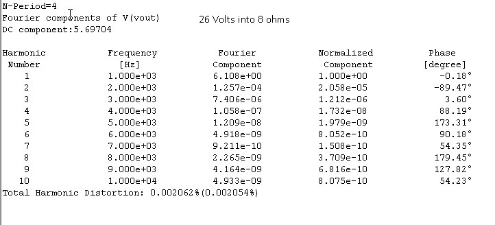

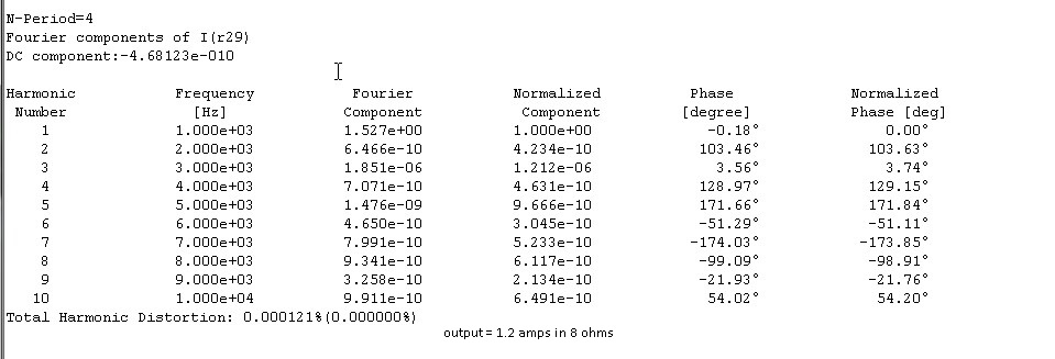

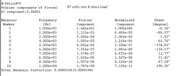

I have seen somewhere that I can actually measure distortion in text form,? LTspice do print it, how?.

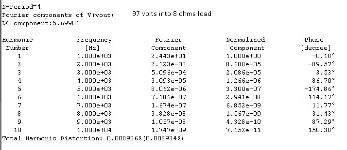

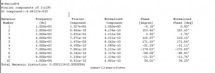

As your fundamental is 1kHz you need to add the following .op command
.four 1khz 10 4 v(vout)
That will show the distortion (first 10 harmonics) from 1kHz upward. You need to label the node of interest on the circuit as vout
Edit... you could also use .four 1khz 10 4 i(R29) for your circuit.
Right click the circuit after running the simulation and look at the spice error log for the results.

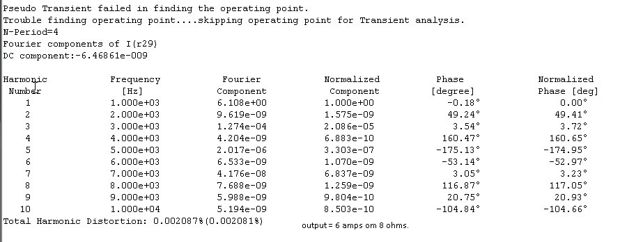

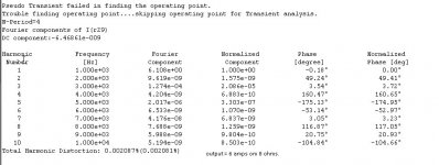

Oke thanks.
I do use R29 because I have balanced output, but can also try Vout for single ended output info.
Did some sims, Vout is unbalanced so no harmonics are canceld out, with the R29 output it is balanced and so harmonics are quite low for almost full output of 6 amps
in 8 ohms.
info on pics, I put them also on mine thread.
