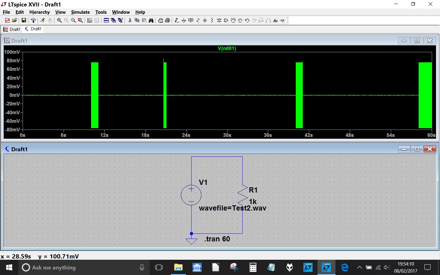

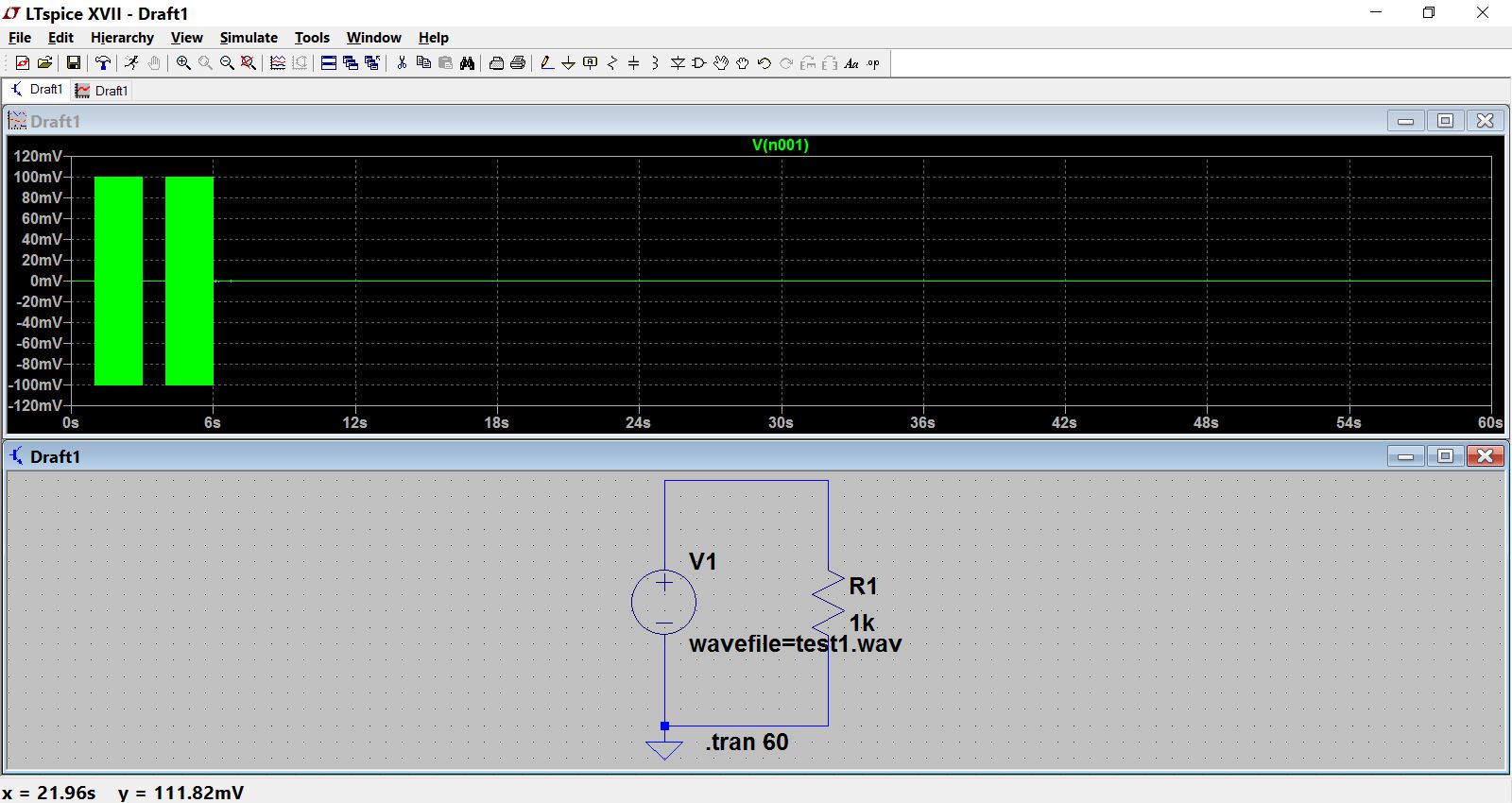

A bit more testing with this and it seems also related to file size. A short 10 second file does let me fade and add silence OK. A 60 second one doesn't.
Attached is the .asc file with a 60 second .tran command.
Test1.wav and image of that running attached. This works instantly. This was a 10 second .wav file.

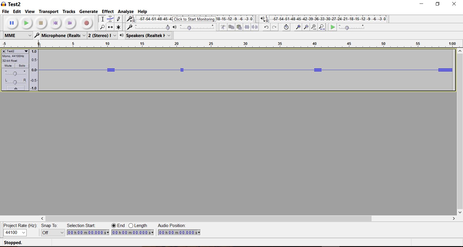

Test2.mp3 is an MP3 that can be imported into Audacity (or other program) and resaved as a .wav This is one that will not run. Image attached of how it looks. The original created .wav and the .wav to MP3 and back to .wav both behave the same.

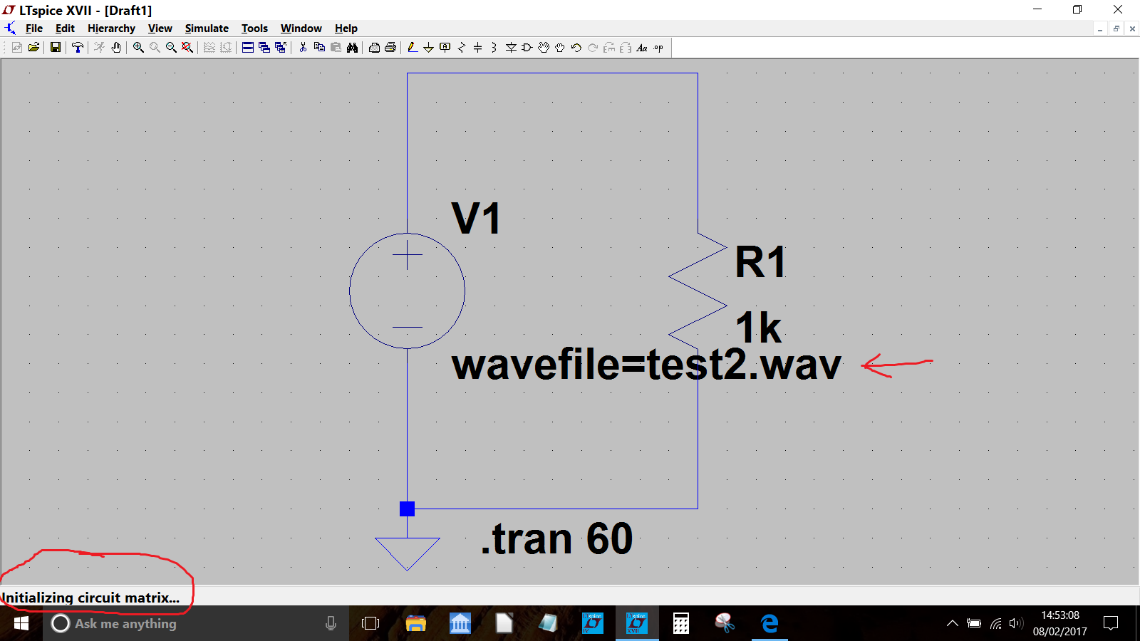

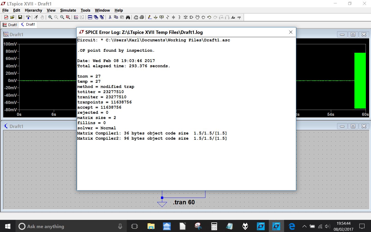

I cut the time down to .tran 15. It then says, "Initializing Circuit Matrix".
This lasts for around 3 minutes, and then it ran. I wonder...if you do this with 60 seconds, does it take 12 minutes to get ready to run a 60 second sim?

So it worked coming in at a shade under 300 seconds. This was on a 10yr old laptop (AMD64 Turion +2Gb ) running W10.
My Dell with an SSD sounded like it was going to take off when I tried this yesterday. Never before heard the fan ramp up to the speed that it did.

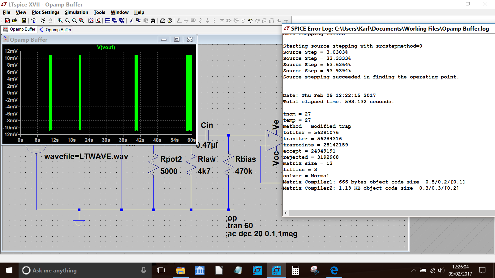

I tried this on the Dell feeding a more complex circuit, and it took 600 seconds to run. Strange to say the fan activity (which I know is normal when doing something intense) comes back down to more reasonable levels after a minute or two.

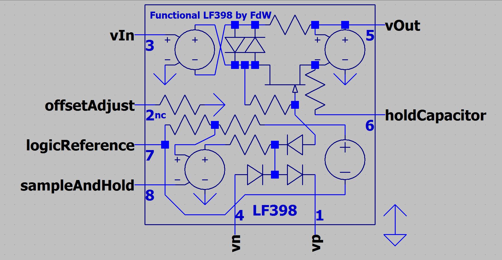

This is a functional LF198/LF298/LF398 model (because it functions for me), if any one is in need for a functioning 'Sample And Hold' he could start by giving this a try.

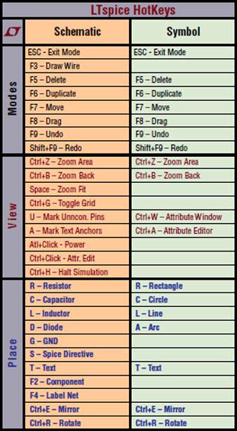

I found this image in the net, I'm not a heavy shortcut key user, hope anyone may find it useful. Not sure though if it also works with the later LT17 version.
